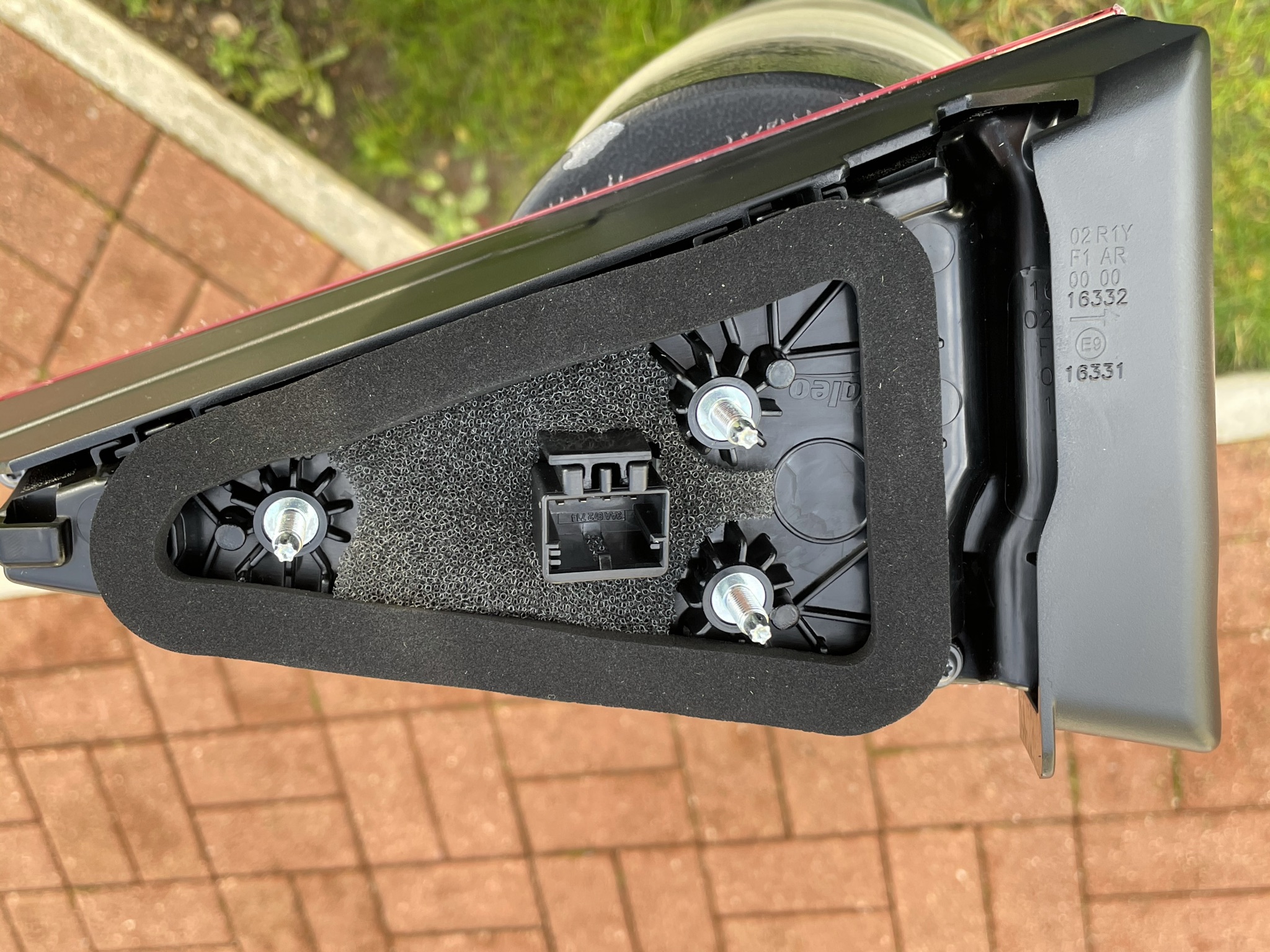

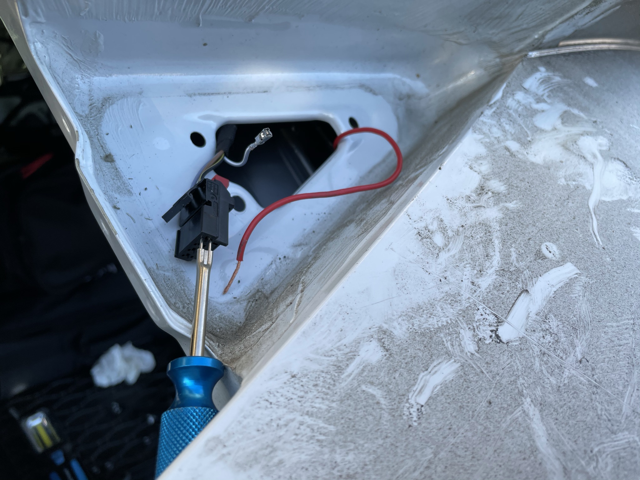

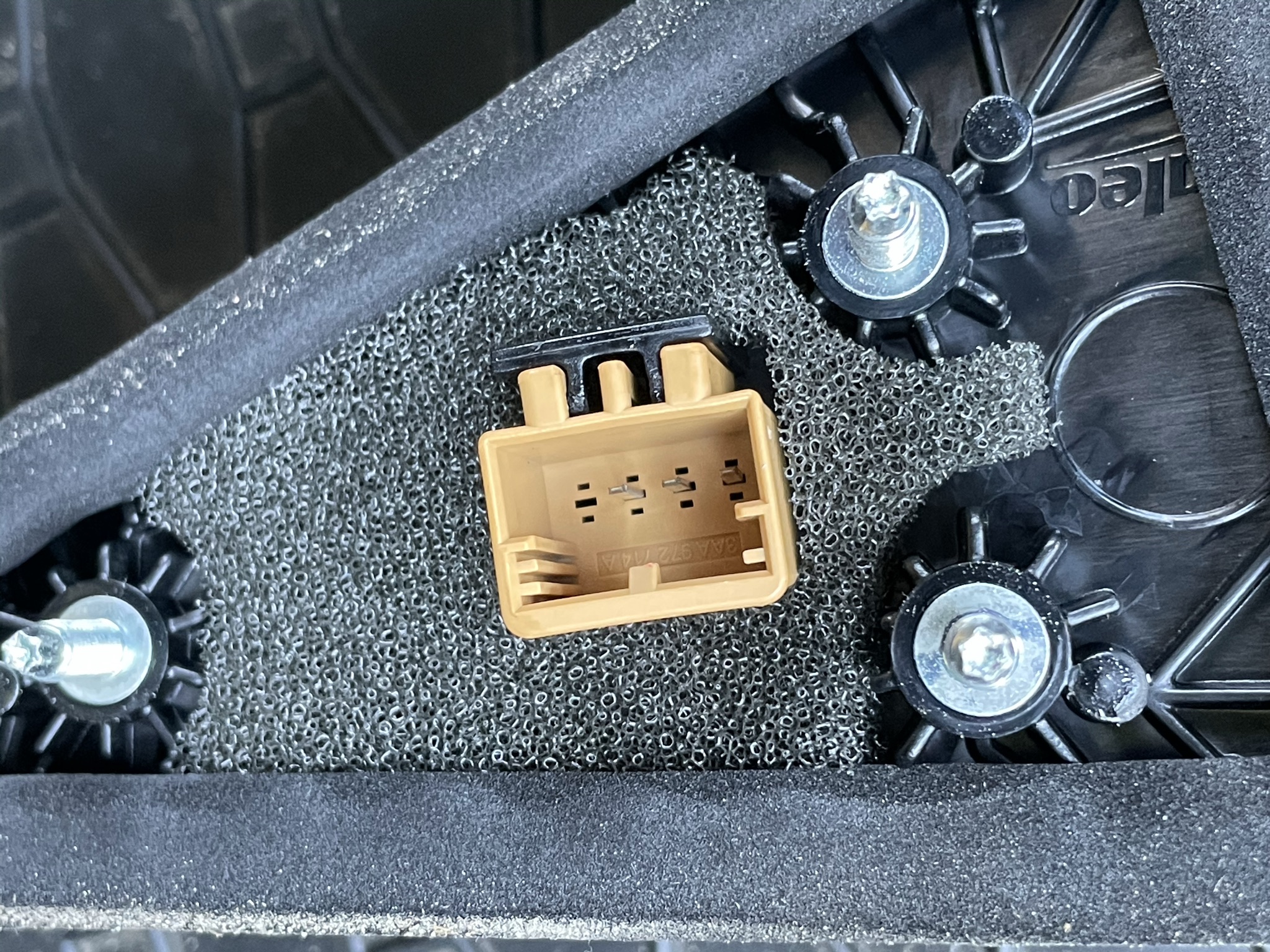

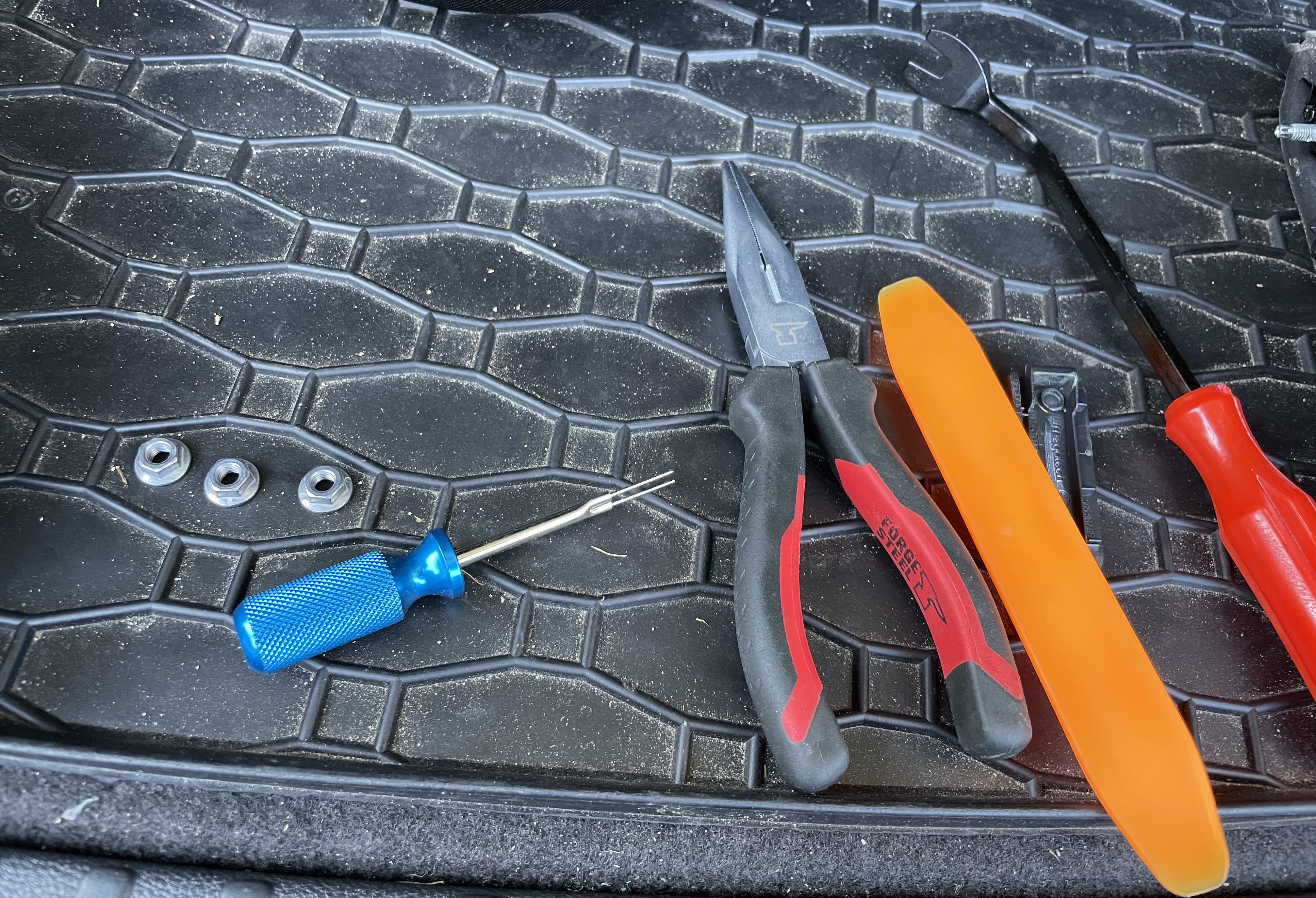

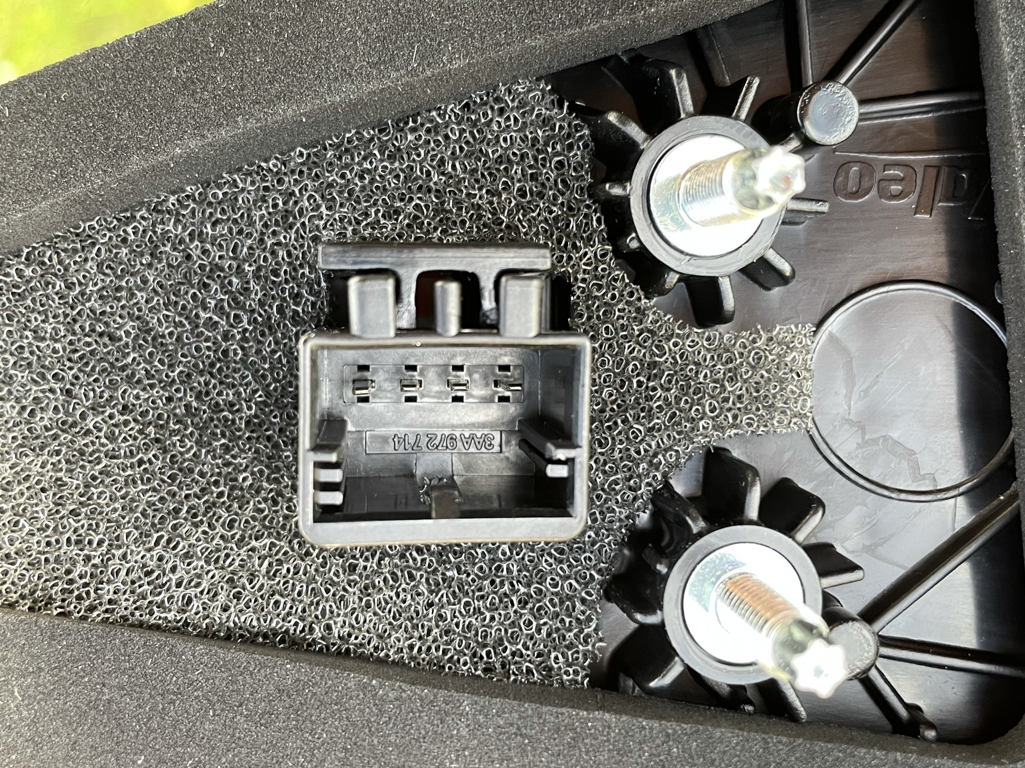

Solved! - A good friend helped me :)
1. Bought a new fog light at skoda-parts.com (£147).
2. Bought a repair wire on ebay (£7)

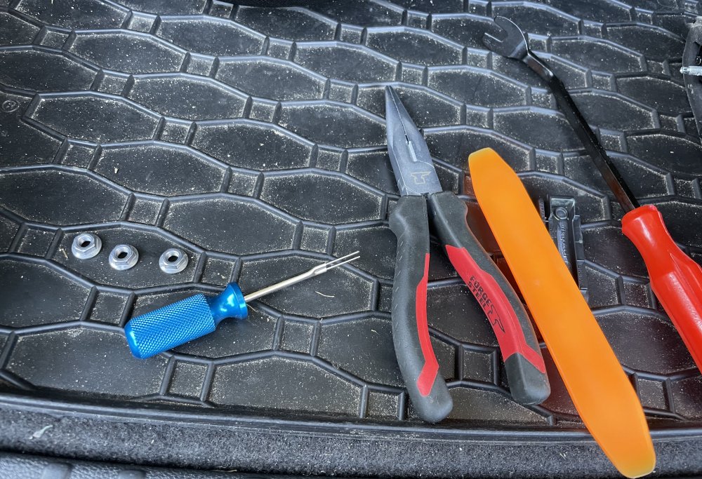

3. Solded the wire onto wire of the working fog light and connected to the new light (the blue tool a must to get the wires out of the plug.
4. Plug had to be slightly modified.
5. Now fog light on both sides - without coding.
