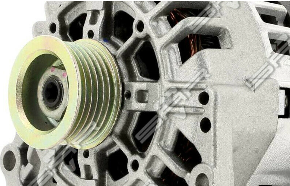

Have a look at the inside of the pulley of the alternator, I think it'll look like this with just a simple nut in there, that's the non-clutch version:

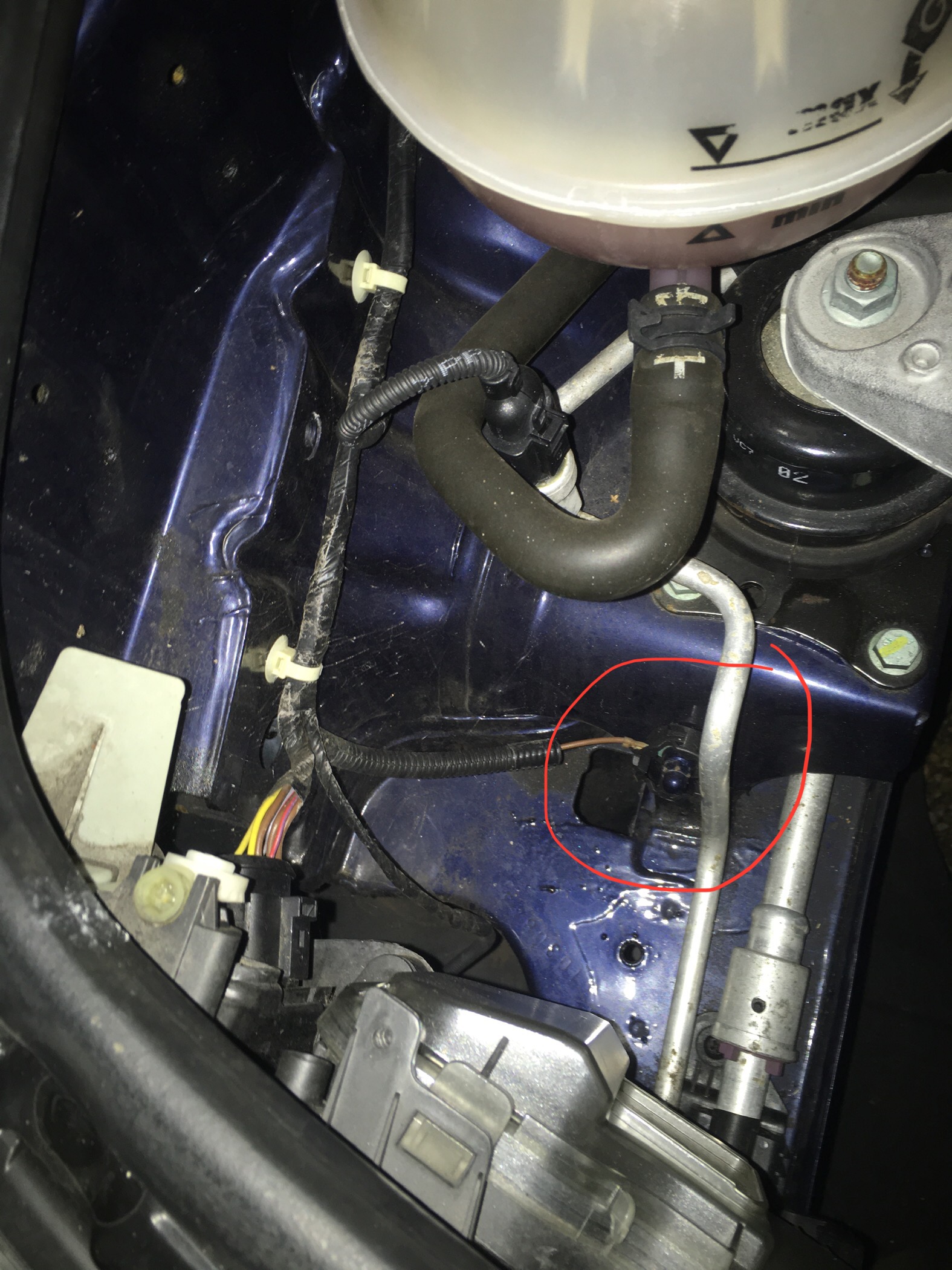

All of the earth wires looked clean, apart from one at the front left of the motor / bonnet which has gone green (like it’s oxidised). I’ve attached a photo to show whereabouts it is.

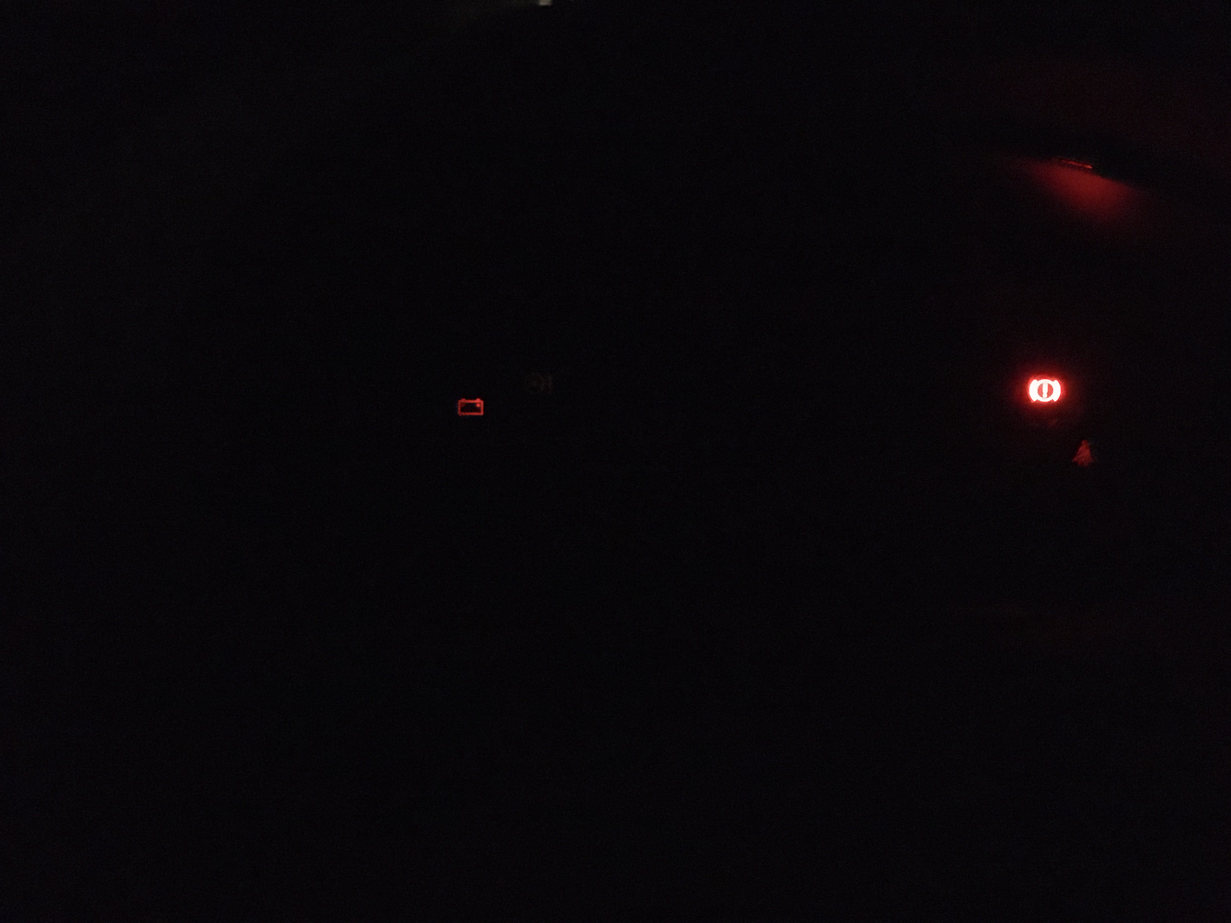

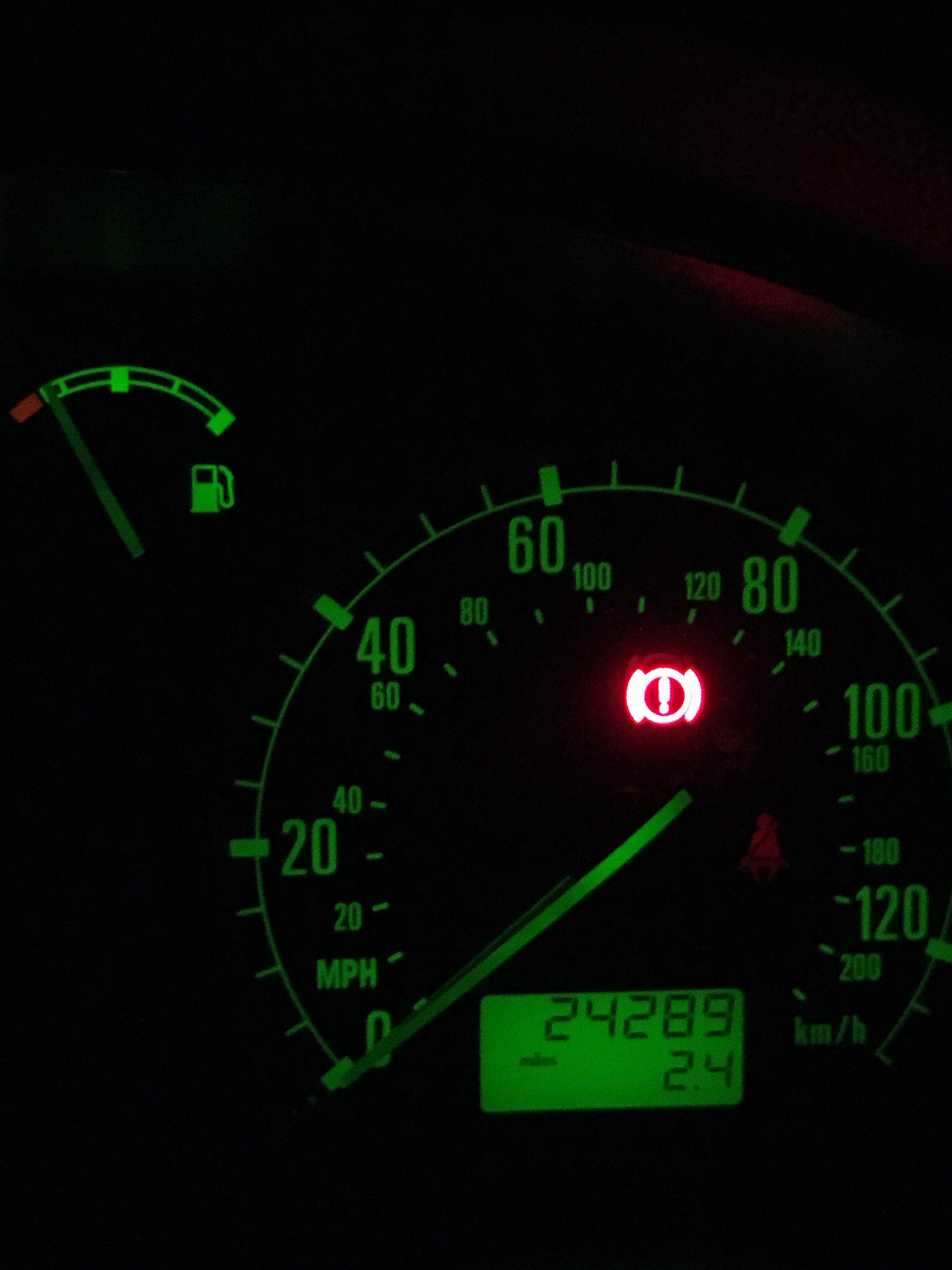

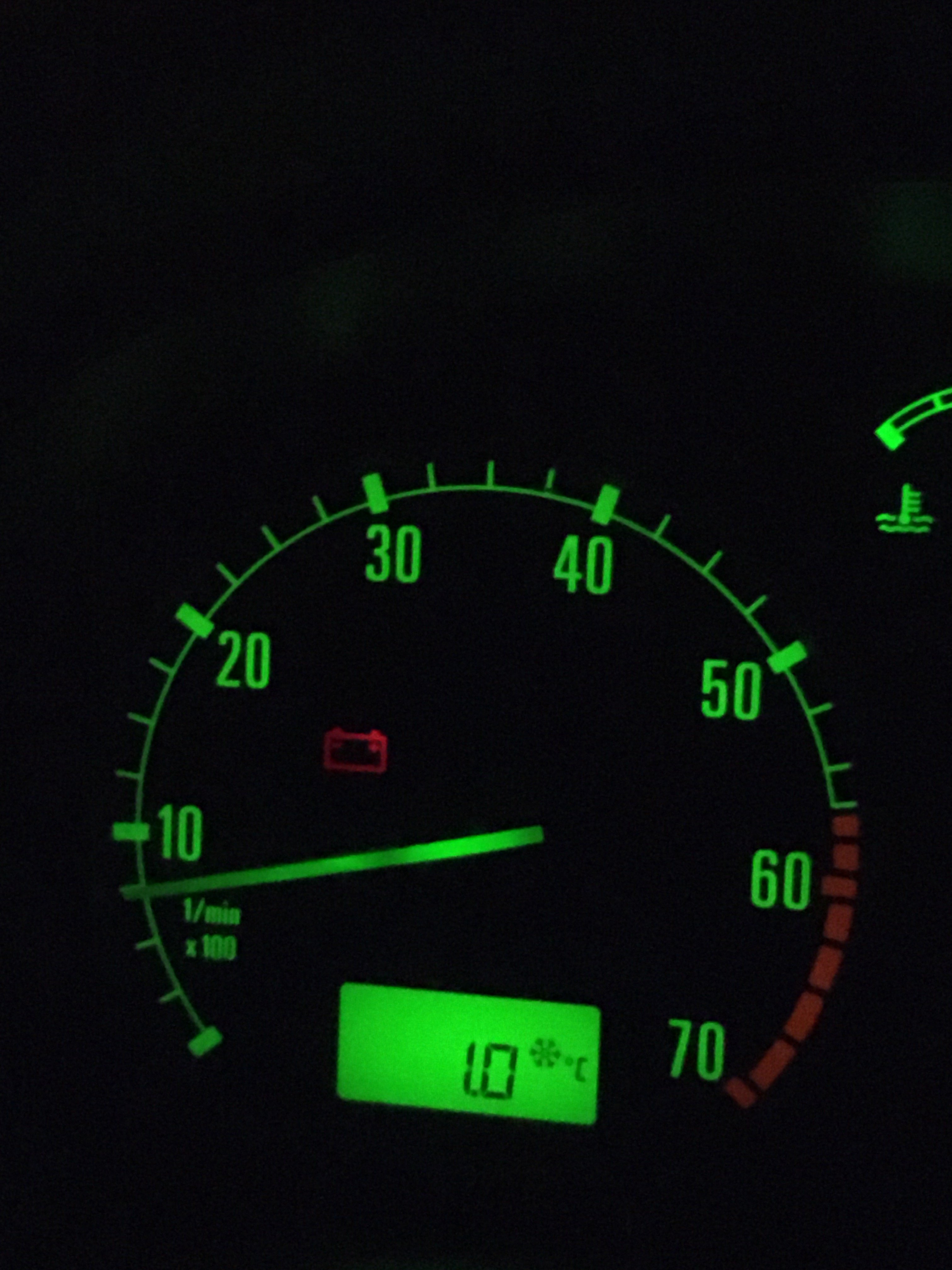

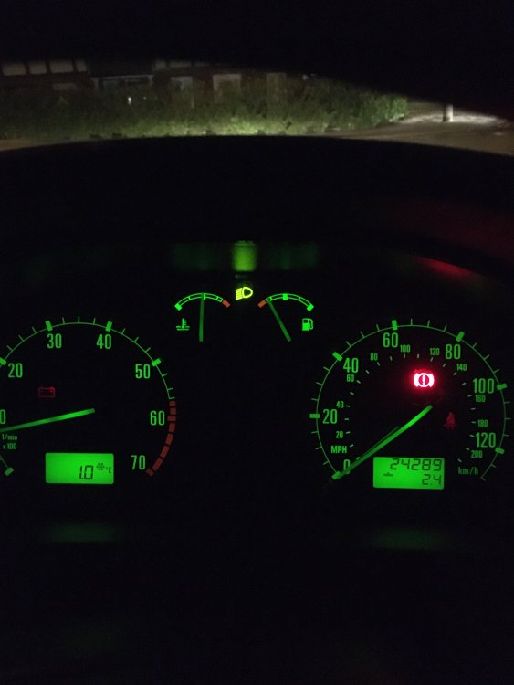

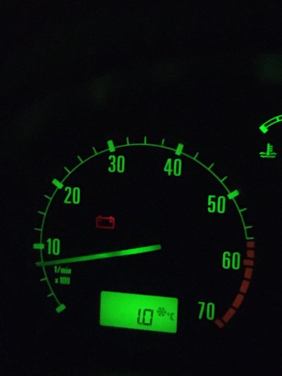

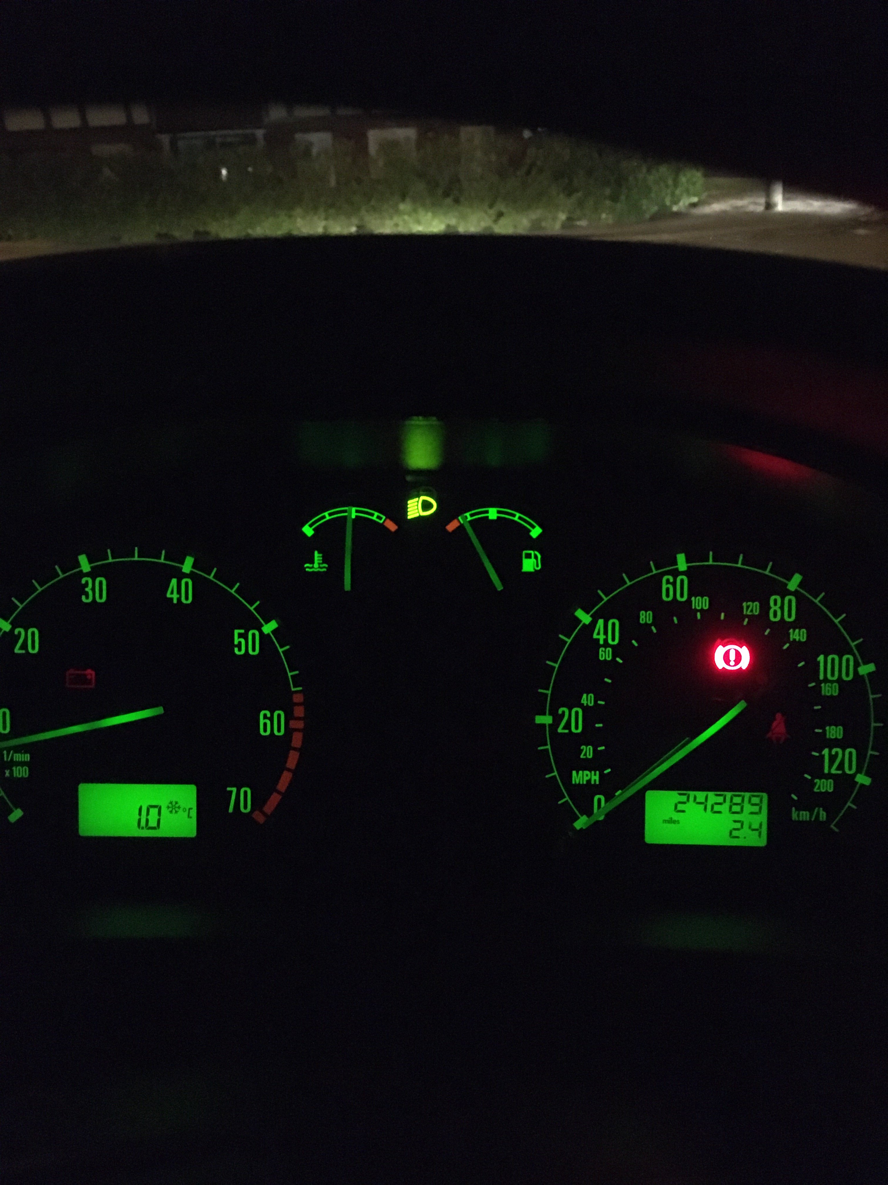

I’ve been keeping an eye on the dashboard for the past few days, and the battery light stays on the constantly. The seatbelt & air bag lights are also on, but fainter. They stay on when the cars off, when the keys in the igntition, and when the car is running. I’ve attached photos, with different lights on to show how bright/faint they are.
Any idea what might be causing that to happen? The only way I got them to turn off was by removing the instrument cluster fuse.
It's very easy to remove the instrument cluster. I would try taking the two plugs and and off a few times and then spraying the cluster pins and plugs with contact cleaner spray. From my own experience I have found the cluster plug connections to be a bit fussy. There's also the possiblity of dry solder joints inside the cluster but I would try the plugs first. Why the battery is draining I don't know, though.
I would clean that earth up too.
