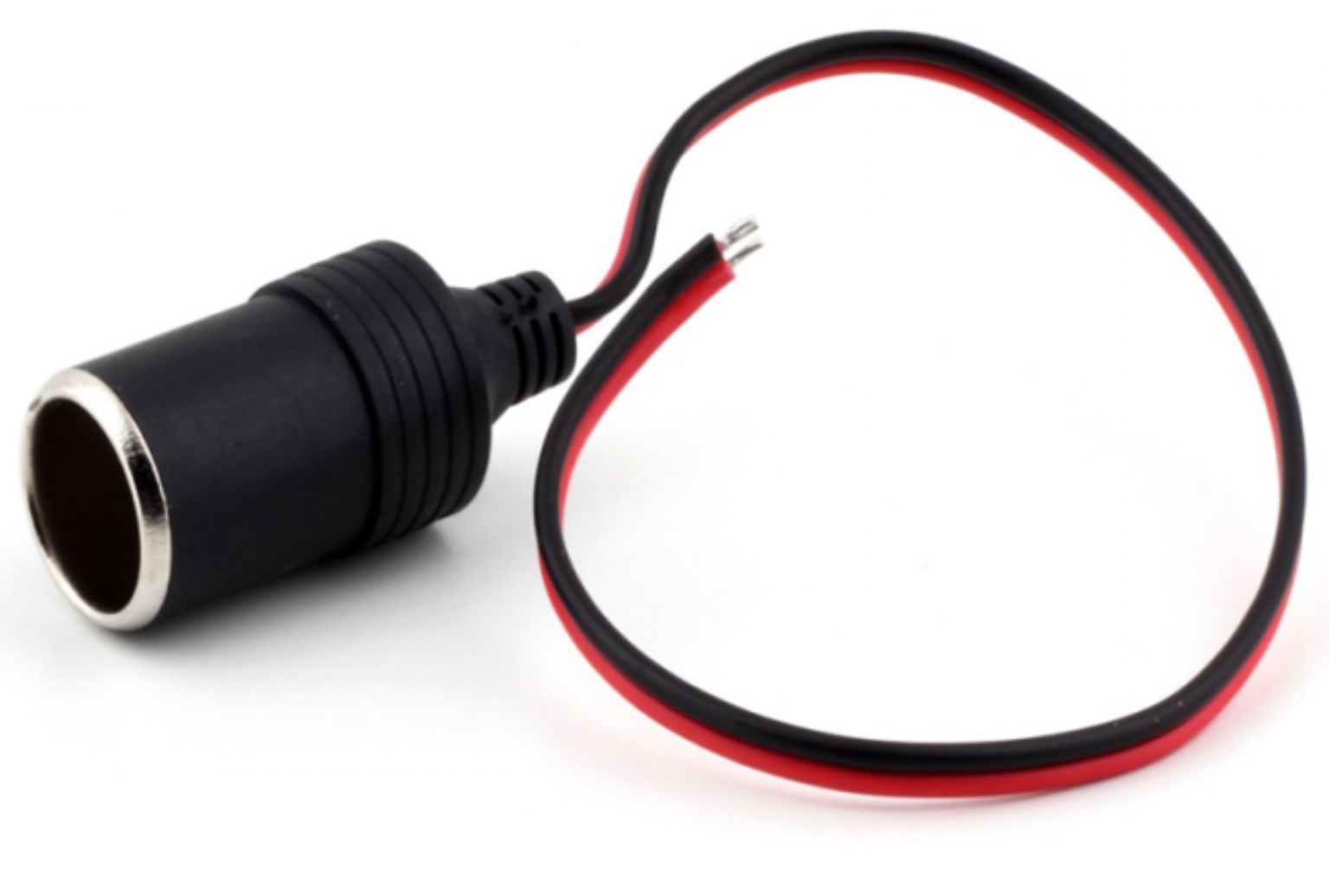

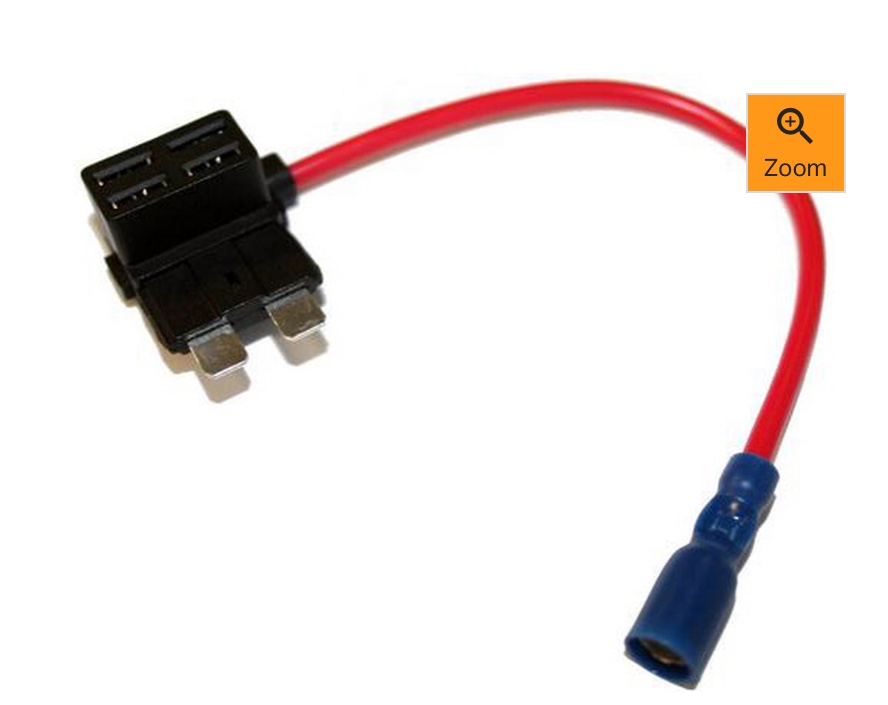

Just get a piggy back fuse and a cable mounted socket then you can wire it into one of the fuses behind the glove box. That’s what I did and it works as you describe when the ignition is on it’s powered and goes off when ignition is switched off.

My dashcam (must get it installed in the new car) came with a cigarette lighter plug on it, I got a matching socket from, the now defunct, Maplin and it fits in the space above the fuse box near the glovebox with a feed from an used outlet in the fusebox.
As above all you need is a piggyback fuse plugged into an ignition controlled circuit and a cigarette lighter socket.
Kenny’s photo above is exactly the setup I have though I know you can get a hardwire kit for the nextbase models that replaces the cigarette lighter shaped adapter with flying leads that go straight to a piggy back fuse as that’s what I installed in my wife’s car. It’s expensive in hellfrauds but I think we got it from Amazon during one of their sales so it made sense at the time.

I purchased a generic hardwire kit recommended by the dashcam supplier. Managed to plug it into a spare fuse socket , which coincidentally runs on ACC power and not permanently on. Now I have a hwk with battery protection which only runs on ACC power. Go figure! 😜
