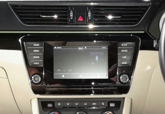

My friend got a new 2016 Superb with head unit P/N 5Q0-035-840-A. He got the small screen (I think it's 5.8") with the huge bezels.
It has AppConnect so I assume it's MIB2.
Coming from a Golf, I know the screen be replaced with the newer screens plug and play, but not sure about how it works with Skodas.
If anyone can confirm it'd be awesome.
This is his screen:
It’s the 6.5 inch screen there. You can plug and play the PFL or FL 8 inch screens.
