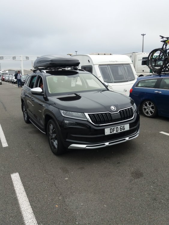

Mine is 210cm total based on Thule aerobars (+6cm) as in picture above with a Halfords Exodus roofbox (+36cm).
