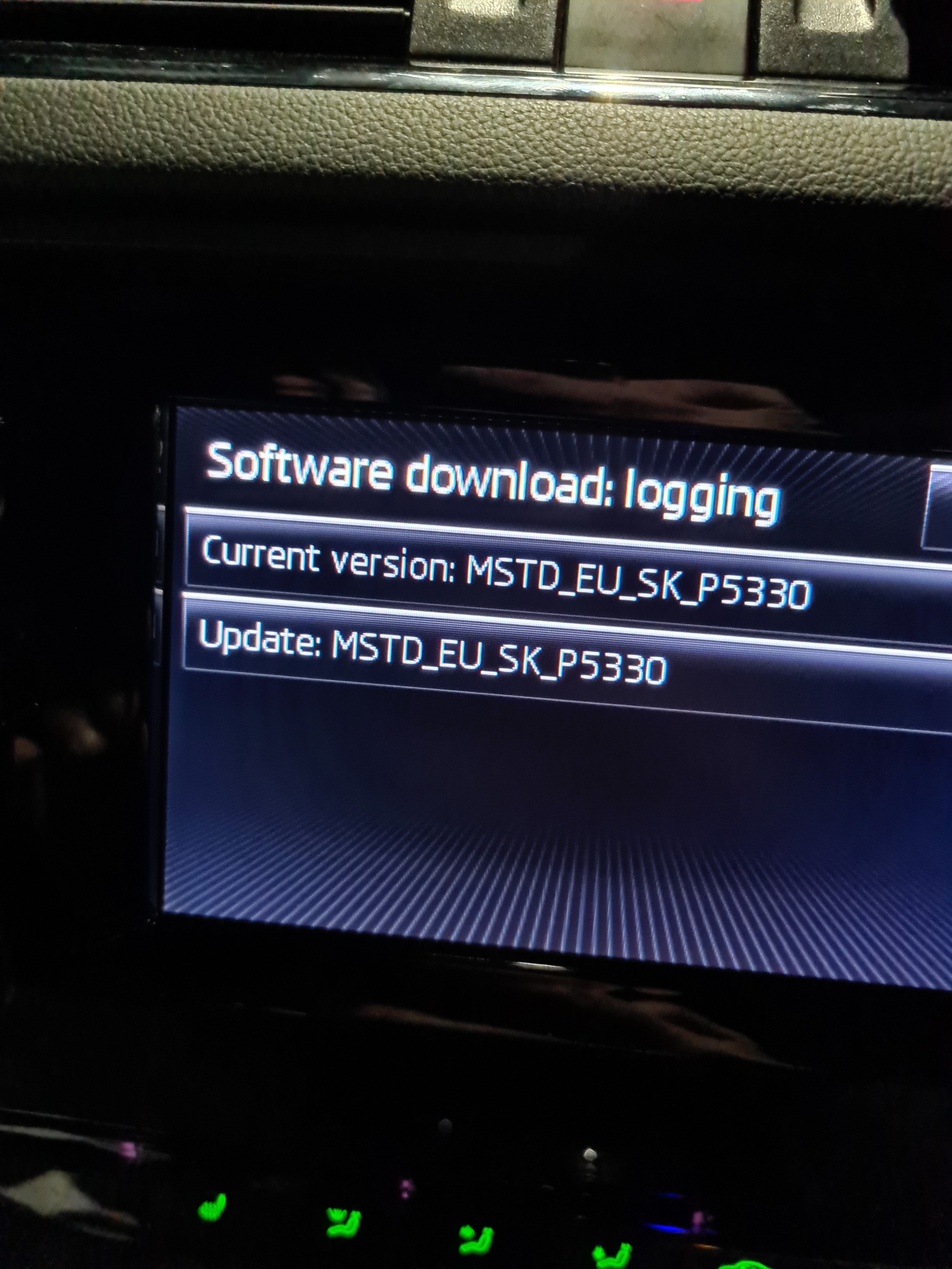

It's usually the screen at fault rather than the entire system and that software version in the image is that of the control module in the glovebox.

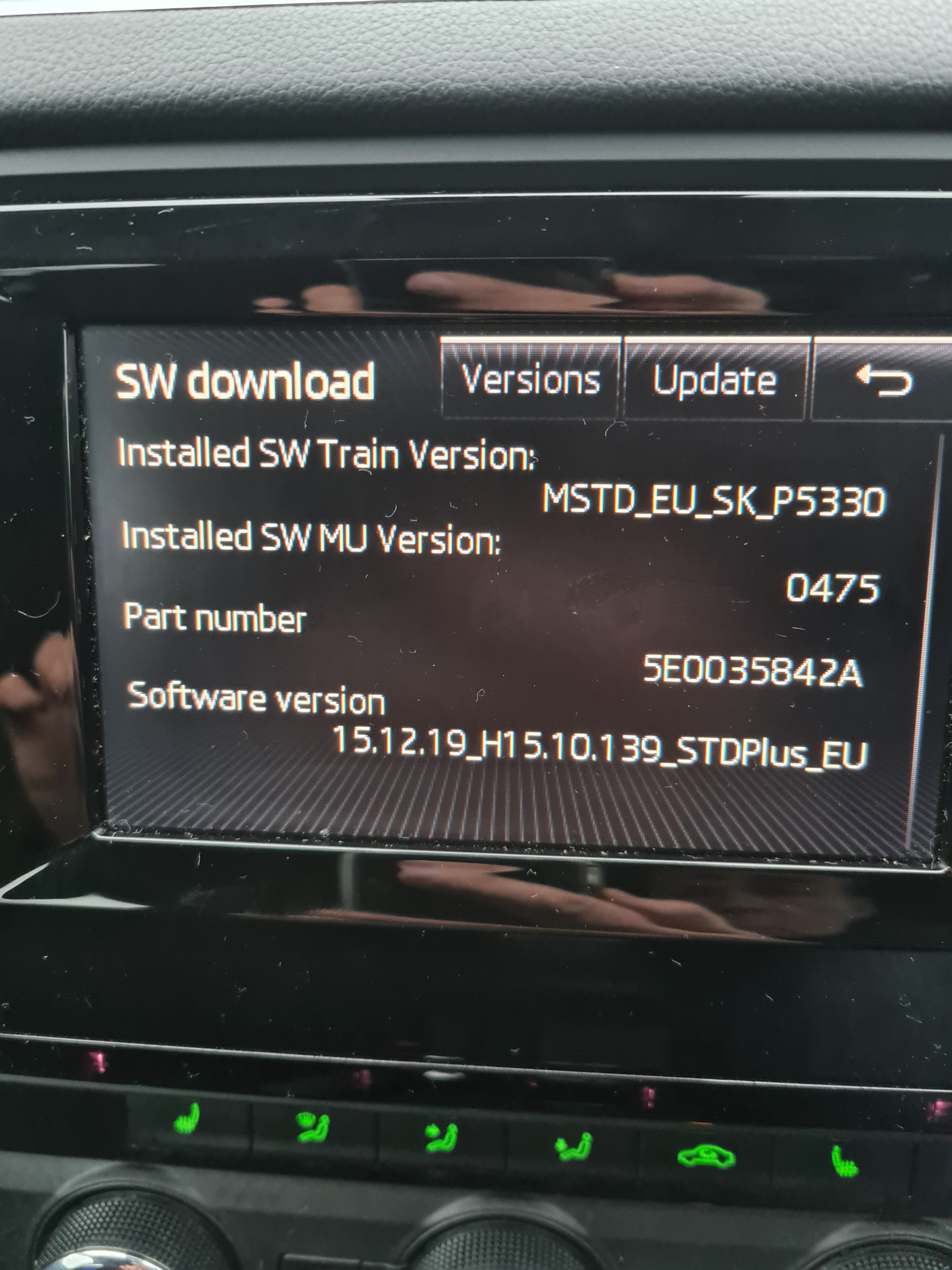

The screen part number should be 5E0919605B. It acts as a slave unit to the main controller in the glove box. What do you see when you press "Versions"? Is there any mention of "ABT"?
This any good?
Does it show you anything if you click on either of those options?
i think the top photo was what you see if you select any of those tabs in that picture. Not with car now as gone work. So assuming its not the latest version then how do i get hold of a copy to update the unit. Must be said that it does only seem to play up mostly when the cars screen is cold and been standing overnight as it seems to sort itself out once i done a few miles with the heater on.
