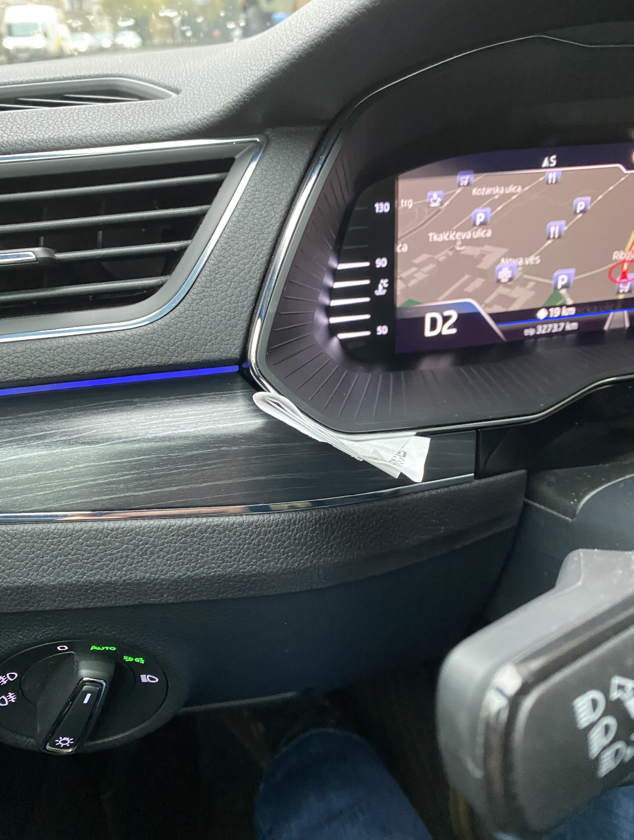

Hi guys, I have a ”new” superb premium combi and ofc a rattle coming from the dash.
It's making me crazy mad. The skoda retailer sad that they don't know what to do.
Could you please help me?
I have noticed a small gap between the virtual cockpit and the dashboard and I think that is the problem.
I could put a 3/4 sheet of Papers in the gap.
Help guys if you can!!!
Yep. Welcome to Skoda superb ownership. As quick as I can fix dash rattles, new ones appear. That trim should be on with speed clips. Remove it and pad behind it, then replace the trim again.

I think here is the problem?there is a Gap between virtual screen and dash trim.
It appears every time after around 20min of driving when car is heated.
