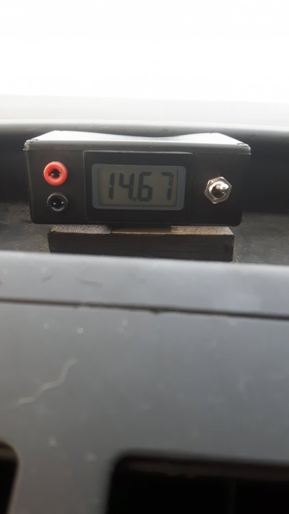

Here's my 'voltage across battery posts' at first start at around 0°C, conventional alt, and battery.  It reduces as the engine bay warms down to around 14.3V.

5 hours ago, Wino said:
The magnitude of the voltage peaks is interesting to me, minimally higher than a conventional alternator (at cold temps anyway). I have a feeling if I fire up my car shortly, at frosty degrees C I'll see similar initially.
Seems to contradict the notion that start-stop batteries need a higher charging voltage than regular batts. In fact, almost all the time, they have a much lower one.
I think the charging system is probably based mainly on controlling current going into and out of the battery using feedback from the current sensor mounted on the negative terminal. It can track charge (coulomb counting) and so be able to maintain/increase/decrease the batteries SOC, whatever the battery management system demands at any moment
EFB and AGM batteries have considerably greater charge acceptance ability than old conventional lead acid batteries so you won't necessarily see large increases in voltages with charge current although its likely the alternator can allow the voltage to rise higher if demanded by the battery management to maintain current flow e.g. when the battery is older and/or knackered
