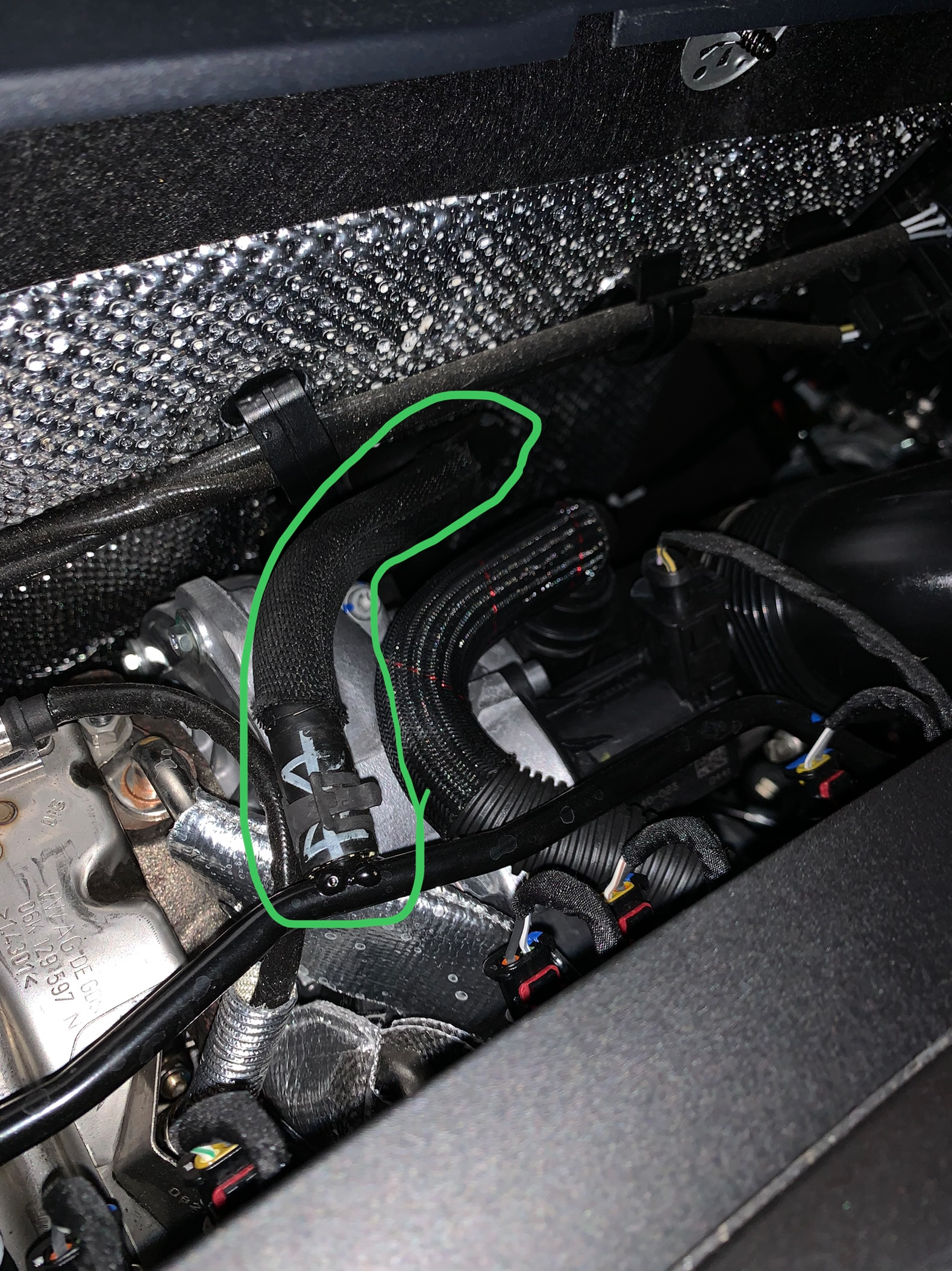

It's not coming from the turbo, it's something to do with this rubber hose where it meats a metallic pipe:
If you manipulate it in a certain way the noise stops:
Not sure what to make of it lol. It's definitely coolant passing through that hose, as following the metal pipe leads to a rubber hose that goes into the coolant reservoir.
Edited by Guest
It's cooling the turbo bearings down so oil doesn't sludge in them.
Secondary coolant pump is my guess, these pumps can run for some time after the engine has been switched off.
Yeah I know its that, the noise from that particular hose doesn't sound quite right is what I'm getting at
