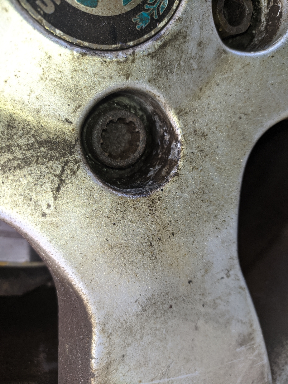

Can anybody tell me the socket I need for my wheel security bolt?
As you know you need the exact code and even the dealer doesn't know this0, it can only be worked out via a picture .
Would you be able to tell which socket I need from this picture?

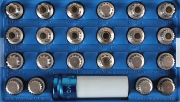

Did the dealership not have a set of them and someone try to see which it needed?
A google of the different ones that will show might make it easy for you to identify the correct one.
Hopefully someone has the diagram with the Letter Code showing.

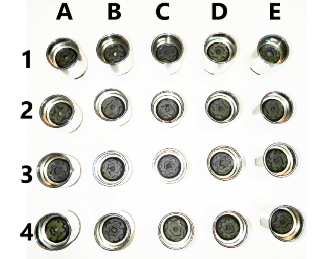

Thanks, looks like it no. 54. I'm going to replace these security bolts with regular bolts, I'm sure a wheel thief can easily get their hands on a set of locking nuts like the picture you posted.
no. 54 is a 9pt pointed star. yours is a 9pt flat topped. it isnt in those pics...
Are you sure those pics are right because this eBay seller is selling what I think I need and it looks different to the pics you posted?
I think the 54 in the pic is in the slot  to it's right it's 9pts.

well it was e-root posted the pics, not me but they look like a couple of the standard sets.
but that ebay link does appear correct yep
