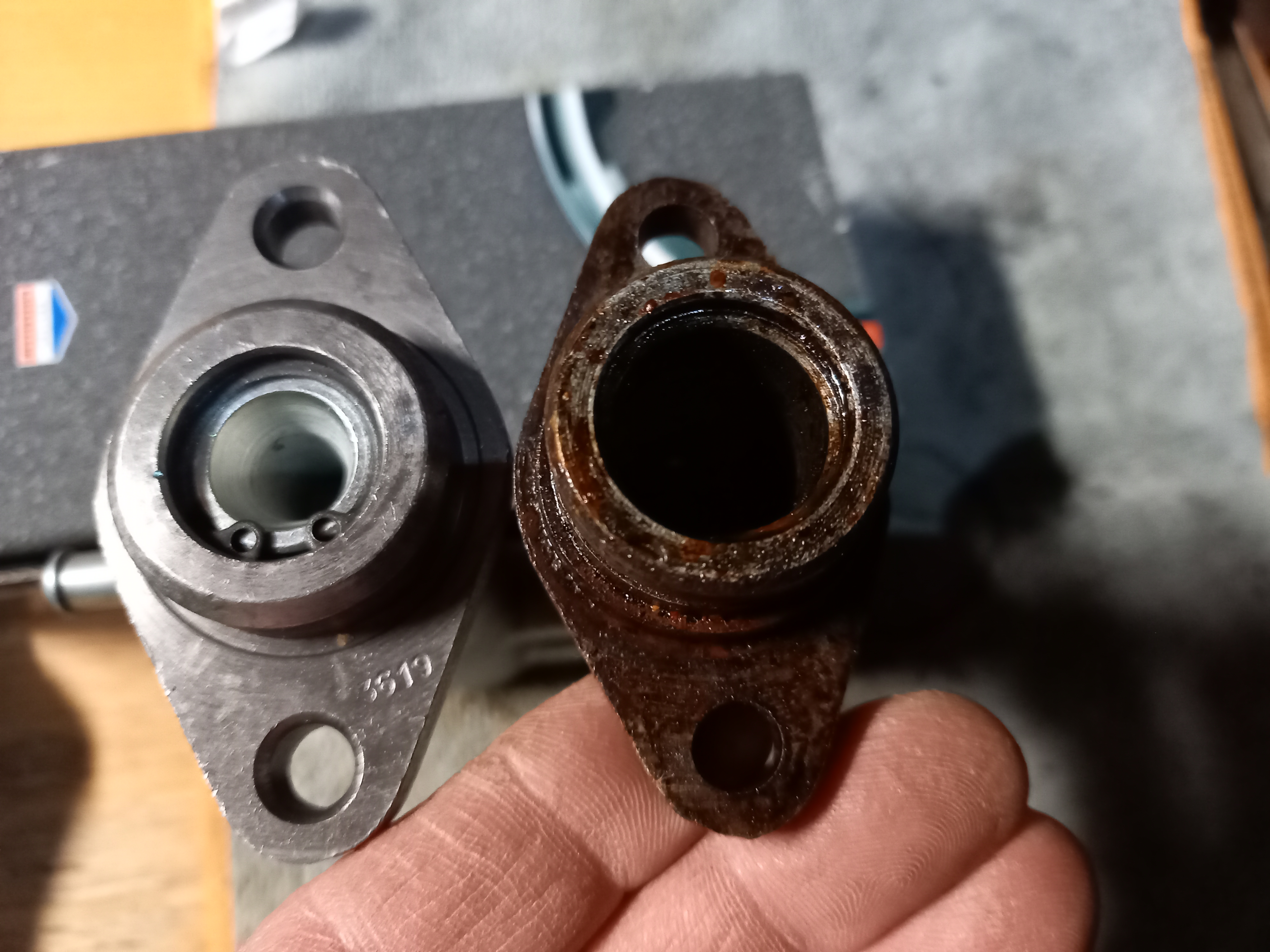

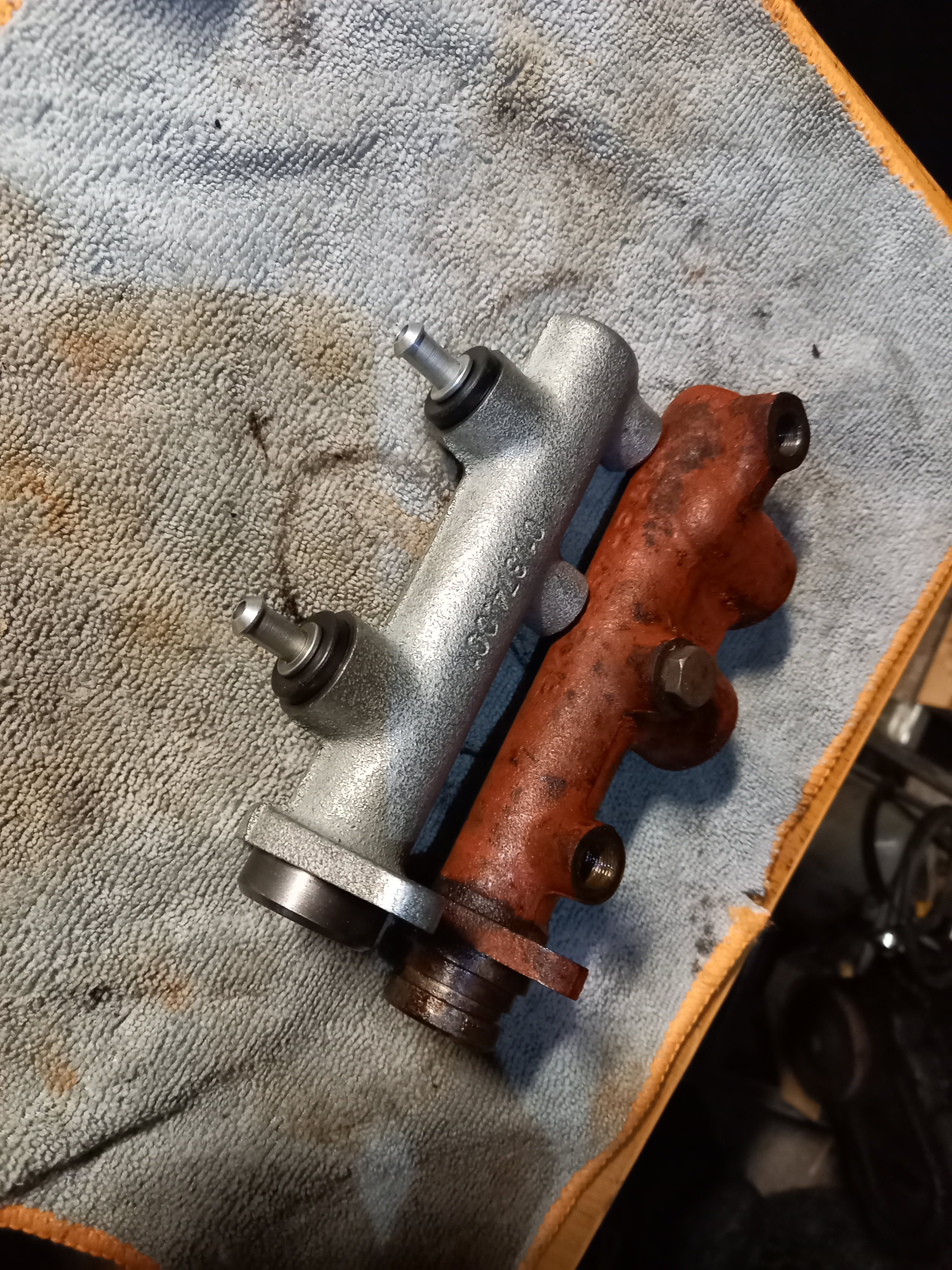

The mastercylinder for my s110 is cracked. So i can not buy a renovated in exange. Does anybody know if I can replace it with a new one for 105/120 with modification of the brakepipes connections and hoses from brakefluidtank? Is their other problems? Thanks in advance.

there are three types:
22mm for cars with front drums and no booster
19mm for cars with front discs and booster, A-series ->1983 (big line connector "nut-type-of-thingy")
19mm for cars with front discs and booster, A-series 1983-> and M-series
Two of these are available for you locally from mainland
http://warreteam.com/varaosat2/index.htm
You could also ask Riku if he is able to get the first model for you if necessary. Thre are some parts that are hard to get but I recommend asking.

Hello.
Thanks for responding!
I actually bought one later model. It will not fit. The biggest difference is against the wall and pedal. I got one of my old and correct ones working now. I think! And hope!
I bought some parts from Riku. Good guy to deal with.
Kind regards!
