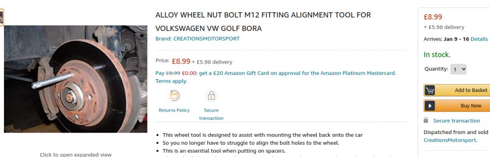

To assist putting on wheels there is a simple tool sold.
There are threads on this forum about them.
It is a threaded rod that you screw into the bolt hole.
You usually then put that to the top and slide the wheel onto it.     Commonly used with 4x4, van  or heavier wheels but you will get one to fit Skoda / VW group cars.
No need to pay a crazy price like this for the alignment tool or postage...

think I should be ok especially with e-Roottoot’s helpful heads up 👍

I have one winging it’s way to me as we speak 😁
Thank you for the info it’s a massive help!
