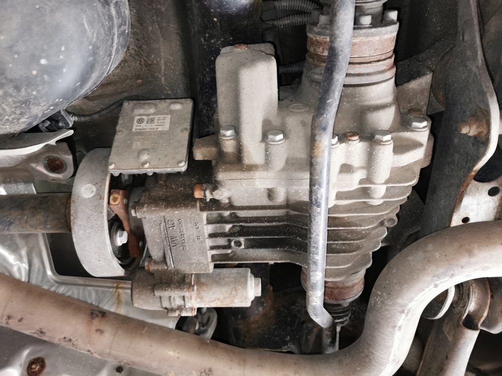

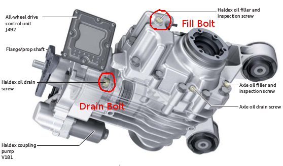

Does anyone here have a clue what these symptoms could be pointing towards? I also need some advice on whether Haldex oil is diff oil or are they separate? Do I have MK5 Haldex? (no filter) How easy is it for me to change my Haldex oil etc? I have use of a pit and I'm fairly handy with the tools but is there anything I need to watch out for? I get the horrible feeling this car has not been looked after as well as they made out and I might be in for an expensive time....

You are on the cusp of Haldex 4 or 5. There is a filter on Haldex5 but is only a mesh mask for the pump. Best get the pump filter cleaned and oil changed over. Unless the car has done serious offroading diff oil should be fine.
Check the rear tyres for stepping on the edges, that can cause unusual noises from the rear.
In the past I've come across centre prop bearing being noisy but that constant and increases with speed.
Of late I replaced the haldex unit on my own car which had a similar noise, I disregarded it until the unit failed completely. That had been serviced, it was just bad luck on my part.
You'll probably have a 5th generation unit.
The differential and haldex use different oils.
Haldex oil in the coupling unit and 75w90s in the diff.
The haldex takes about 850ml and the differential about 1.5 litres.
You drain them then refil until it spills out of the fill hole.

I by the looks of the photo then I think I do have a 5th Gen. Once I know the source of the noise I will rest a little easier as I can make a plan in sorting it out, at the moment its driving me mad. I will order the oils you mention in preparation for a complete service.

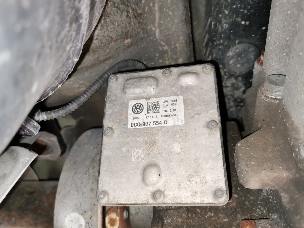

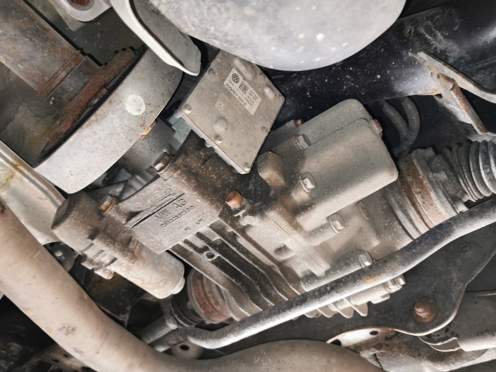

This is my Haldex, just to confirm if it is a Gen 4 or Gen 5? :)
The pump is not to lubricate the input shaft bearings its to pressurise the clutch pack, I dont think a blocked strainer would result in bearing failure but am happy to learn otherwise.
That Haldex controller is the same as mine, cant recall if mine is gen 4 or gen 5 but it does not have an external filter, only the internal pump strainer guaze which should answer your question.
The part at the front, attached to the gearbox is the bevel/transfer box.
The Haldex parts all live at the back.
I read the posting several times thinking the same but was confused by him speaking of listening to the Haldex part & then showing a photo of the Haldex & rear differential.
I believe the front angle drive/transfer gearbox is a known failure point & would suggest that the OP drops the undertray to look for oil leakage if he is actually talking about the front of the vehicle.
Editted, I had not looked at the video or appreciated that he has dropped the undertray, front of vehicle = transfer box & not Haldex coupling.
