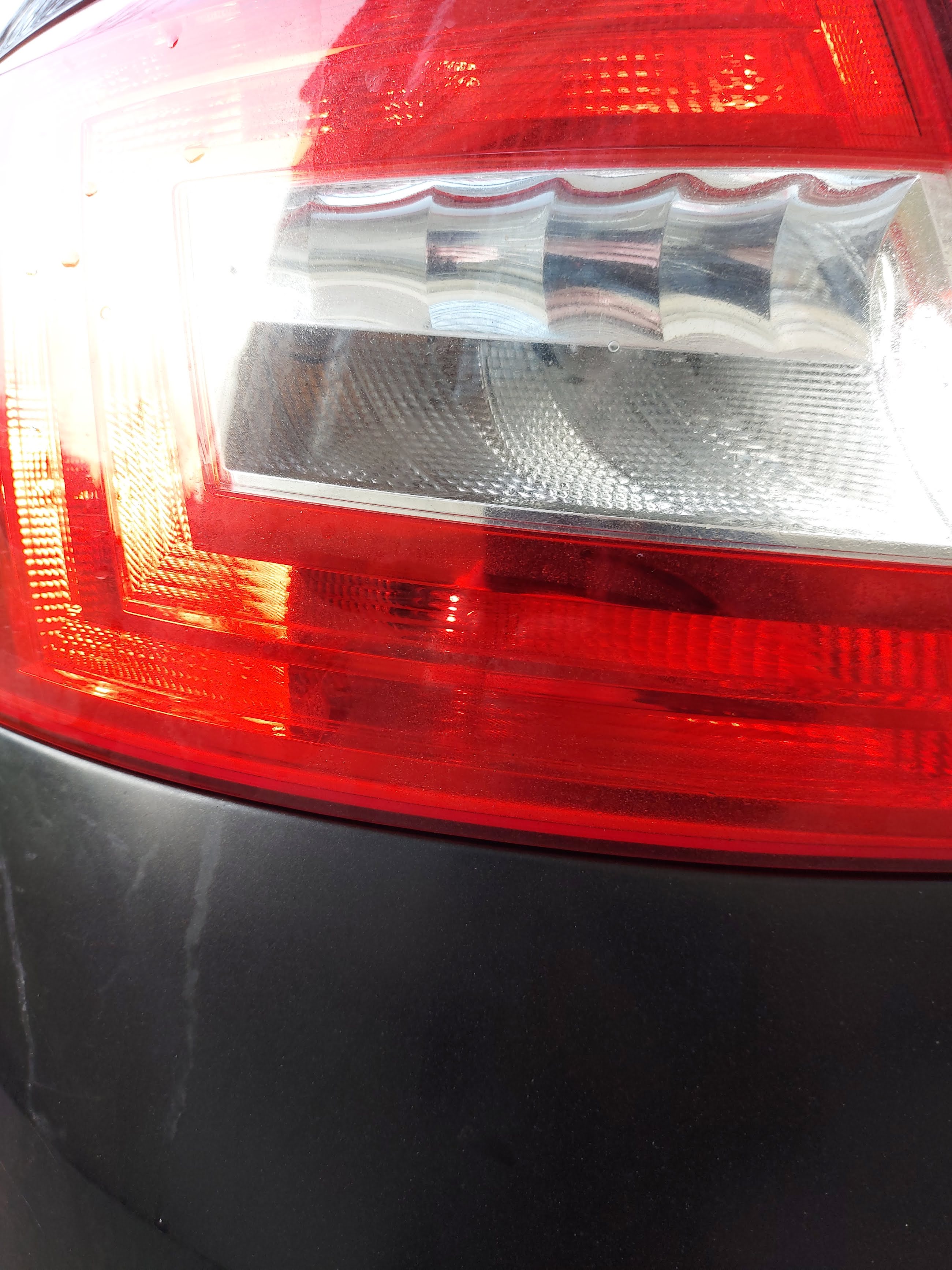

My nearside rear light has a dimmer area than the rest of the C shape (the bottom section) I can see the lamp is on but dimmer than the rest. Is this a bulb replacement job or something to do with me activating the second rear fog light.
The rear fog light works as it should, and when i activated it via OBD Eleven, i made sure all the lamps were set to 100% light output as per instructions. I'm not sure if this is something new or has happened since i activated the rear fog.
I am slightly confused to which lamp it would be, is that one the w5w or the H21W ? Access looks tricky, there dosen't seem to be an opening flap within the boot to get inside?

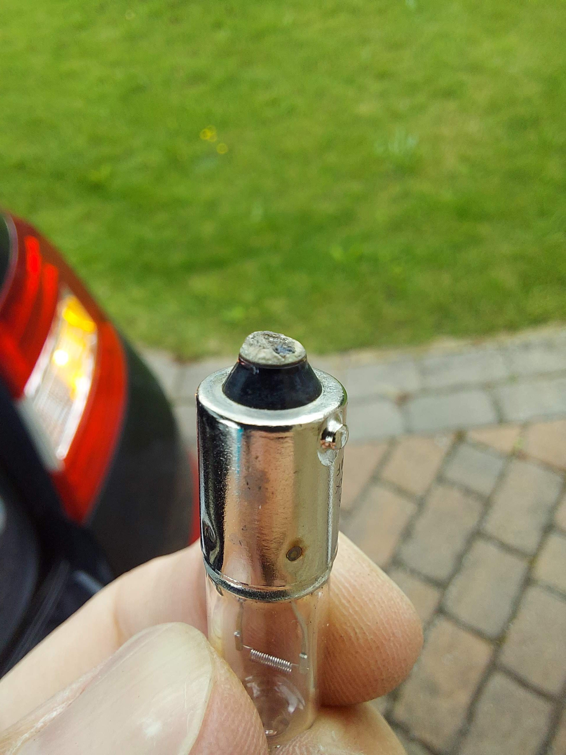

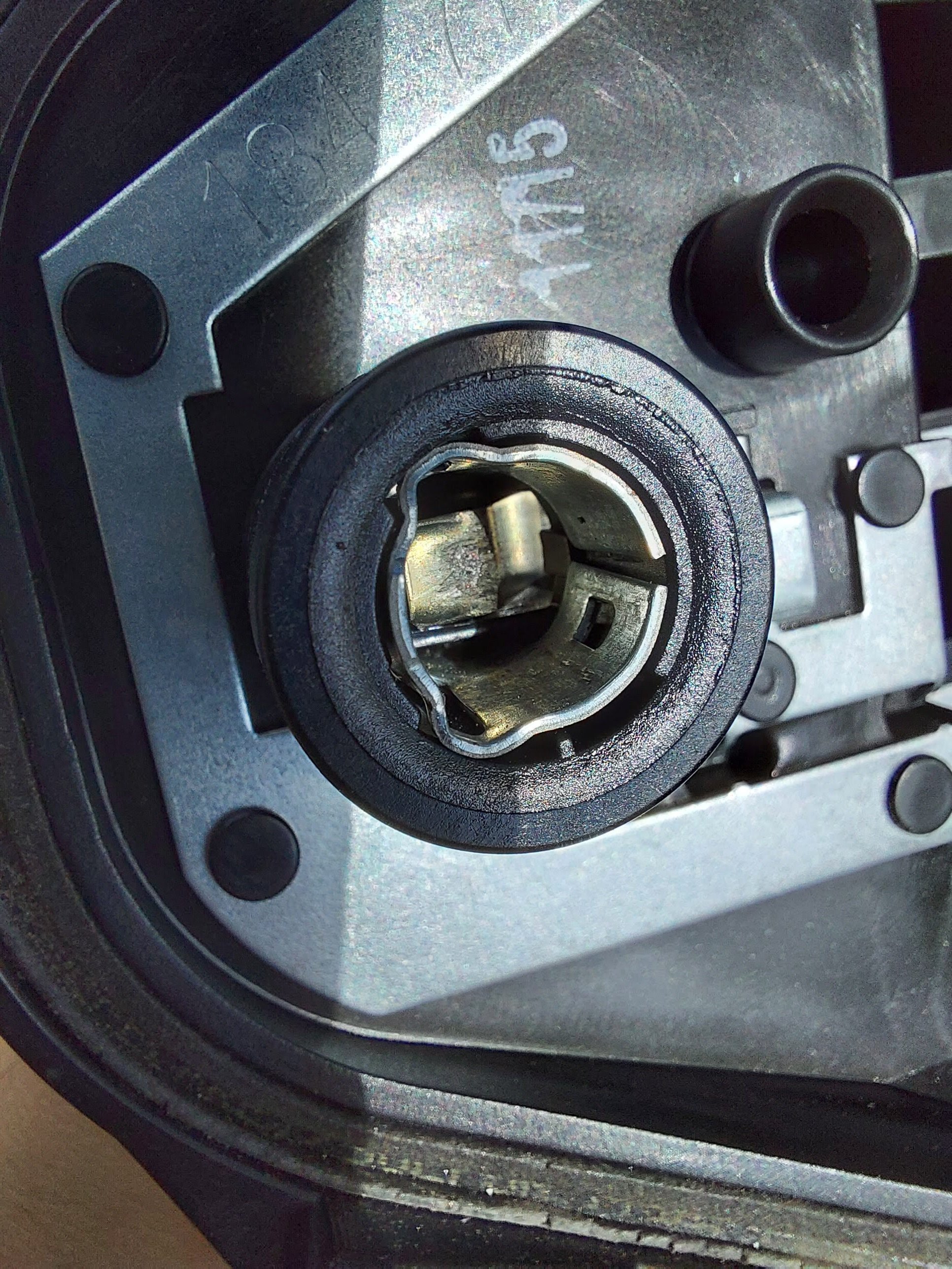

So the output was dim again. I took the light out again and found the lamp had burnt itself damaging the bulb holder. I had to try and scrape a fair bit of corrosion / burn off the bulb holder to get the new lamp to light up at full brightness.
What would cause this? I'm guessing it would be good to replace the whole black bulb holder with new. Anyone know if this would cause an issue? looks like part number 184 772 01 ?
the new lamp is working as it should for now,
