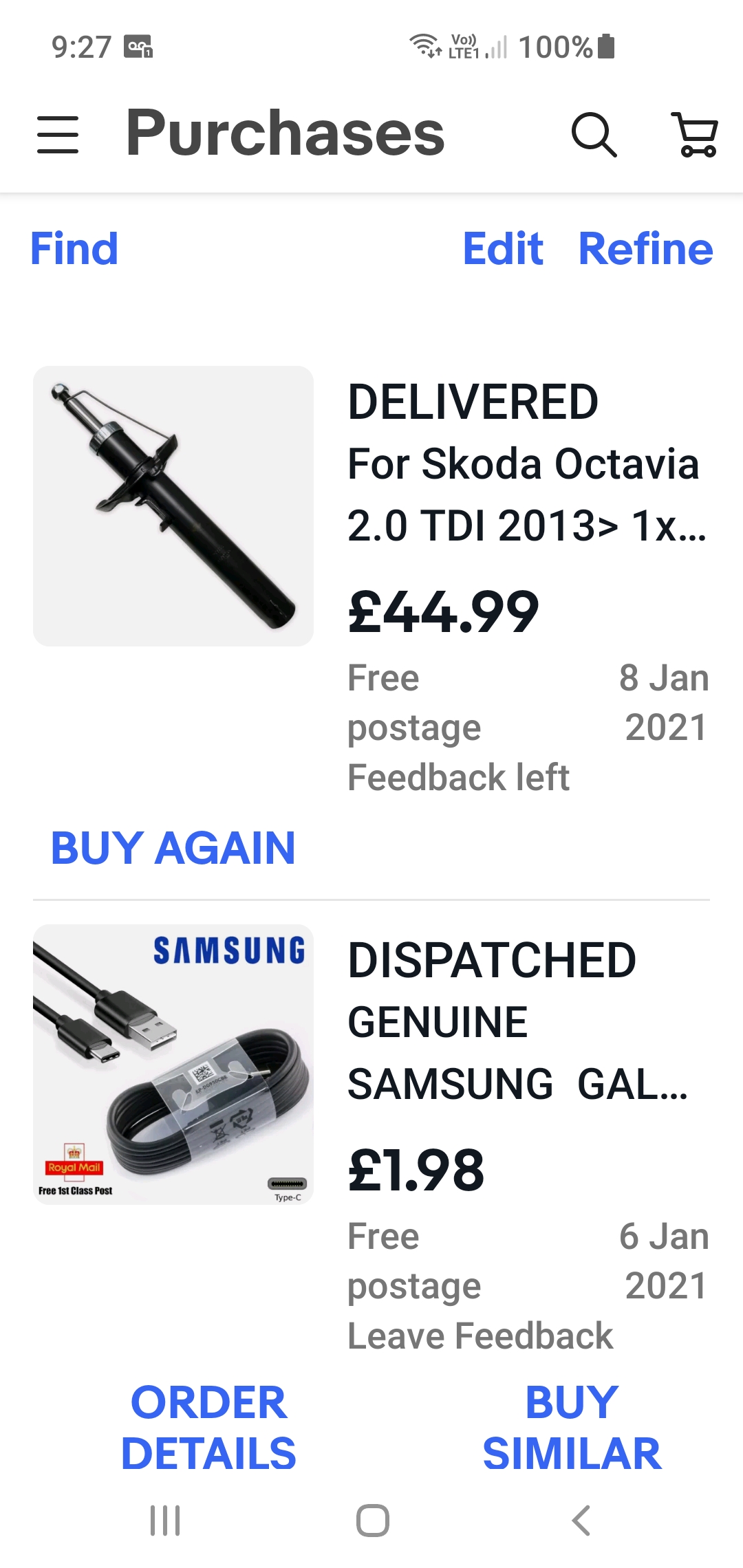

Hi had nearside front shock absorber replaced under warranty last year but not offside front im now due my 10000mile service and thought I would replace the other offside shocker I picked up a bort shocker for £45 from ebay compared to £89+vat from skoda thats with 20% taxi discount anyone used this make obviously as a taxi im changing parts more frequent currently at 55000miles

What OEM part number is your front shock absorber?
There are two different strut outside diameters used on the Octavia MK3, 50mm and 55mm. Are you sure you have purchased the correct one?
See the below links for all the potential OEM numbers that the shock absorber might be. Notice that the PR codes are listed against each OEM number to help identify what the car came with out of the factory.
http://www.oemepc.com/skoda/part_single/catalog/sk/markt/CZ/modell/OCT/year/2016/drive_standart/753/hg_ug/411/subcategory/411000/part_id/2561497/lang/e
http://www.oemepc.com/skoda/part_single/catalog/sk/markt/CZ/modell/OCT/year/2016/drive_standart/753/hg_ug/411/subcategory/411001/part_id/2561497/lang/e
http://www.oemepc.com/skoda/part_single/catalog/sk/markt/CZ/modell/OCT/year/2016/drive_standart/753/hg_ug/411/subcategory/411002/part_id/2561497/lang/e

 2.0 octavia se l 150bhp 67plate 50mm did give reg before ordering u reckon its wrong
It should be correct, as you gave the seller your reg number.
