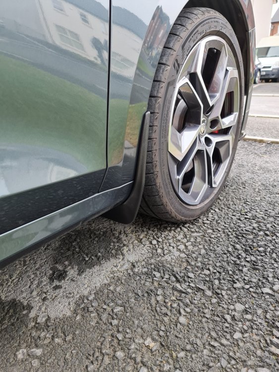

Just fitted front and rear mudflaps to the vrs so thought I'd post a few pics for fellow members
Took around 20 mins to fit without wheel removal.
Sourced from superskoda at 15 euro a pair which is significantly cheaper than dealer prices
They do sit out a bit proud by design as they have integrated spacer lips
All in all I'm happy and they will offer protection and make the rear lower portion of the car look that bit wider

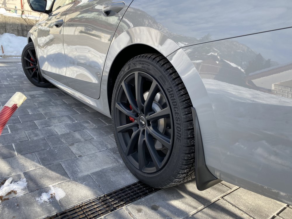

Did exactly the same today. It took me a bit more time since it was -5 °C outside and at half way I needed to go inside to warm up my hands.

I take it, judging by the time it took you to fit them, they fit straight onto existing mountings?
Fronts need an extra fitting and a 6.5mm hole drilled
Rears also have an extra fitting to secure
All very straightforward

I got mine from SkodaPartsDirect and the part numbers were 5E3075111 for the front and 5E3075101 for the rear. Although they are easy to fit, you might need a right angle adaptor on the drill and probably a short drill bit to avoid removing the wheel because you need to drill the arch and space is restricted with the wheel in place. You can pick up cheap adaptors easily from your favourite online store:
I got mine from Kopacek: https://www.kopacek.com/skoda/octavia-iv/mud-flaps/
I found with the front wheels on full lock I didn't need a right angle adapter, but it would certainly have made it a bit easier!
Overall, pretty quick and easy to fit and definitely reduces the road spray/crap on the car.
