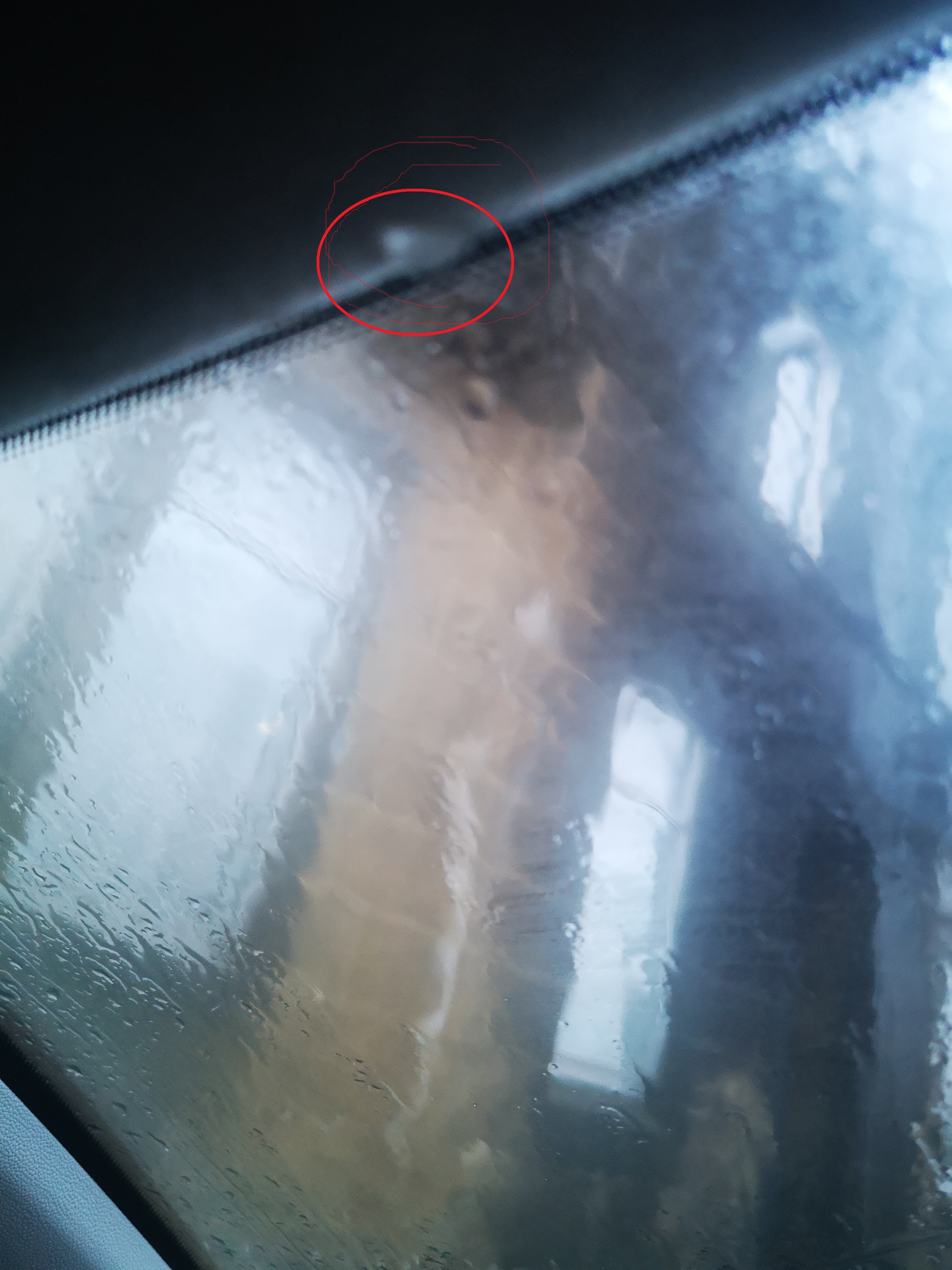

Hi folks,
I've got a fairly decent leak dripping from the N/S of the top of the windscreen, would this just be the windscreen seal failing or could it be from somewhere else (my car doesn't have the raised roof rails). Only other place I could think of is the aerial base leaking but mine is an estate and that would be a fair distance for the water to travel.
If it's the windscreen seal I was thinking of just running a thick bead of clear Plumbers Gold along the top of the windscreen seal, good idea or stupid one?

Would certainly appear to be the original bonding holding the screen in that is failing and letting water in. Any type of external sealant will do the job I imagine, just won't look overly pretty

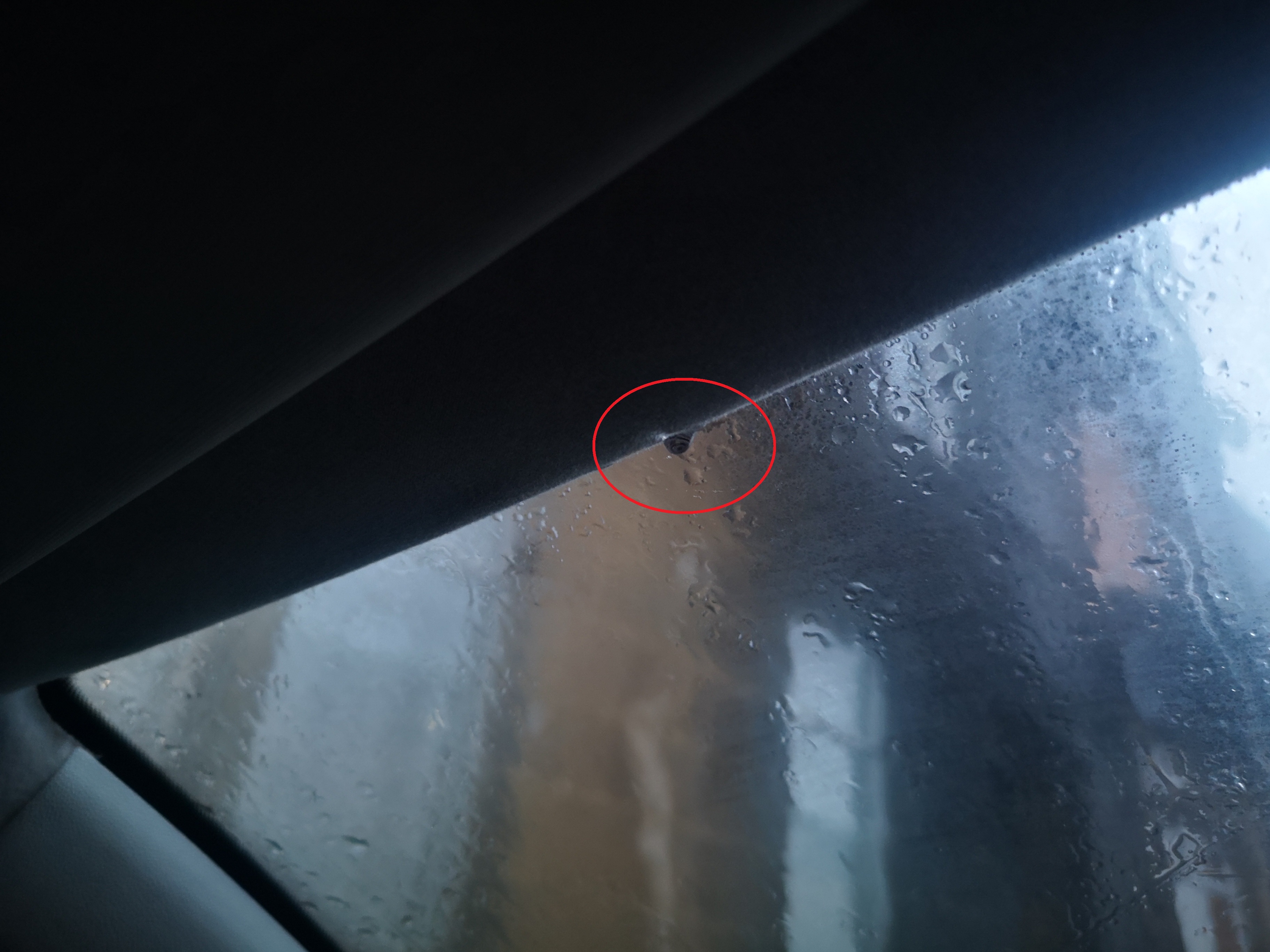

Evening, found the source of my leak after the torrential rain we had over the last few days, definitely coming through the windscreen seal dripping directly onto the drivers seat.
Bought some 'Captain Tolley's Creeping Crack Cure' and hopefully that'll sort it but if not I'll book it in for the screen out and re-seal. Noticed a wee bit of rust on the leading edge of the roof so might need to have the screen out anyway to have that investigated and addressed
