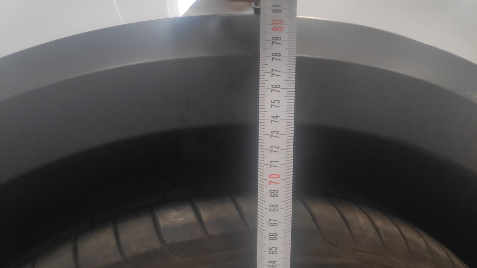

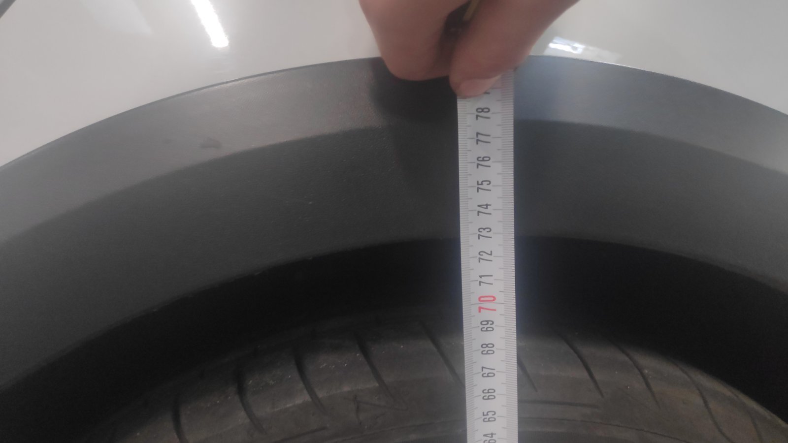

Hello dear Carlston! I installed the front springs, now this is the situation: the front is higher than the back.
Did you fit new 1K0511115CT rear springs?
Is that about 8mm higher in the front?
The reason of course, is because you have fitted Kodiaq 5Q0411105DQ front springs with a wire diameter of 13.5mm instead of the standard Scout 5Q0411105HS front springs which have a wire diameter of 13.00mm.
I suggest you change the Kodiaq 5Q0411105DQ front springs to standard Scout 5Q0411105HS front springs, which should lower your front end by about 6mm assuming that the uncompressed lengths of both springs are about the same.
An alternative could be using helper springs that some people use when they tow a caravan. This would make the rear springs stiffer and increase the rear ride height.
Although Eibach R10494 are listed at 387mm in length, you may find that they are the same length as your current springs. This is because the uncompressed length of aftermarket springs will often vary by a few millimetres from what the manufacturer claims. Also, the springs might come out of the factory with slightly varying lengths.

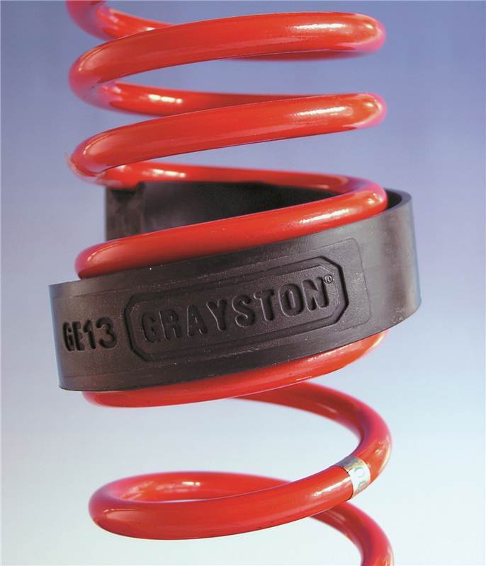

Also, consider "Grayson spring helpers" as shown in the photo below.
Image 1 - Grayston Coil Spring Assisters & Raisers 51-65mm Spring Gap, Pair GE15A, Towing
These spring helpers lock out one of the coil turns, so as your rear springs have about 8.8 coil turns these might increase the spring's stiffness by about 10% and increase your rear ride height by about 6mm.

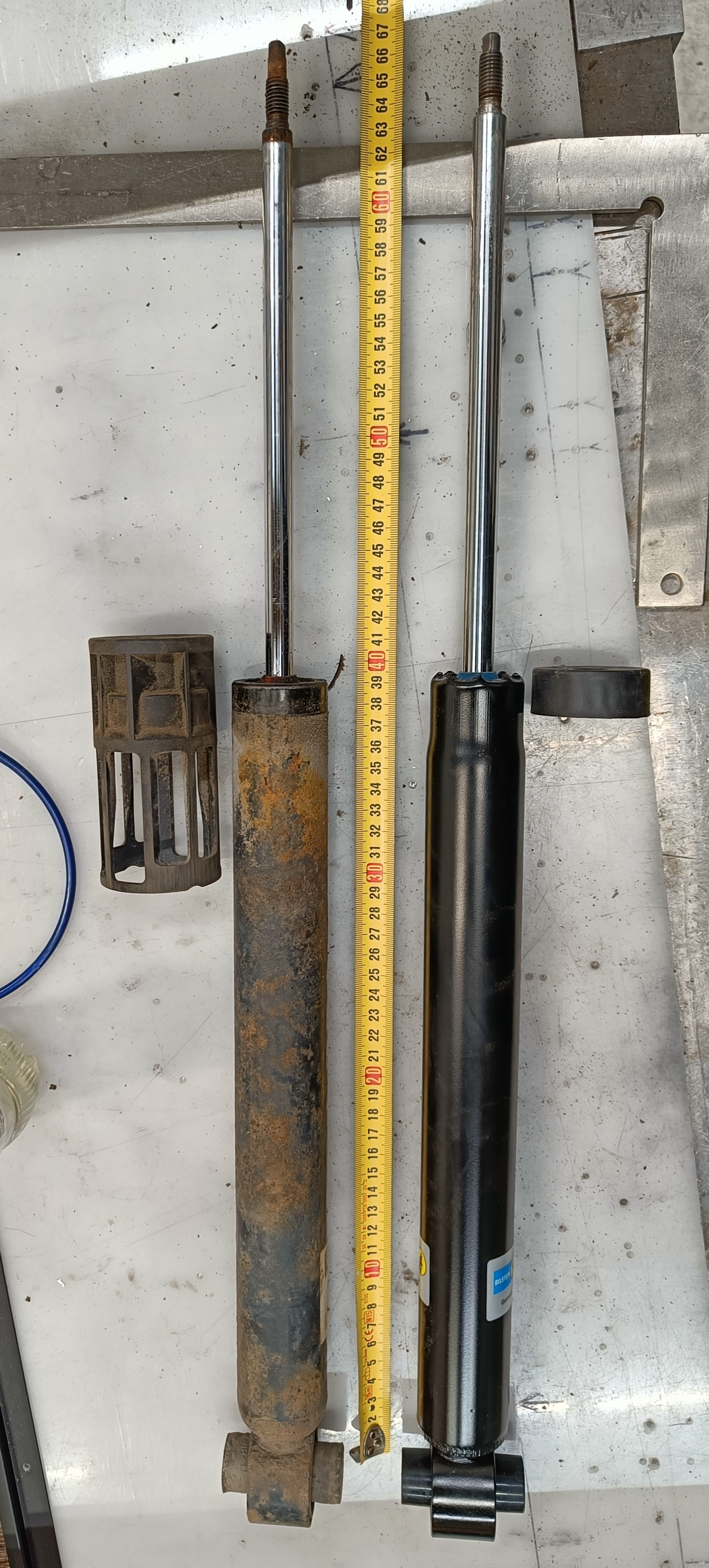

Long time since no update with my Scout chassis parts, but I ended up replacing all shocks and front springs in October 2023 after a clutch failure (was driven approx 270 000km at the time). Rear springs I had already replaced in 2022.
Eventually I went for this setup, my car was 2.0tdi 150hp + manual Scout 2016:
Front shocks BILSTEIN B4 OE Replacement 22-230522
Front springs SACHS 993 960
Rear shocks BILSTEIN B4 OE Replacement 19-230559
Rear springs  SACHS 992 103
At the same time I replaced the lower control arms to front, ball joints and front stabilizer bar rods. After a 4-wheel alignment the car was really nice to drive, the suspension was stiffer then earlier, but not harsh. Should have done the updates earlier. I swapped my scout last october to a 2018 Audi A4 Allroad with 150,000km on the odometer, and I think that the Scout was at least as good to drive as this is now.

I don't have a straight dimension or sidepicture from my car, but here is one picture with the above mentioned setup together with 225/55R17 wheels which eliminated the speedo error and gave approx 11mm more ground clearance.
Edit. Here is also a comparison picture of the oem rear shock vs. the bilstein I installed. In the oem shock there is a plastic part which basically limits the piston rod movement. It will not fit to the bilstein shock, in theory one could install ca. 25mm thick nylon washer etc. to imitate the functionality. I didn't put anything to the shock and never had any issues bottoming out etc during my 40,000km with the new parts. IMG202310281852002.thumb.jpg.810a079d3033cfde6ff35372ed634d04.jpg

Additional picture
