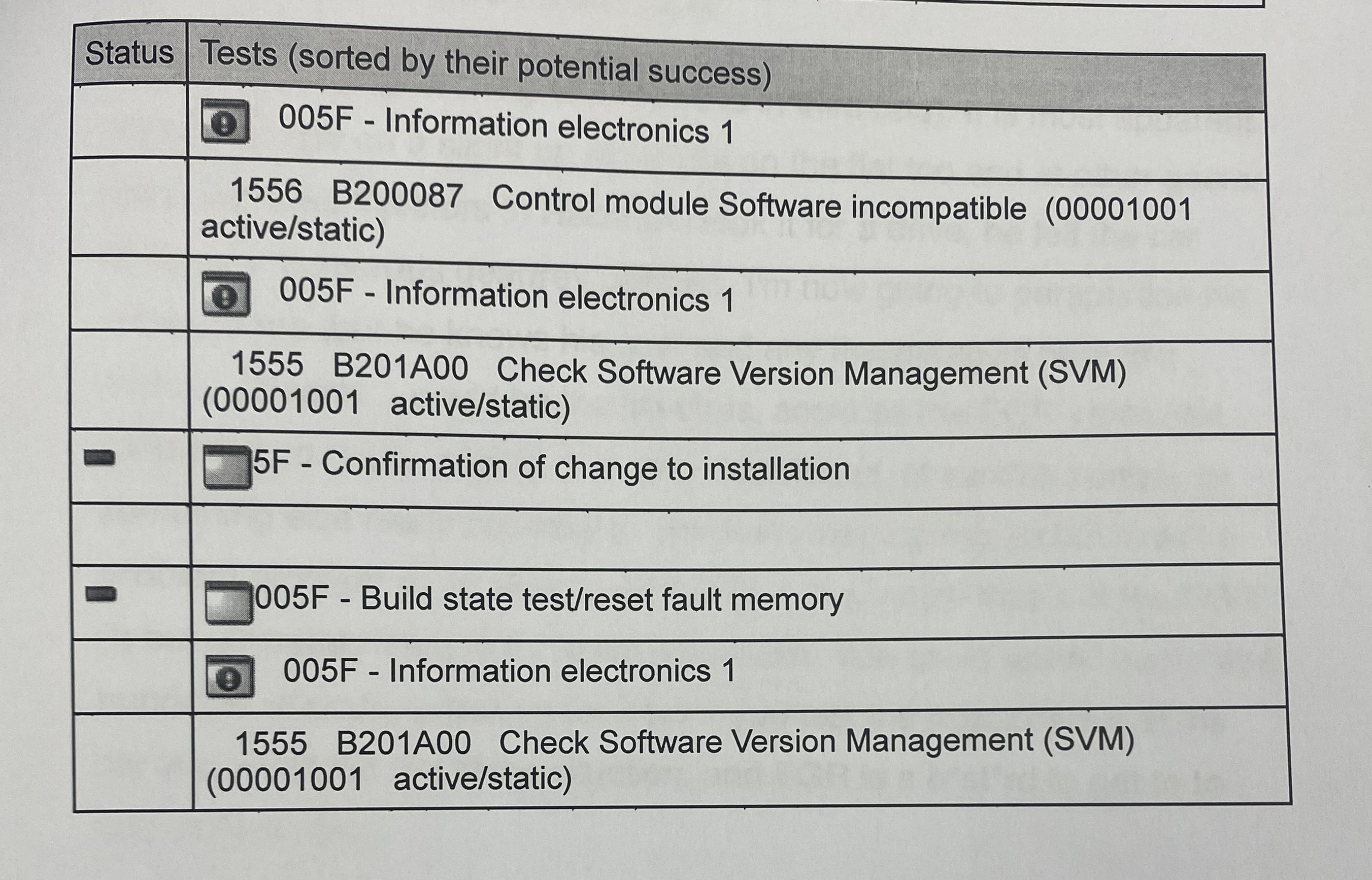

  12. Power map and DPF/EGR delete – well beyond my car knowledge, and the "start/stop" button come to that. Wish you all the best – hope you get it sorted.
