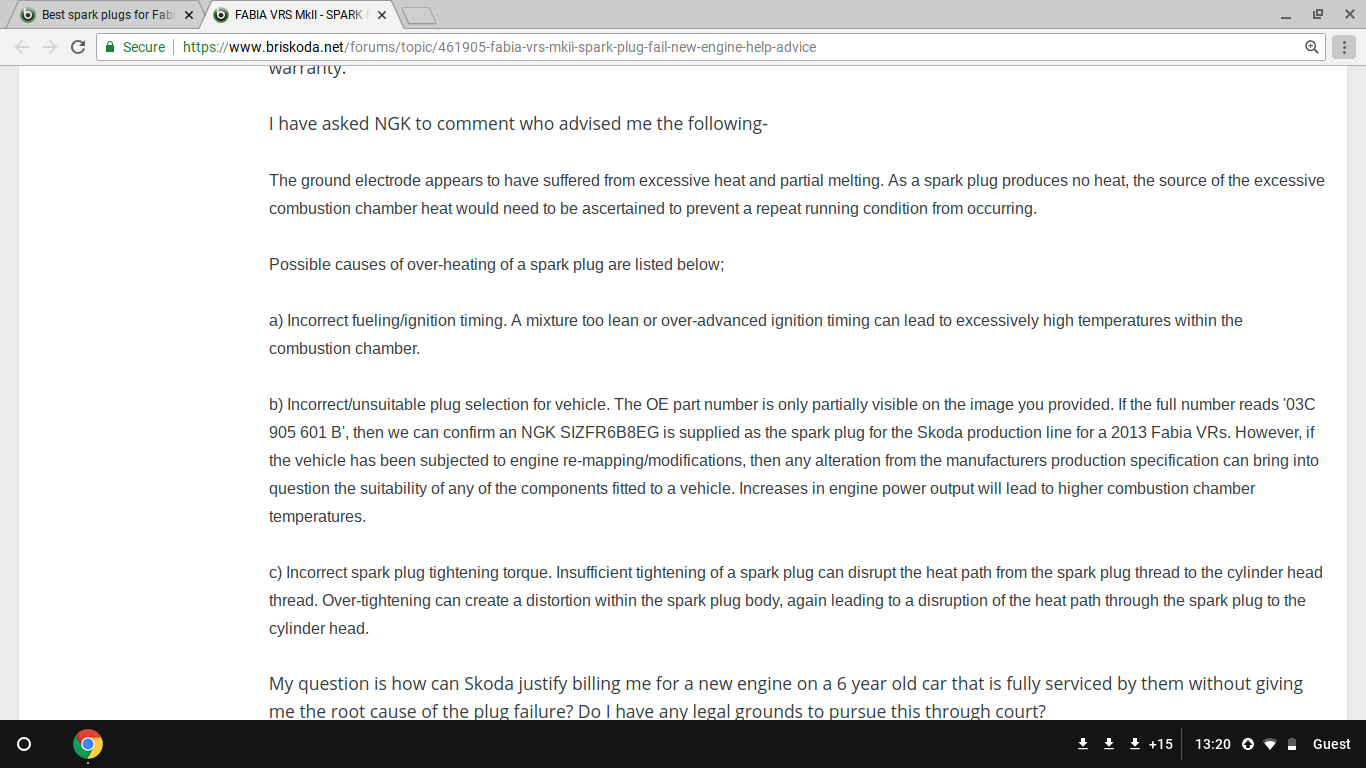

Plug getting cooked due to the fundamental design of the head, manifold and engine management / map.
Yet by using different plugs from the OEM ones you can have the same engine that burned the tip then run with different plugs with a different reach that do not expire in the same way.
Better still you can run the likes of a APR Stage 1 map and the different plugs and not burn the tip off a plug and not have the excessive oil use issue.

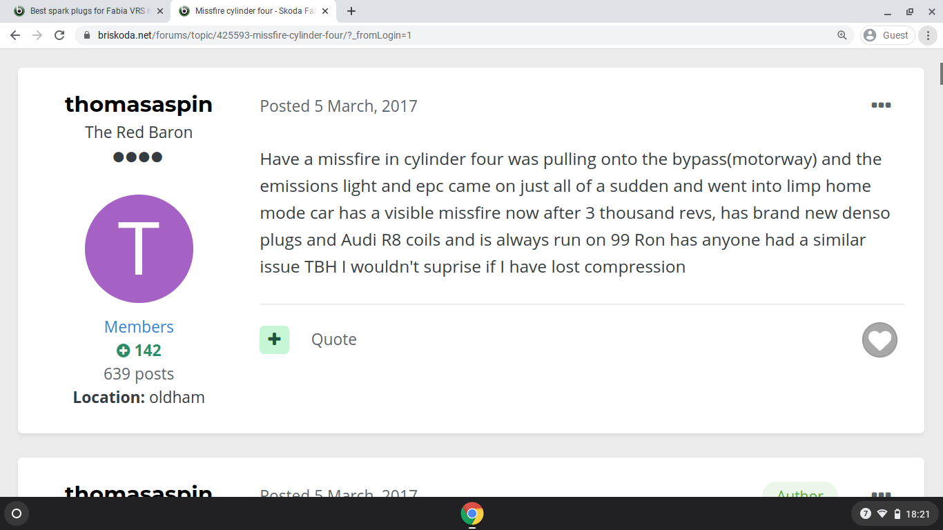

  • The denso plugs where gapped to 0.6mm on standard coil packs you absolute helmet

@thomasaspinHas his R8 Coils fitted and Denso plugs, but we were let into a secret. That was they were not fit and forget.
Maybe they did need gapping.

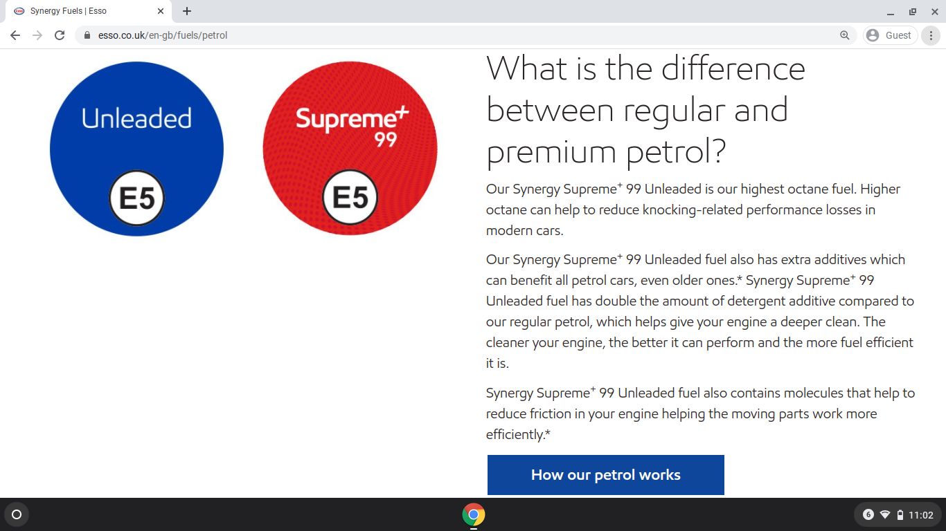

@GUESTYGood, the Esso is now 99 ron minimum.

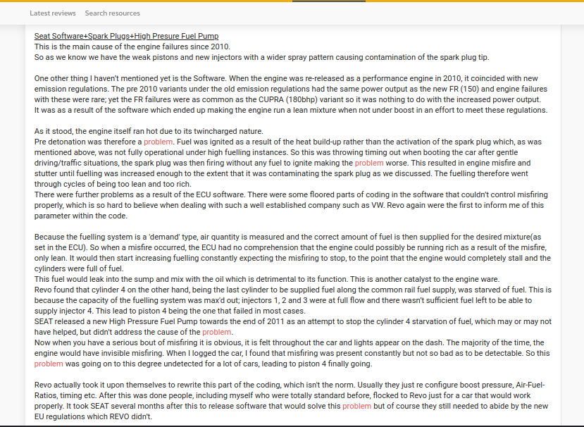

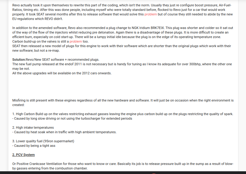

NGK as a manufacturer of spark plugs are not really the issue as many have used them for years in vehicles.
When i first started working on cars & bikes 50 years back there were Champion or NGK to choose from in garages.
The issue is their application with the Twinchargers and that VW Group have never admitted an issue with the OEM plugs on engines they produce that can have issues.
So NGK will blame 'User Error' or Dealership fitters error'  rather than addressing the Elephant in the room.  VW Group's head in the sand.
The NGK that many use for remapped cars are fair enough, but when used in a sporting way like track, hillclimbs, sprints or just fast driving they can have a short life.  5,000 miles or less. Or one plug can, the other 3 might be fine.

*Worth remembering the REVO stage 1 map was terrible and more than 1 member posting in this thread ended up with dead engines.
There were posts / threads about actions concerning REVO being deleted from this forum.*

@AmusedMusselIs the ESSO Super Unleaded in your area not now 99 ron (Minimum) ?

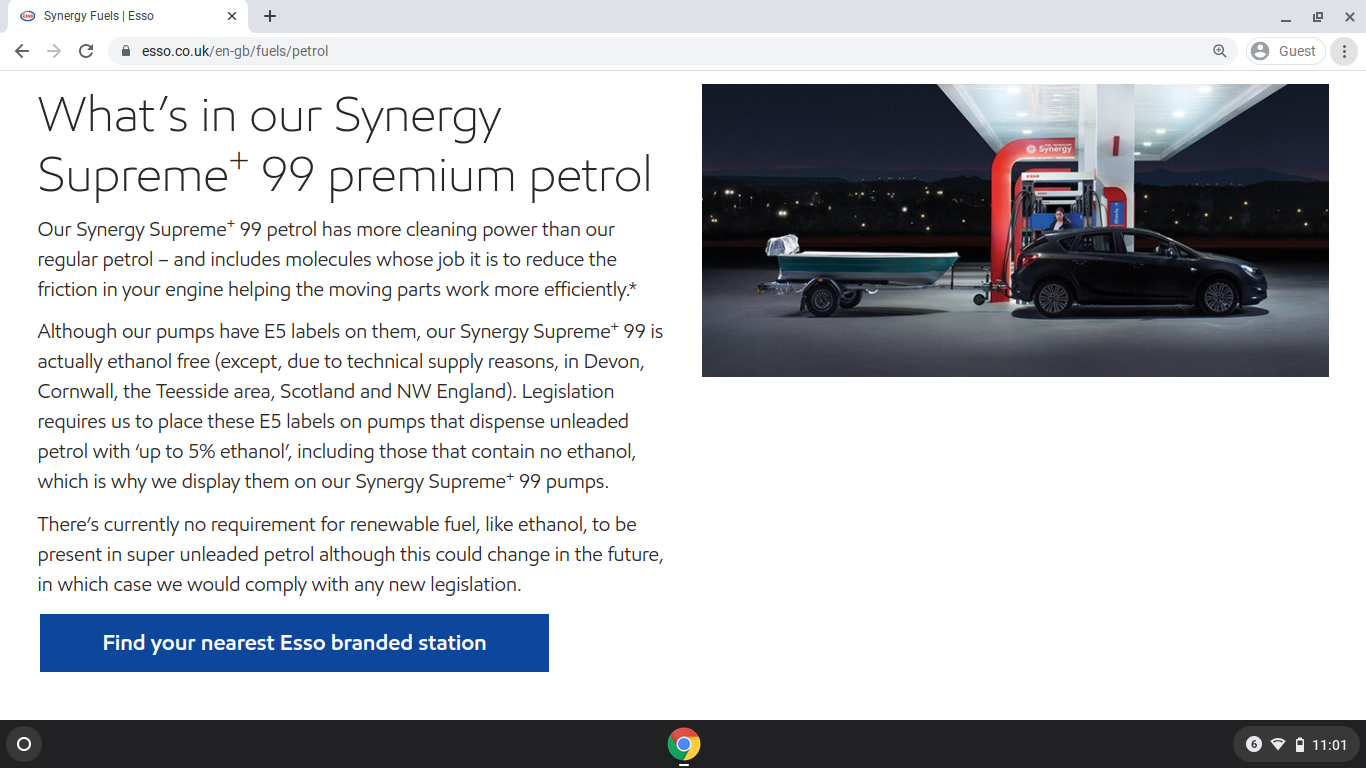

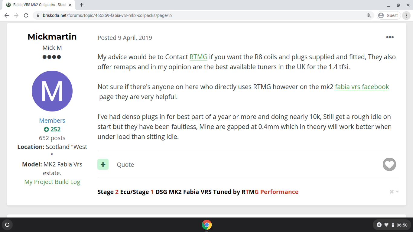

I ran denso for almost a year at a gap of 0.4mm as the plugs implied on the box the gap should not be adjusted and they did run fine for probably 8 months or so then the misfires started back so moved to NGK BKR7(2667) and haven’t really looked back, no misfires, no rough idle and most likely   by pure luck Ive never had an coil issues.
Went stage 2 in December 2019 and was recommended by RTMG that I gap the NGK’s to 0.8mm as I was running more power  so I immediately done so and all was good, never had any issues whatsoever apart from clutch slip in 2nd gear when red lined in “s mode”, that is solved by changing gear a bit earlier and rarely cause me issues.
I had a friend running stage 2 by Ecotune on his forged 1.4 tfsi running 280 bhp, early teething problems seen him returning back to Ecotune to get the map adjusted a couple of time but they did sort eventually, credit to them.
Again I can only go on my experience with plugs on these cars and from what knowledge I’ve learned online from other users and I wouldn’t discredit Denso however personally it would be NGK for me as I’m running R8 coils with the BKR7’s these days without a hitch, I never gapped these new plugs as left them at 0.6mm with the new coils and they have been absolutely fine.
@thomasaspin You must remember well when you had not even managed to get to be a helmet.  You managed to have some howlers.
You should remember what you had when having issues.

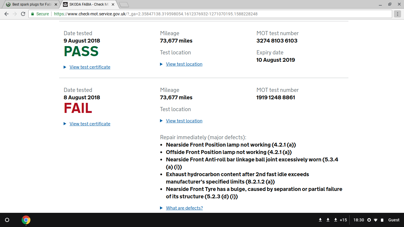

Can you explain please why you say DENSO plugs do not have such a long life as NGK plugs?
The Service Life of the NGK's or the DENSO is said to be 60,000 miles.   The VW Group Service Schedule for Spark Plugs is given as 40,000 miles / 4 years / 2nd major service.
Plugs can go 40,000 miles or 60,000 miles.
They might not be lasting that long in a 1.4TSI / TFSI 132-136 kW, or a remapped engine.
 Or 1 plug might not.
I had 4 DENSO plugs that were in a Twincharger for 30,000 miles & it was running stage 1,
using 99 ron and occasionally 102 ron.

Aye it was a 97 RON fuel, because I cringed a little when I realised it was the only one around. Normally fill with Momentum.

They run rich when cold and just bumbling around, especially a CAVE vRS on the factory engine management / map.
Hence healthy ones often have a sooty tail pipe and after giving them a bit of hard acceleration there can be a blast of soot out of the exhaust system if it has not been getting much of accelerations going on for a while.
The issue is often below 3,500 rpm under hard acceleration so with supercharger and turbo both in use.
95 ron being used might never be an issue to the driver and plenty run just that and could not care less.
Plenty had issues running 95 ron, or 97, or 98 when you got it, or with 99.
But when you had the plugs oiling, then 3 cleaning with some driving and heat the one plug that gets carboned up it the one that is prone to failure.

There have been cases of standard twinchargers failing a MOT, even a first MOT if not done at a Skoda Dealership MOT Station,
even failing at a MOT station and passing if retested at a Skoda or VW Dealership.
People learn after it happens once.
Then Modified / remapped ones can have a failure, or sometimes a examiner says the car has been modified even when not.
http://briskoda.net/forums/topic/480567-14-twin-charged-emissions-failure
I see an old car i had failed a MOT yet again on the examiner not knowing it had side / position light that are also the DRL's,
and again they failed it on emissions.
When i had it and the examiner tried to fail it because it had a decat which it did not i just changed the switchable APR map and said go try it again.
That was a pass.  As were the sidelights,
