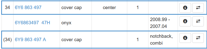

I have been trying to source the product and part number for the panel covering the boot/tailgate lock, from both my photos one is my current lock and the second is the panel I'm after in someones hand. Any help finding the part number would be much appreciated.

I had the same issue,the part was missing,I sourced one from my local car breakers yard, it must be the same part for all models as i got
 it from a basic older model.
