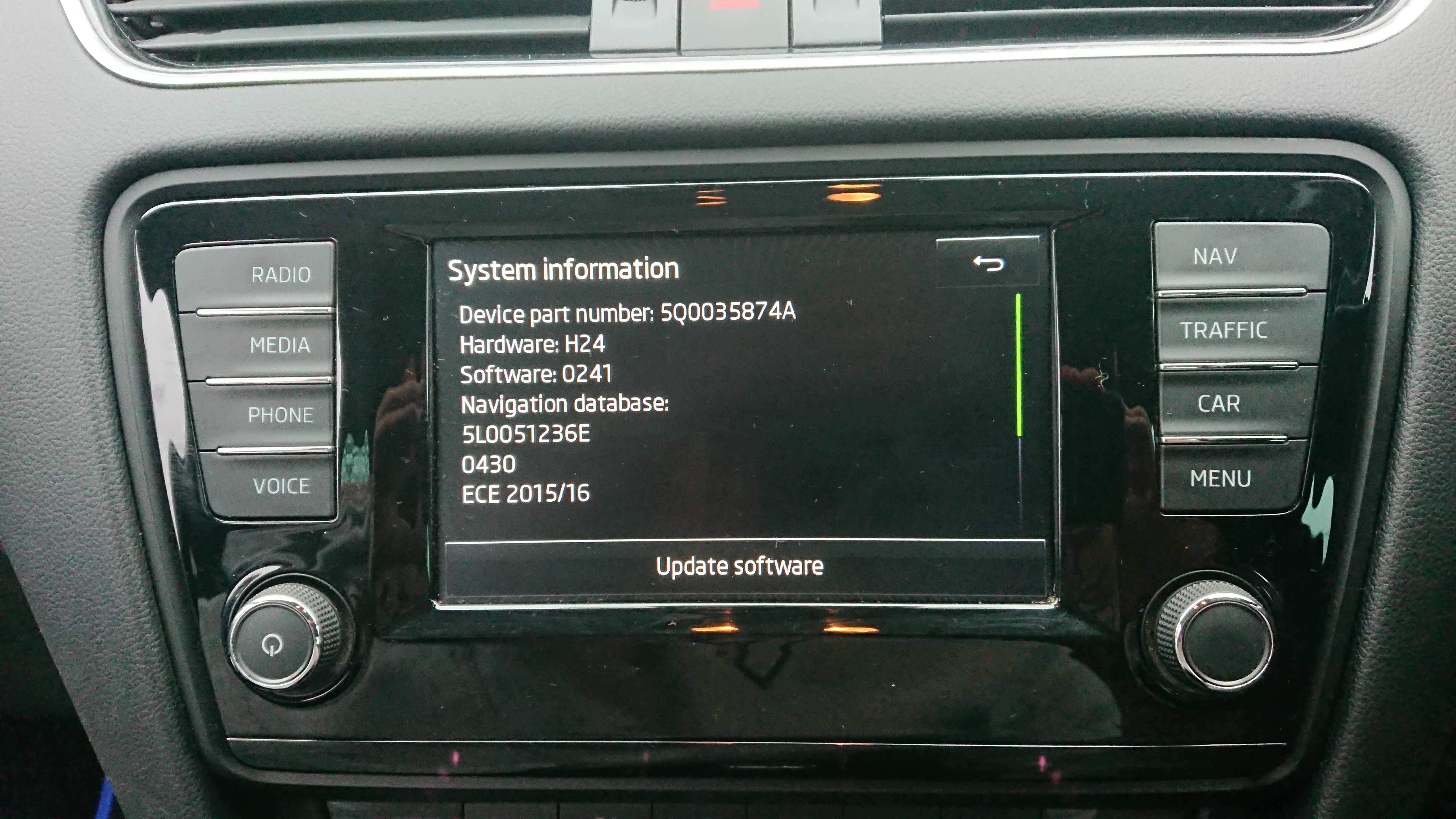

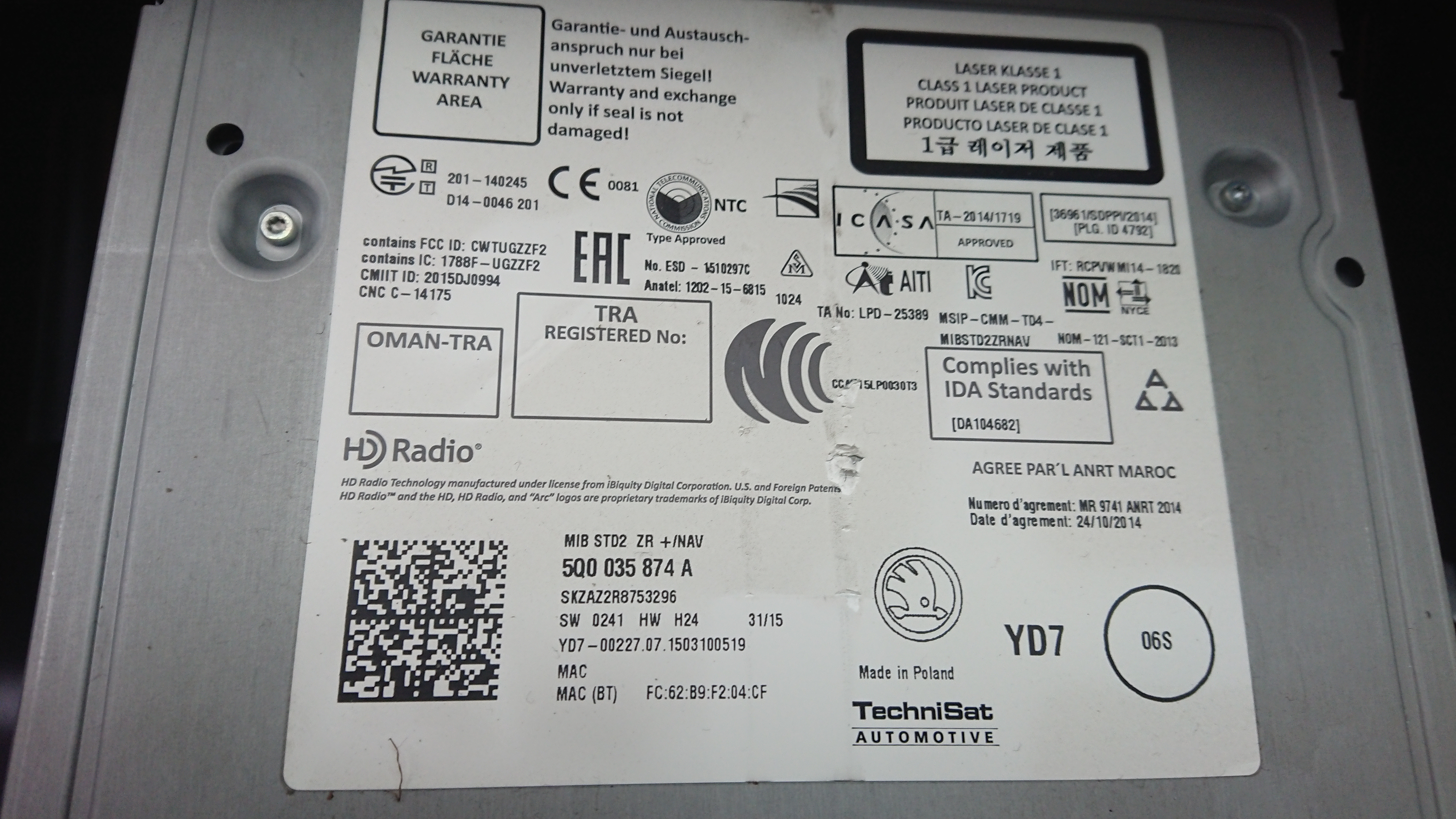

Hi guys, just picked up my 2015 Scout, and have the usual questions. I'm wanting to fit the reversing camera but don't know if I need an independant power source or if its plug n play. Could someone tell me which unit I have?

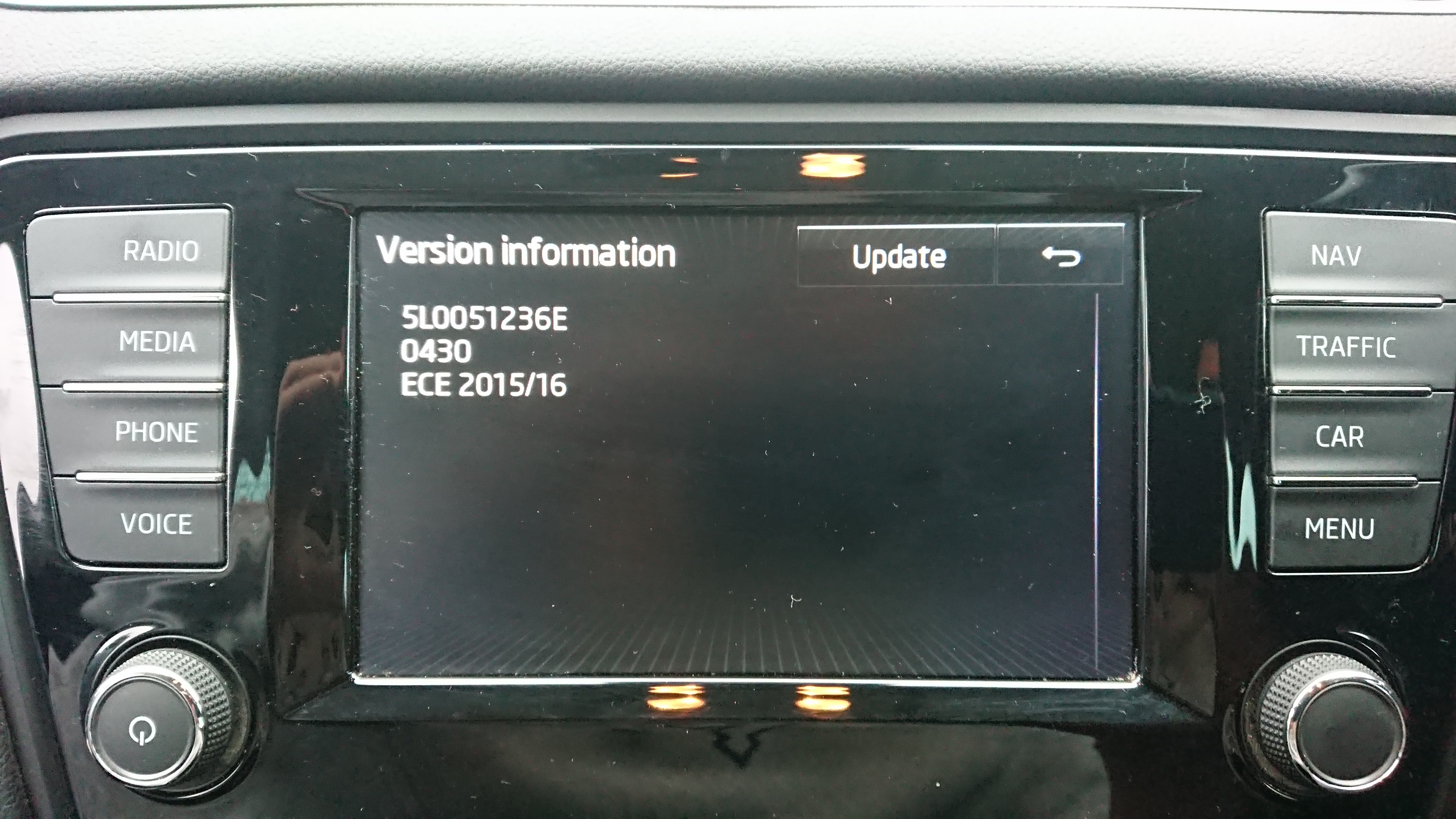

Secondly, I don't think the maps have been updated since it was built, there's certainly a few new roads near me that aren't on it. How do I go about updating it?  I've updated sat-navs before with cracked software so fairly confident with it.

Media Codec 2101.0.0.8
That looks like a MIB2 Amundsen to me.
To update the maps (which MUST be saved on a genuine Skoda SD card - if you use the one you have then save the contents on your PC first as a backup) then visit the Skoda Portal here then enter your VIN and it will show you the latest available maps to download.
Once downloaded follow the instructions to uncompress them then copy all the uncompressed files onto the SD card AFTER clearing it first (I use fast format as that's quicker than deleting all the files).

The car was advertised as having a Bolero unit, and being on the verge of the late 2015 change over date I really couldn't work out what it was.
So MIB2 *should* be the plug and play type camera, won't need the seperate power source.

If it's got navigation then it can't be a Bolero!
