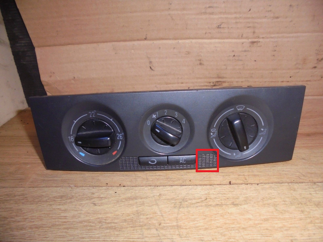

On the heater control panel there is a temp sensor and a tiny fan behind the little grille. You might have a problem with that. Check it's not clogged up with dust.
Edited by TMB
Thanks it was clogged up! & I cleaned it
