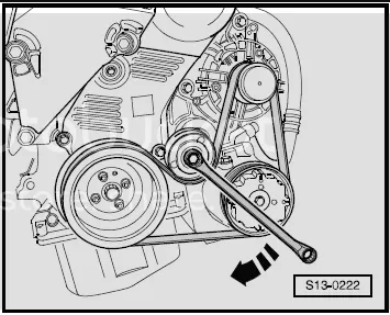

I’ve a 2003 SDI comfort estate with air conditioning and the auxiliary belt tensioner snapped the other day. I’ve replaced it and less than a couple of hundred miles, the new one has snapped too. I’ve checked the air on pulley and alternator pulley and both are spinning freely.
Sounds like a very momentary squeal from the belt before a bang and the tensioner rattles off under the car.
I had an issue with this type of tensioner before and it was periodically breaking the securing bolt but this was traced to the overrun pulley on the altenator not working and the vibration over time was breaking the bolts but this looks different and seems to involve force and quite quickly.
any clues?
That’s the previous one. The damage on the lug on the first pic I think was done by a following car running over it.
