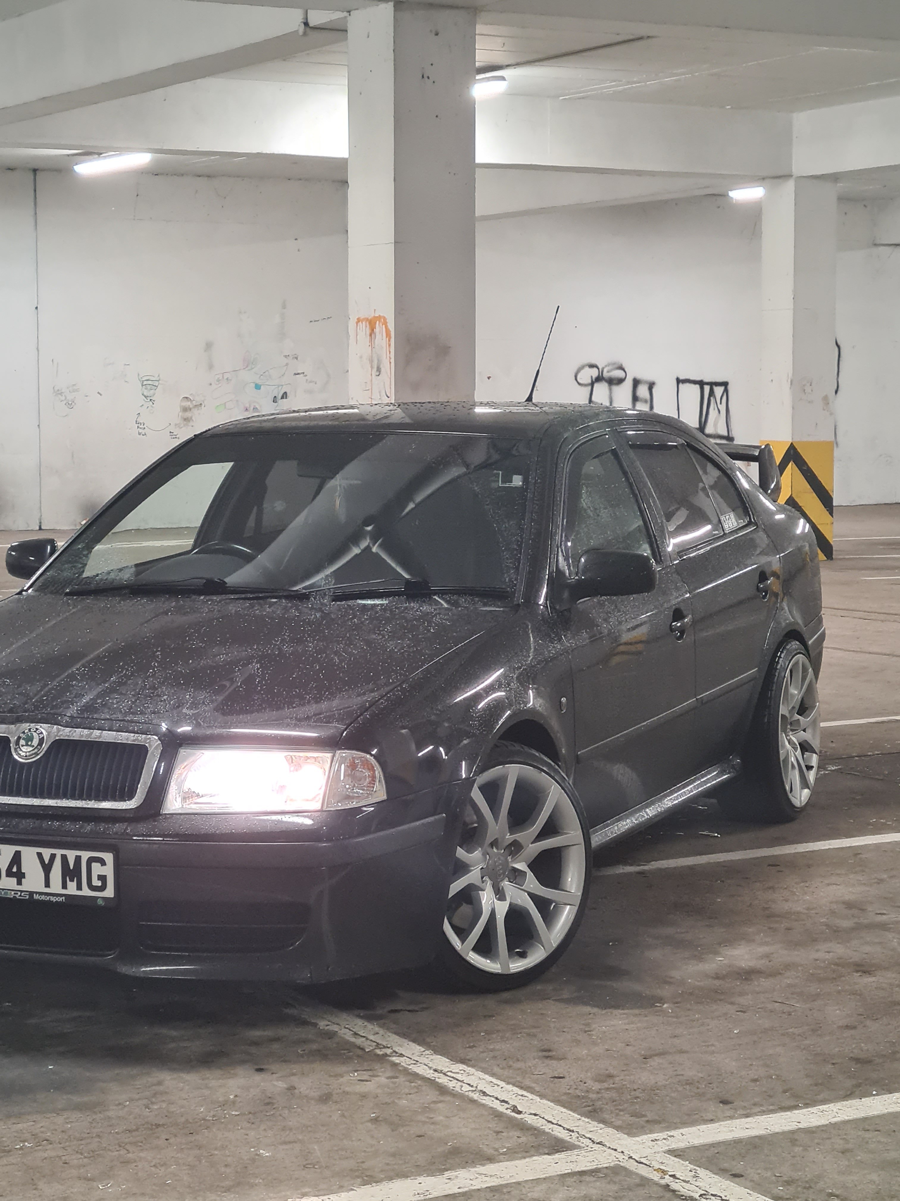

What wheels do you propose to fit?
A5 speedlines I believe they're called currently running them with stud adaptors but the sit to wide so catch the arches
Very tempted by a set of TT Comps though so might for that option and run spacers to clear the calipers
They suit well!

Nice looking wheels ŁÓDŹ. Yes they are a little wide. They look good but I’m sure they will catch the arches.

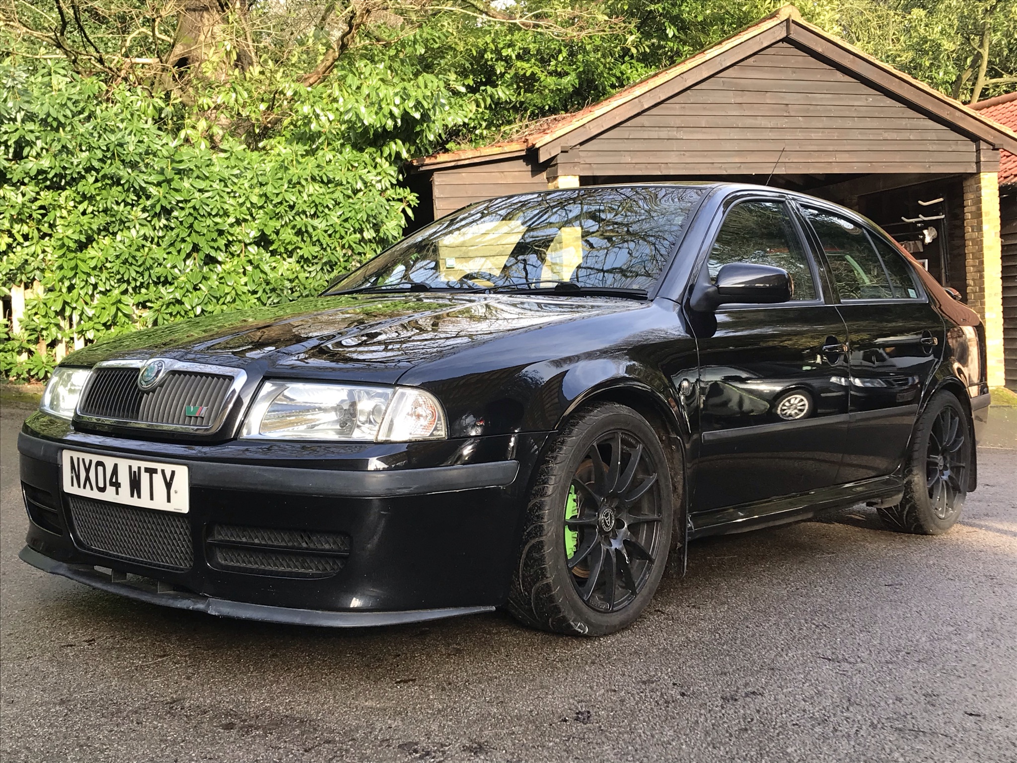

Mine are Wolfrace Prolite.
they were on another Octavia that I bought a few years back and I’ve saved them for running track tyres on. A couple of little flakes here and there so I may get them powder coated, probably in black I guess.
