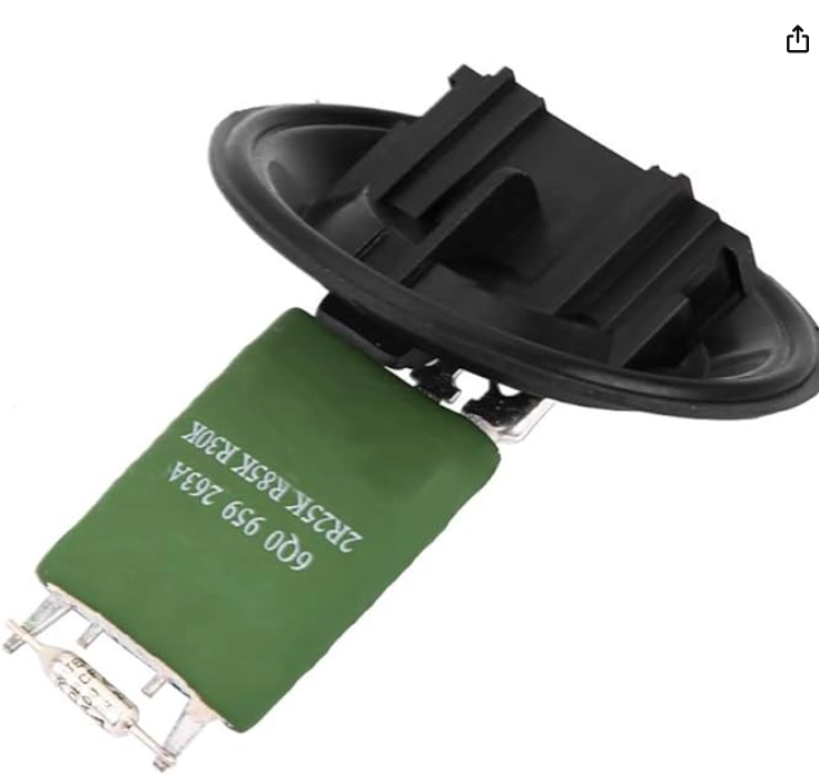

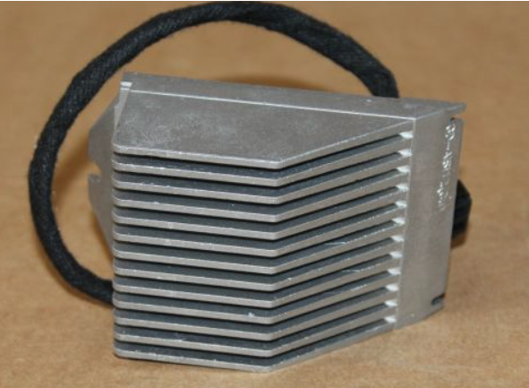

The two systems have different 'resistors'.
The Climatic (semi-automatic A/C) has this type of wound resistor (actually three in series with tapping off points and a thermal fuse)
Climatronic (fully automatic) A/C system has a transistorised version that looks very different:
I think @Wez5480 is saying is that he went looking for the former, but didn't find it because he actually has the latter (6Q2 907 521A for RHD; 6Q1 907 521A for LHD), which isn't in the same place. Both of those part numbers have been superseded by a suffix B version. Genuine ones are rather pricey.
