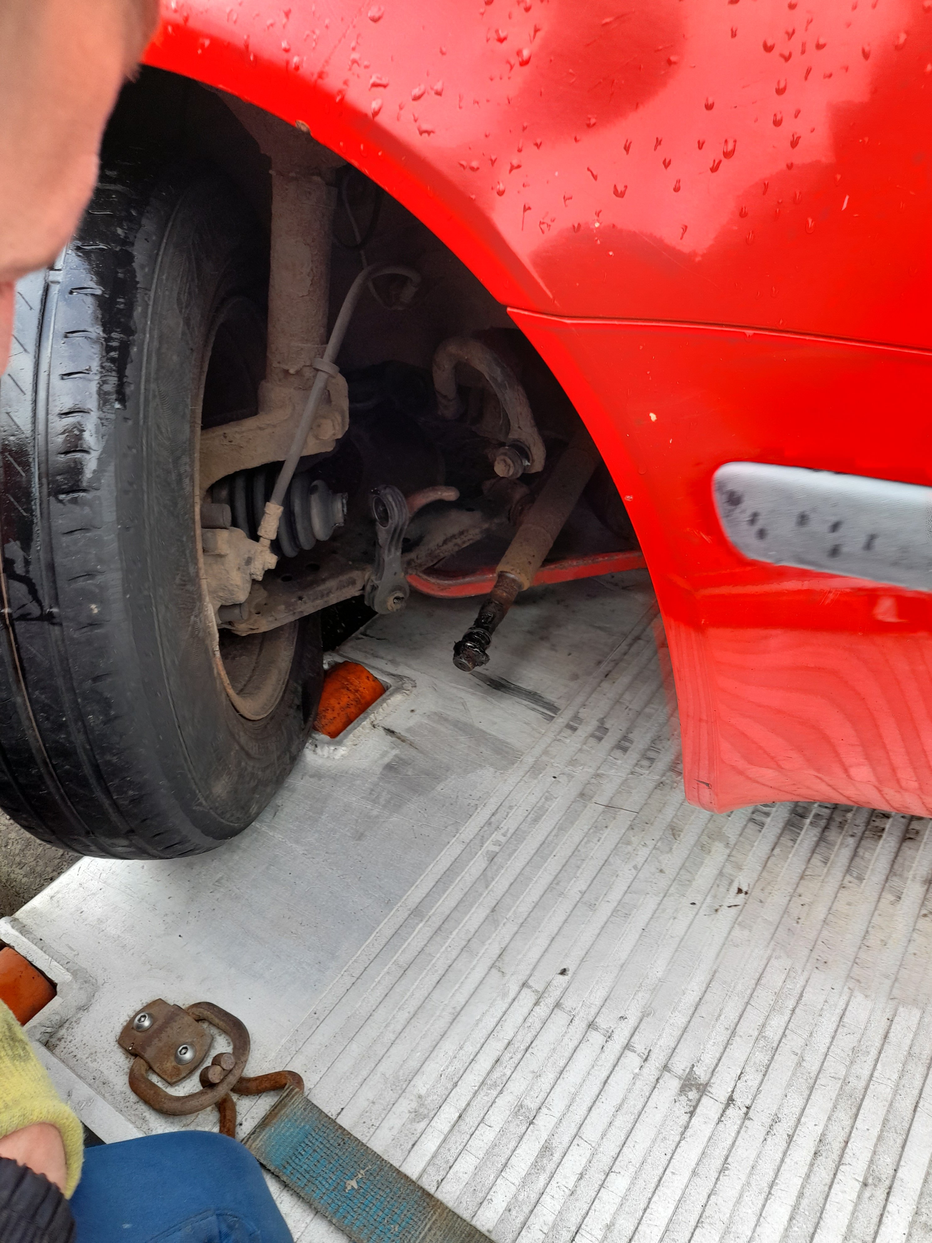

Hi guys. Just a wee note to say that I narrowly escaped a catastrophic crash last night due to a front subframe failure on my beloved 2001 octavia diesel estate. Luckily I was only travelling slowly when it failed. Worth inspecting, next time your car is up on the ramps...
More detail or a photograph is necessary.
How will people know what to inspect, why and where from the above description?

Hi there. I posted this as a warning to other MK1 octavia owners to be aware. I am a big fan of this car, thats why I'm still driving one. I've attached a20210326_102235.thumb.jpg.e4031d7d66a2a565692b88db6fc3762d.jpg pic to show where the sub frame broke.
@ecojunkWhen did your car pass a MOT which meant a professional had run their eye over your car?
The tyre tells you all you need to know about how the car has been looked after.
The car passed it's MOT in December mate. Although its a 2001 model, the car is well looked after and regularly maintained. It has has all new running gear, tyres, brakes etc. This came as a big surprise?

I’m still failing to see the damage/crack. Can you show the actual subframe and not just the side view of the tie rod ends and ball joints. Interested to see as I haven’t seen this before, unless it’s been messed with before in the past as they use stretch bolts (one time use).

This might be a bit better. Looks like the arm has either separated from the subframe and took out the driveshaft or broken to me. I have seen a few MK4 platform arms break due to corrosion internally - it doesn't show up on an MOT though as it looks sound from the outside,
The car is in to get this repaired. I'll post pics of the break in the subframe on collection. There have been posts on this forum before about subframe failure. I agree with your point about it being hard to diagnose during the MOT as most subframes on a 20 year old car will look rusty. Thats why I posted this failure. I thought that other Skoda drivers, driving similar older vehicles, might want to check theirs. If I had been on the motorway or a busy street, things could have ended very differently!
@ecojunk  The thing is that you worked on your car, the car was inspected as far as a MOT does check and yet yours failed.
So if you are not Derren Brown you are none the wiser until the failure happens.
