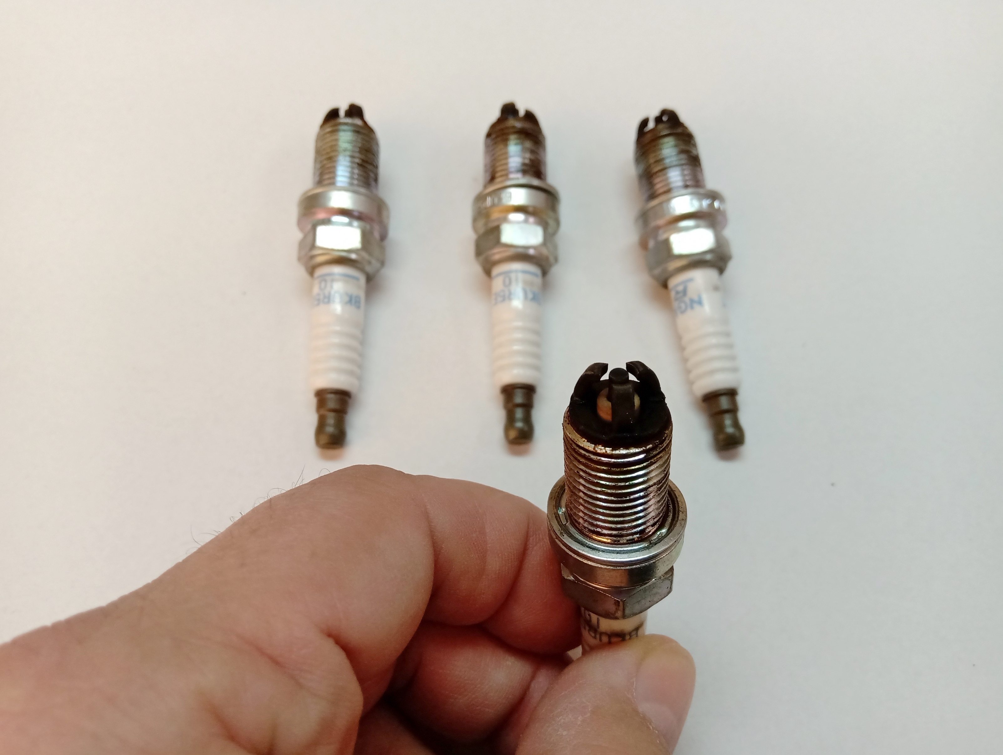

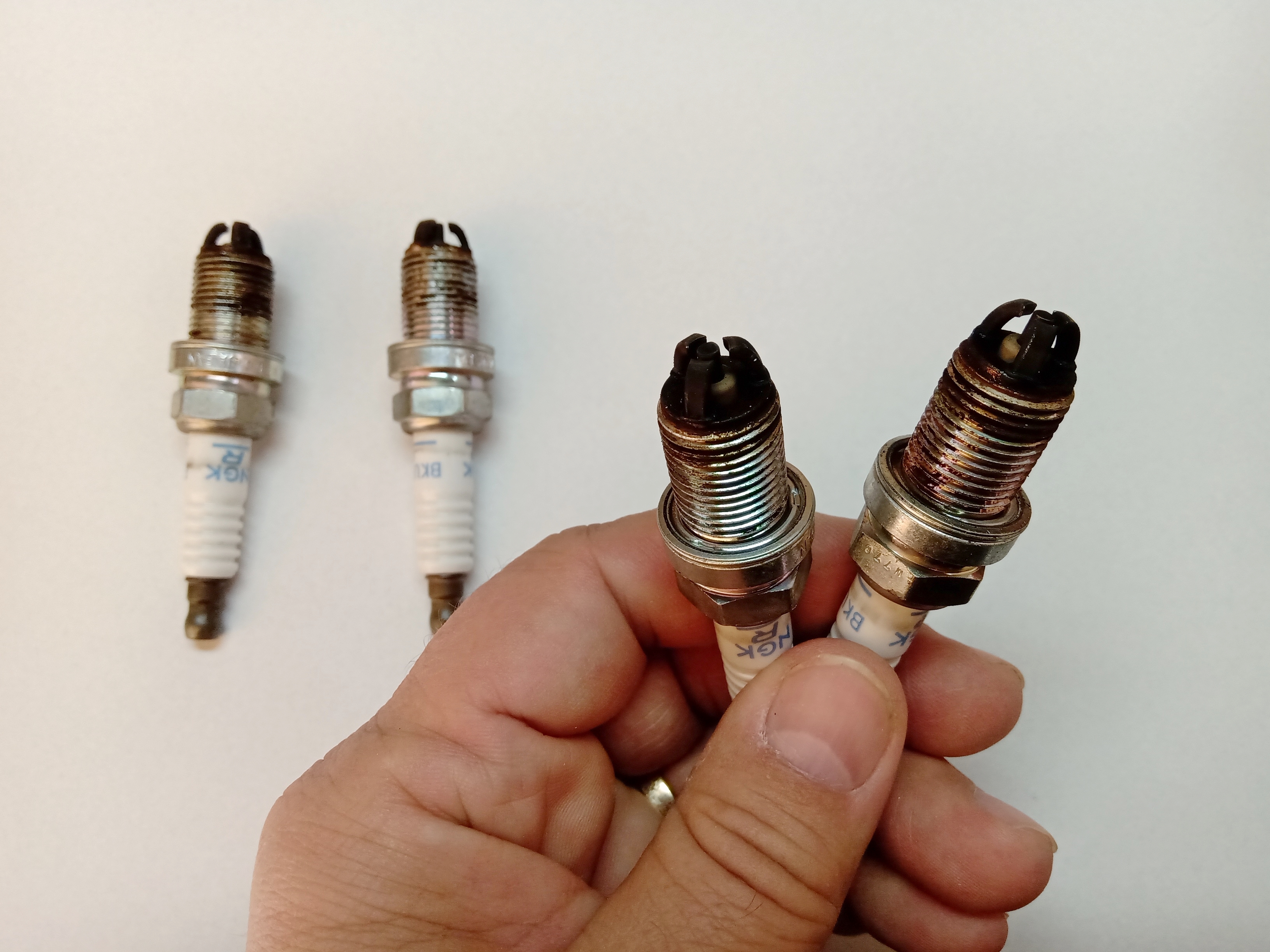

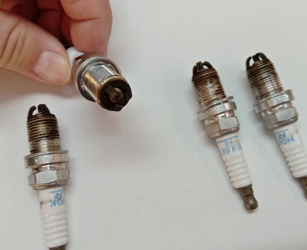

Are from my Felicia 1.3, i had them for about 5200 Km inside town only which means traffic, no hi-way or boulevard over 100km speed etc.
2 photos are with flash.
Can you tell me your opinion about the combustion?
Edited by D.FYLAKTOS
You need a bit colder plugs judging by the discoloration of the threads and it runs okay maybe a tad rich but safe non the less

Those 2 spark plugs are not the same, NGK are Cooper and Champion are Platinum.
I saw a increase in gasoline consumption and in cold starts the car was a little bit ''wild" as back in the old days when we forgot the manual choke valve open.

Well, I'd say the car is running rich.
Also, I'm dubious about the benefits of multi-electrode and/or precious metal spark plugs in an engine design this old.
1 hour ago, KenONeill said:
Also, I'm dubious about the benefits of multi-electrode...
Multi-electrode plugs are prescribed by Skoda...

As for the videos and charts with spark plus there are dozens at least for 2 decades, the issue here is to find WHY those spark plus are like this and IF those NGK Cooper plus are appropriate for an old design motor.
I  don't see anything wrong with the spark plugs while driving only in a city traffic. It is the worst life for a car.
Only if the spark plugs look the same after a long highway drive, I would be worried.
I use Platinum spark plugs for 20 years in my car and they never were in such a condition, i don't see the reason why the mechanic put Copper.
Yes, but you had the best available heat grade, and the correct mixture and timing. Most plug faults trace to wrong plug grade, or miss-set mixture and/or ignition timing, not of choice of electrode materials.
