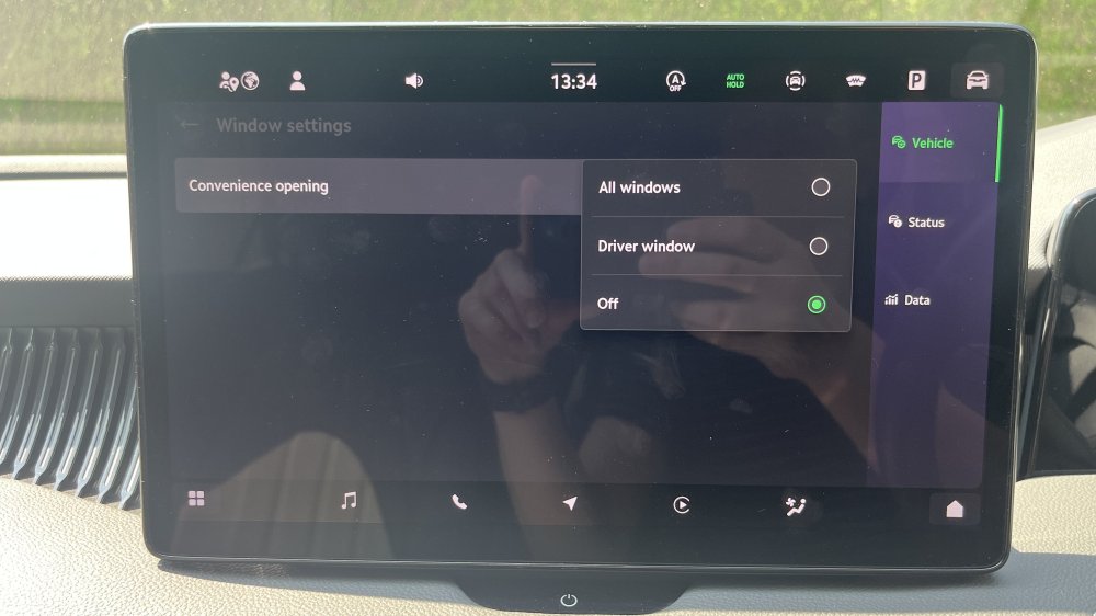

I am trying to find out, is it possible to disable the windows opening from a long push on the key fob, as it seems very sensitive, and I don't want to return to the car and find windows fully down, if the key has pressed against something in my pocket. I know in my previous mk3 super, i was able to do this, but cannot work out how to do it, in my new car.

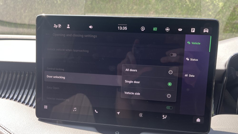

Also, is it possible, when unlocking the car, to have one press of the fob, only unlocking the driver's door, and two presses to open all doors and boot.
Hope someone might have some answers, Thanks.

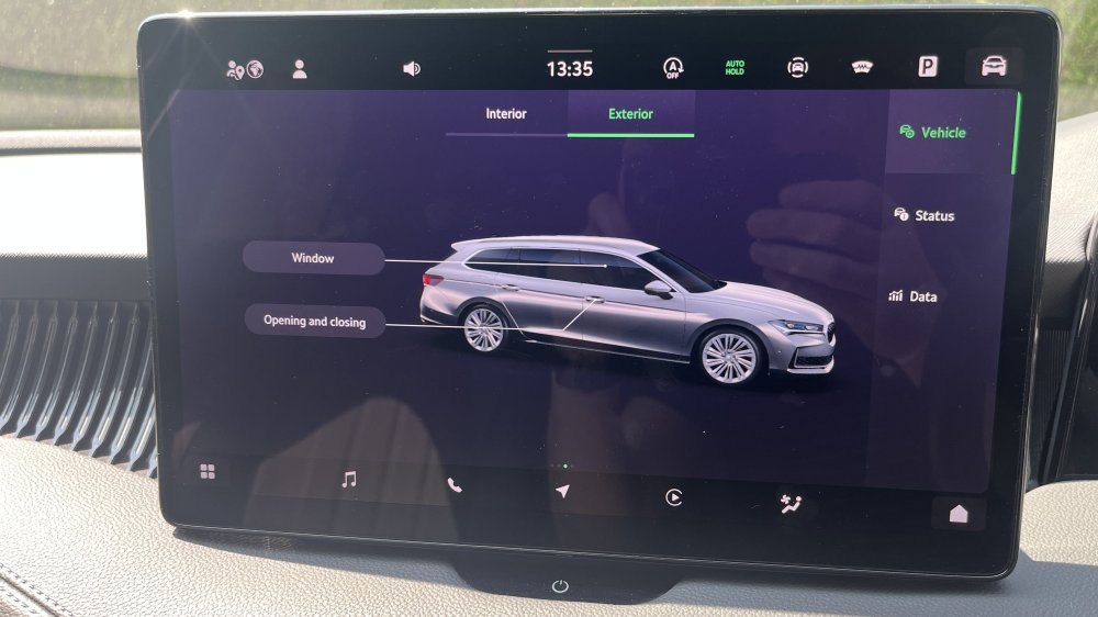

I would assume so, you can do this in the settings on the Octavia
