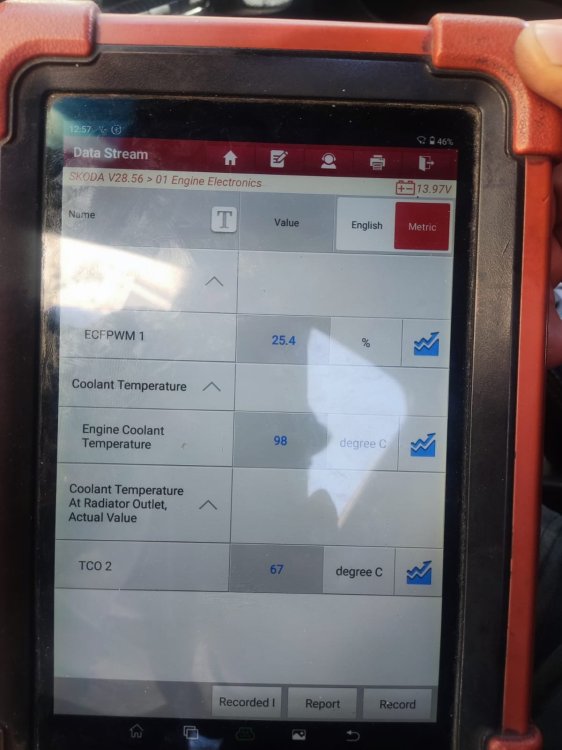

VCDS readings while idling show:
Engine coolant temperature: 98°C
Radiator outlet coolant temperature: 58-67°C
The coolant temperature sometimes fluctuates slowly between 95°C and 98°C.
I also replaced the radiator outlet temperature sensor, but the problem remained unchanged.

There are no bubbles in the expansion tank, there are no coolant leaks, and the oil and coolant are not mixing. The water pump is working. However, when checking the diagnostics, we found that the coolant temperature at the radiator outlet is 67°C, while the engine coolant temperature is 98°C. As the engine temperature increases, the temperature continues to rise, and the radiator fan starts running at maximum speed.
