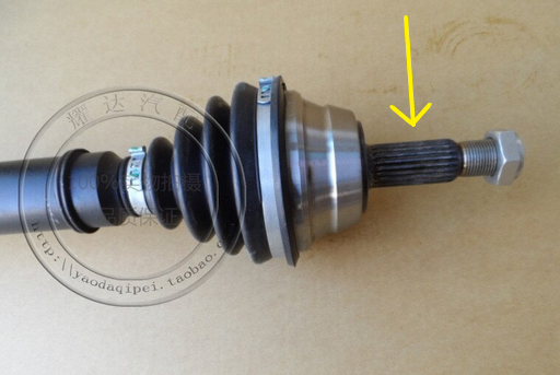

Be aware that if the shaft has never been off before, you might need a puller/pusher to break the bonding that went on it at the factory.
You mean at the hub end? Both hub nuts have definitely been off at the hub end at some point. Never been off at gearbox end.
Or did you mean the bit where the CV joint joins inside the gaiter?

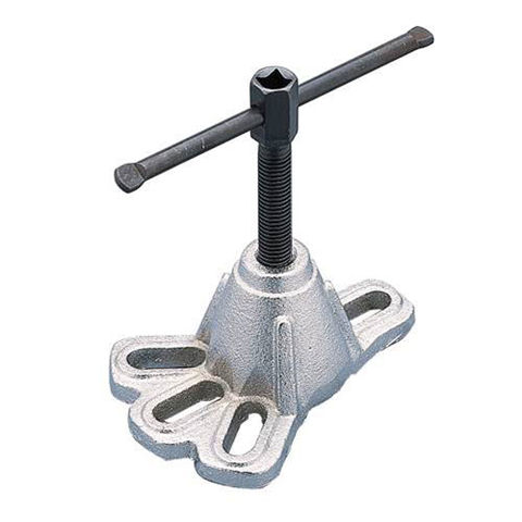

The splines of the CV joint are usually bonded to the hub from the factory. If they have never been off you sometimes need a hub puller as Wino said.
I used one of these from Machine Mart....

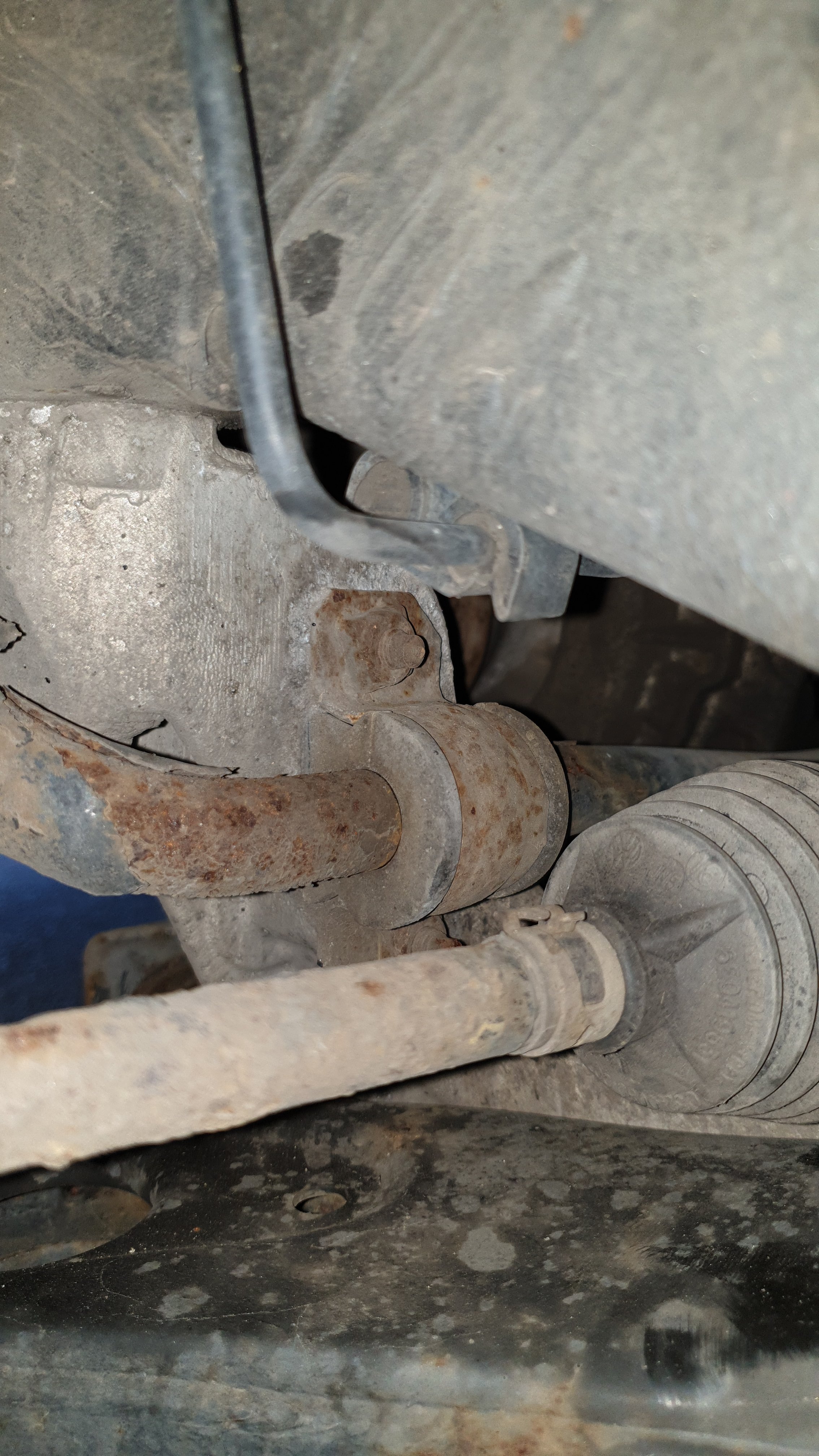

I can't work out by looking at it if it is the one with plastic sleeve or not. Would a metal ridge be in the middle of the bush? There's nothing I can feel behind it.
Edited by anewman

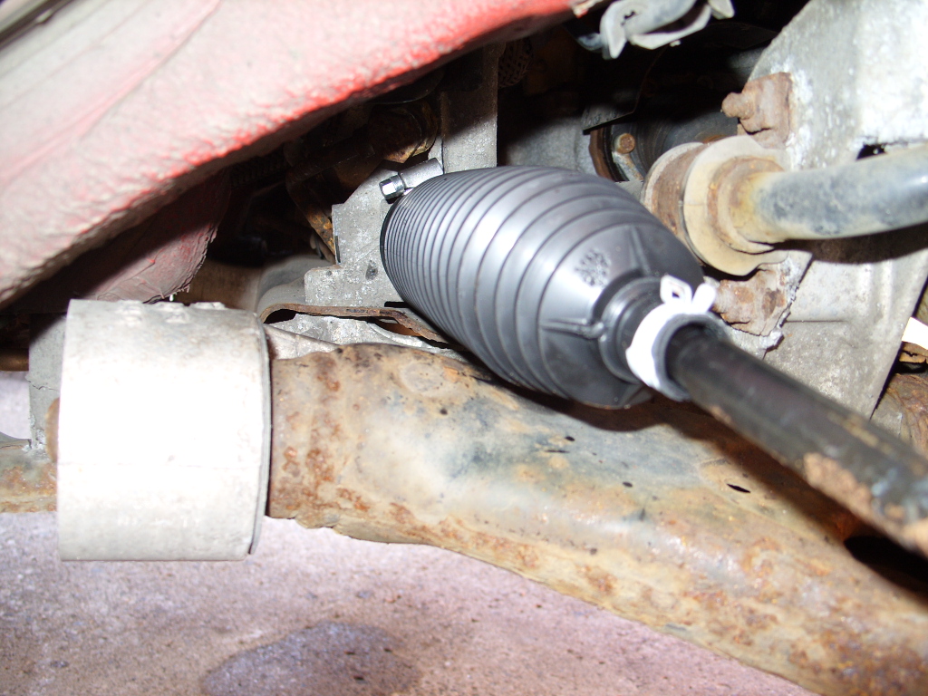

Looks like you might not have them. Mine are clearly visible on the outer side of the bushes....
Edited by TMB

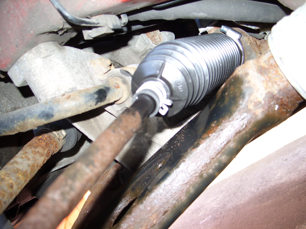

The later versions of these ARBs had a welded stop/washer, and from memory they are located on the "inner" side of the mounting brackets, so you should be able to spot them if they exist.
Grabbing the ARB and trying to pull/push it side to side will let you know if the plastic sleeves have broken loose or have escaped, though if they had escaped then smaller mounting bushes would have be fitted.
I would imagine that if the original plastic sleeves are still in place, you should also be able to make them out in the same positions as the later steel ones, I've forgotten as it was too long ago, maybe 14 years ago!
