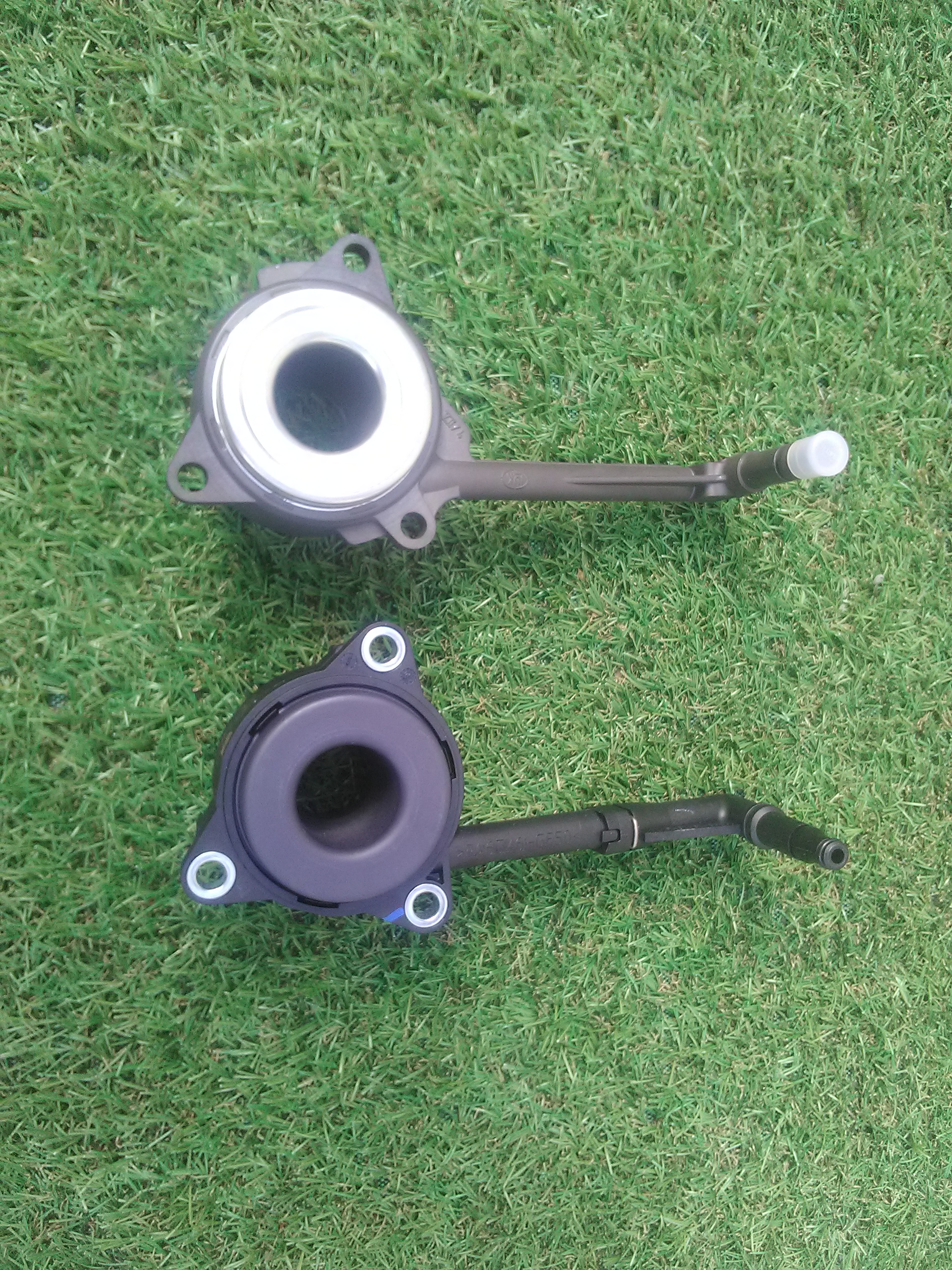

Well things got progressively worse so the bullet had to be bitten, there was only one suspect left, the concentric slave cylinder so it was off with the very heavy 68kg transmission unit and a DMF clutch & slave cylinder change.
Having ordered a new old stock cylinder from Ebay France and comparing it to the latest revision one that came with the clutch/DMF kit I was fairly sure what the problem would be even before tackling the job, the old one was a one piece aluminium casting, the new one was plastic and moulded in two pieces with an O ring sealed joint hidden within the bellhousing.
The connection stub sticking out of the bellhousing could be wobbled around and it turned out to be the joint rotating, the joint on the new part was solid, sure enough the O ring had a flat on one side and had wear marks, it was allowing air to be drawn in despite the head of fluid above it but had not leaked even one single drip, that part remains a mystery.
The thrust bearing was faced with plastic where it contacted the pressure plate fingers and had indentations, I dont think this damage was relevant to the problem but both my new release bearings had metal contact faces.
The DMF had slight wear and the lateral oscillation may have contributed to the indentations on the release bearing or vibrated the fluid joint allowing air ingress, it was silent at low revs as is the new one but at high revs its much quieter, now its a diesel sound rather than a high rev death rattle.
I decided to fit the aluminium cylinder so as not to risk a future problem with a 1ct O ring requiring transmission removal, I think my car may have been originally fitted with an alu cased bearing & that the clutch has already been replaced, some bolts were loose, the starter solenoid connector broken and other indications that the job had already been done by an inexperienced or slapdash mechanic.
Also someone had abused the clutch, pressure plate & flywheel had burn marks, the pressure plate was dished, 1.5mm over a 40mm wide contact face and the drive plate worn thin on the outside only.
The clutch and its hydraulics are behaving perfectly since replacement, also the gear selection is much improved as the counterbalanced quadrant that the cables attach to was loose on the selector shaft spindle (more signs of being worked on), so loose that the spline would soon have stripped and I would have lost all gears
