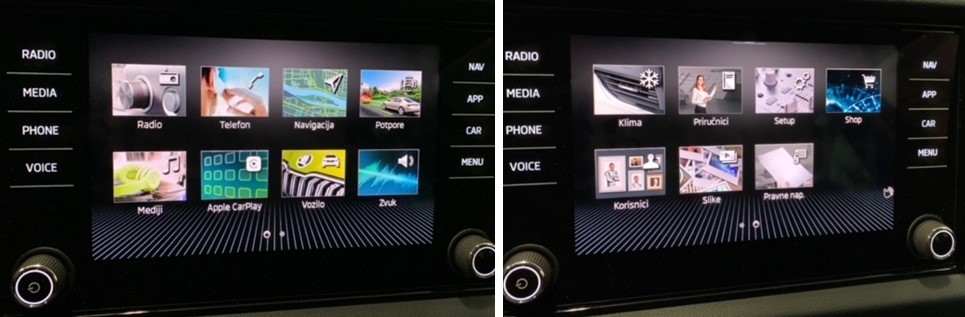

What I do not understand is why I am not seeing Skoda Connect icon in the MENU options of my Infotainment.
This is what is available when I choose MENU in my car:

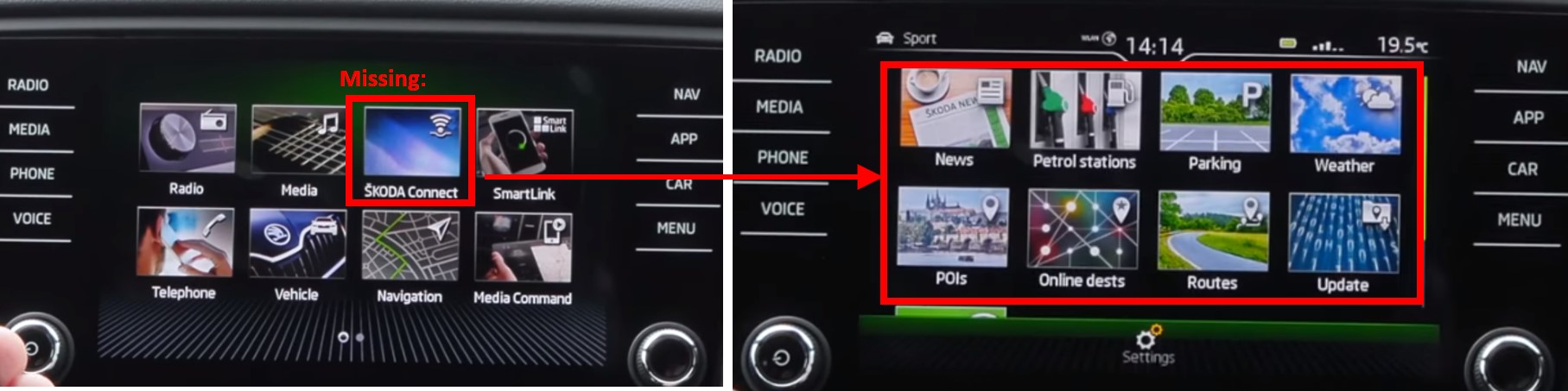

And this is what I think I am missing - Skoda Connect icon - which then gives me options for News, Weather, POIs, Petrol Stations, routes, Parking, Online Destinations and Update:
Is all these (except News and Weather of course) now just simply integrated in NAV (as I do see them there in the maps) without a Skoda Connect as a separate option to chose in MENU, or should I have this icon nevertheless?

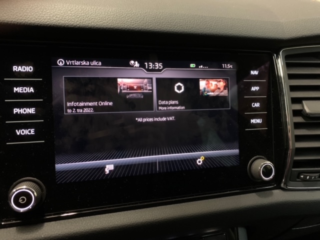

Interesting... I am not even offered News or Weather app in my Shop. When I enter my in car Shop I am only shown the list of already subscribed services and their short description including their exparation date info, without any options to buy new content. I just assumed that News and Weather are free of charge when you are subscribed to Infotainment Online. Guess not.
Can you maybe share a photo of how your shop looks like and where can you choose extra apps? Wonder where you would access them if purchased, considering there is no Skoda Connect Icon in the Menu just like in my case...

The upper pictures are MIB 3 headunit.
The lower ones are MIB 2,5 (discontinued).
Oh, great, that is the useful information, glad to finally get to the bottom of this.
It is not documented anywhere so I appreciate you shedding some light to this.
Do you know maybe how to access Infotainment Online apps on MIB 3 then (when they are available depending on region and when they are purchased) and/or other options that were available inside Skoda Connect menu on MIB 2.5 (as seen on the bottom right picture from the first post)?

This is mine Shop look:
As you can see, I don't have any of the items shown like you do, only Infotainment online and data plans.
