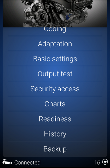

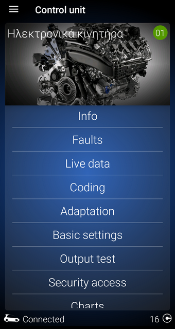

I tested today mine, i will post some screenshots but you will be disappointed as i did.
Here is the Menu of OBD11 for the Felicia.

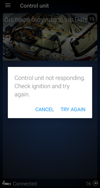

When i tried to get inside for more details i saw this:
I try for 2nd time and i had the same results.
As for curiosity while the unit was attached i turn on the ignition but the car immediately started to idle badly so i turn it off.
I don't know if there is a way to make some adjustments but i am not optimistic compared to a laptop-Vcds.
