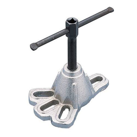

One of these from Machine Mart worked well on mine....

It's best if you leave everything assembled. Just remove the driveshaft nut and use the puller to start the driveshaft moving, then you can remove track rod end and bottom ball joint bolts. That way the hub is held solid while you get the driveshaft moving.

 I noticed the Clarke one Machine Mart sell has some similar negative reviews on Amazon too, which is why I went with the cheap one.
Not had a problem myself but maybe I was lucky.

I've got the same one you have anewman, but it did splay out in use, would be better with some normal bolts that would sit down flat across the slots, where radius seat wheel bolts will only touch at a pair of points either side of the slot and allow the thing to distort under load.
I managed to squeeze it back into the original shape in a big vice, then acquired such bolts for next time (which hasn't happened yet).

@TMB's one looks a better design, and good value.

Any puller with a standard angular thread form like that is a toy, it should have a square thread.
An exception can be made on a hydraulic puller as long as the thread is a large enough diameter to resist the hydraulic load and the thread is only used for taking up the slack before using the hydraulic tommy bar to create the force.
