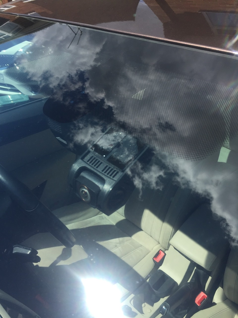

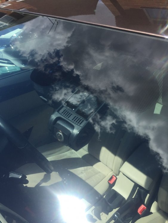

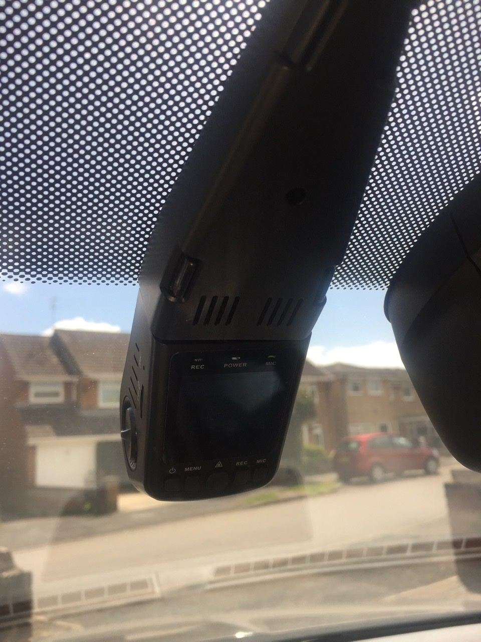

Sorry about the photo quality, but this is my dash cam.  It’s the second car with DAB it’s been fitted to, it just about killed the signal in my new Lexus, but it’s perfect in my 18 reg SE L Octavia 1.4 TSI.
Not being very helpful, I know, but I can’t see any brand name on it, and I bought it in 2015.
The reason for posting is that it’s not necessarily just the camera at fault.
