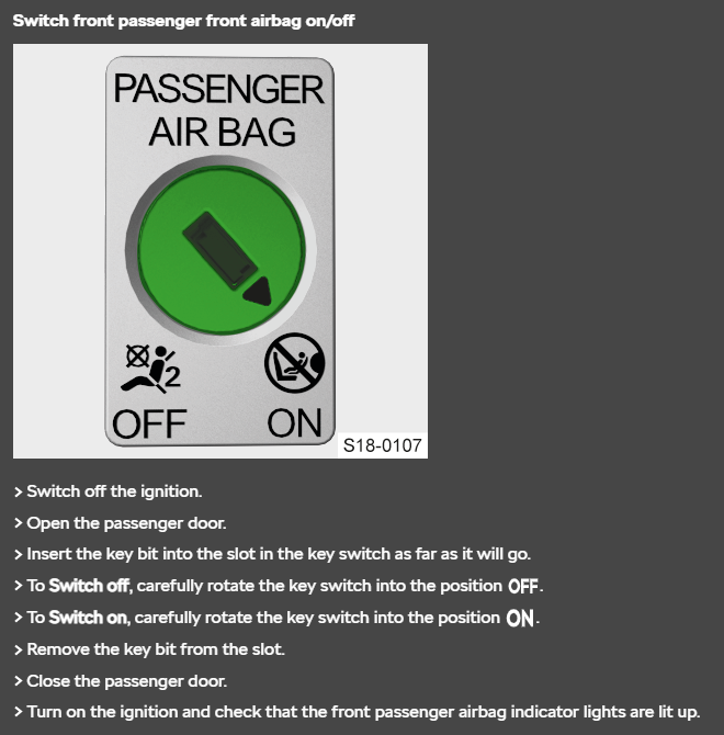

Just got my Octavia Wagon iV last week. I noticed the next day the passenger airbag off yellow light was always on.
As others have suggested in this thread, check if it has been manually disabled. See extract from user manual below. If the arrow is pointing to "ON", you should have it checked.

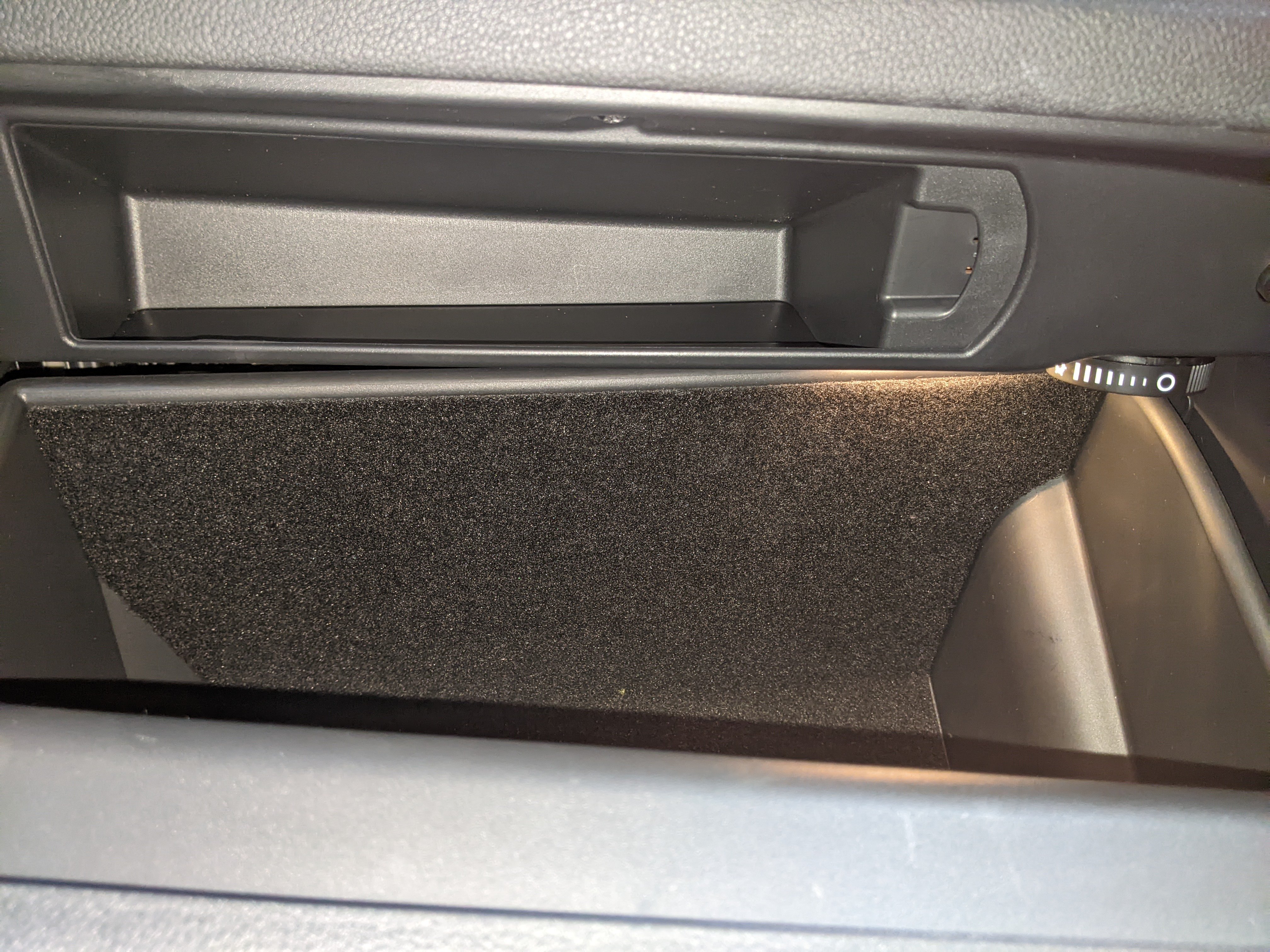

I have looked at the car and I cannot see where the key switch is.
Can someone post a photo that would help me?
Inside the glove box.
No photo needed.

Not in my glove box.
See, I said that a photo would not help you 😆
Guessing now, if its not there then somewhere on or in the centre console?
On the glovebox of a RHD vehicle its tucked up to the top right on the front return edge of the frame and not really visible to the driver from the drivers seat, but that could be because I am blind in the left eye.
I don't see it anywhere in this picture.
Nor in the A pillar, as suggested earlier in this thread.
