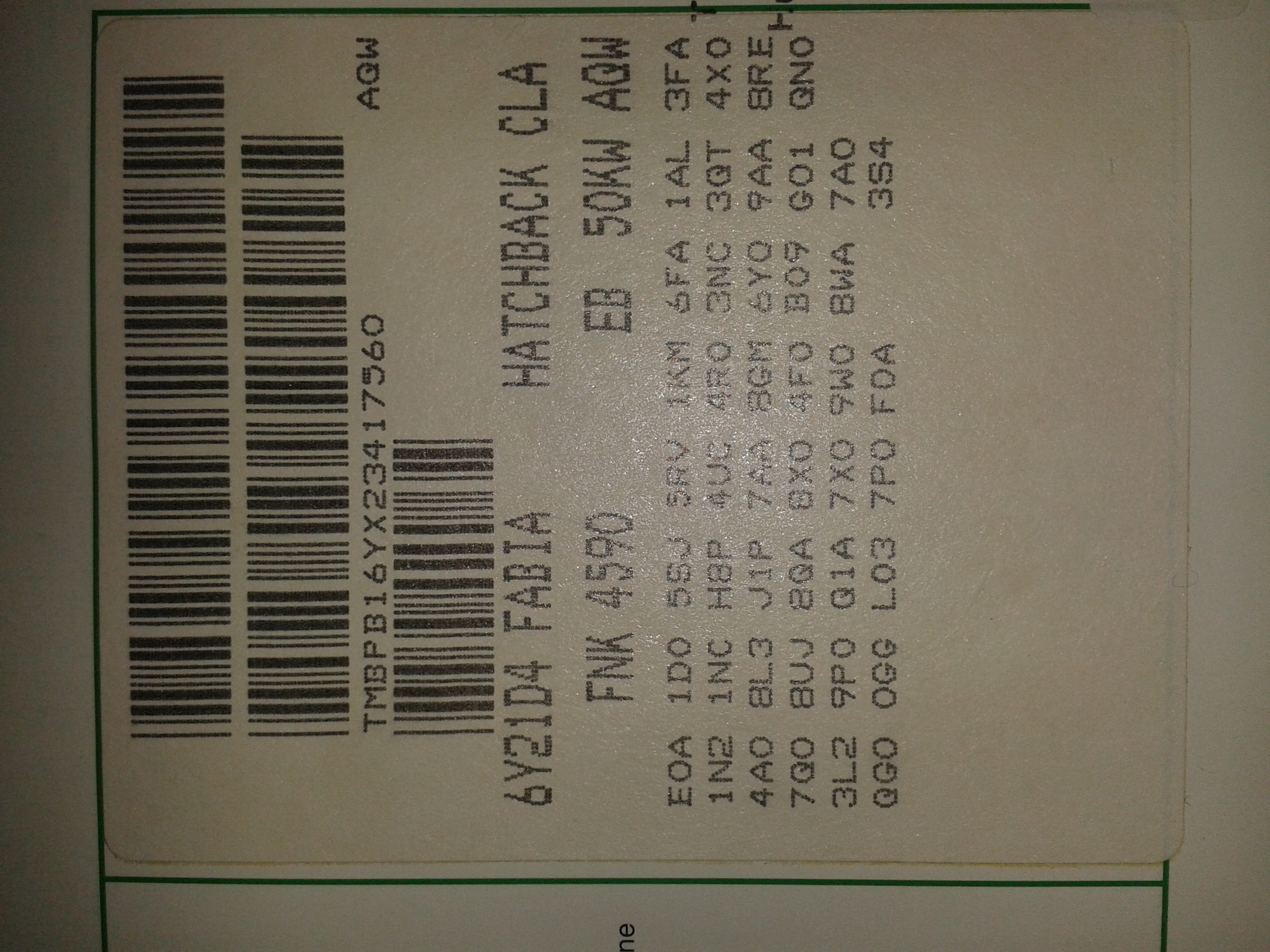

Thank you for trying to help me. It had a new alternator recently and timing belt change. This was done by the previous owner prior as he knew it needed doing and agreed to our purchasing it. We know it is new. We have only done 200 miles over 2 weeks. We were only on a short journey across town when the battery light came on but went off again but there was a burning smell and whirling sound We stopped to take a look but decided to try to get it back home. The alternator was really really hot. We are wondering if the alternator is wrong. We did a multimeter check on battery which was 12 whilst not running and 14 when running so we don't think it is the battery not taking the charge. I thought to check which is the correct alternator. The person who sold the car is thinking that the alternator is faulty but it might be that it is the wrong one. Will the attached file help someone determine which is the correct alternator please.

The code 8GM on that sticker suggests that the factory original alternator was 70-Amp rated.   I would have thought that anything that fitted correctly would work though, unless faulty from new.
Thank you, I will find out what this alternator amp is.

AQW engine has no timing belt, so it must mean the timing chain.
Basically if an alternator physically fits correctly it will work, I'm also guessing that the auxiliary belt was replaced at the same time since that engine doesn't have a timing belt.
