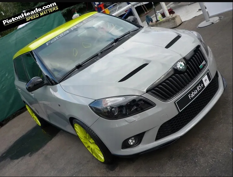

Does anyone knows who can supply and fit this vents . I’m based in London but I will travel around 100miles .
sorry because I stole one of your photos .

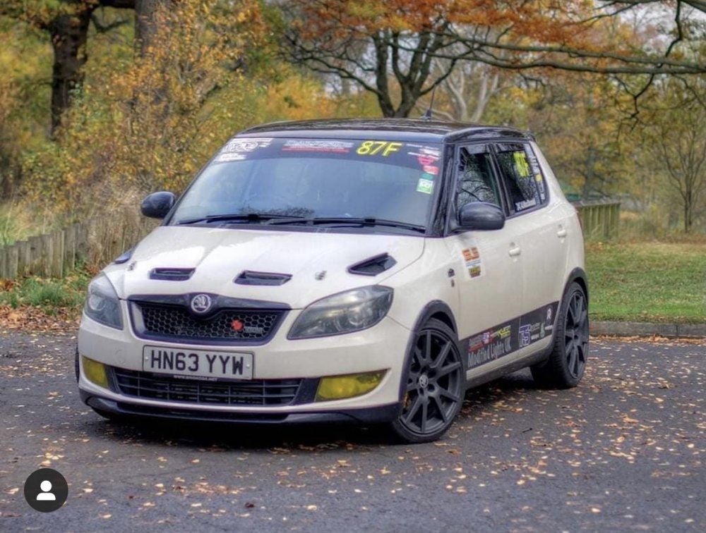

Thats an S2000 bonnet. For a Fabia s2000 rally car. I'm pretty sure @32KOFDATA managed to get his s2000 bonnet used off an actual rally car.
Yeah it’s a S2000 bonnet direct from Skoda. Not cheap :sweat: and you need to go through an application process which goes to the head of Skoda motorsport to decide if they want to sell to you or not too

A proper s2000 bonnet is 4kg lighter than the standard bonnet. Was yours bought for the weight reduction aspect or the ventilation?

id be amazed if it was 4kg of a difference. Mostly ventilation as I was having issues with oil temps but now I have the issue of it running too cool so the cooler is taped up mostly 🤣
