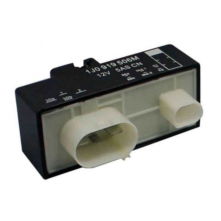

The ones that look like very thin cans?  if all check them and they are correct, disassemble the relay module that handles the ignition of the fans (I send a reference image) and I just tested them and it works, I also checked the voltages on the lines and they have 12v but I have no negative,  I think this comes from the thermoswitch that is on the radiator when the coolant reaches the temperature (you say it must be 96 degrees) definitely when the car is hot there is no negative signal either

Now I'm on a big screen I can say that if the car has A/C then battery fusebox fuse 9 (5 Amp blade fuse) supplies an ignition switched 12V to the fan control module (pin 1 of the 6-way connector).
Battery fusebox blade fuse number 8 (30 Amp) powers the low speed fans' function via one of the fan control module's relays, in on pin 3 of the 4-way connector, out on pin 2.
Strip fuse number 3 (40A) powers high speed fan function via the other relay inside the module, in on pin 1 out on pin 4 of the 4-way.
Earth connections to both fans are directly from the 3-way rectangular connectors nearest the fan motors, to a chassis earth point nearby.
