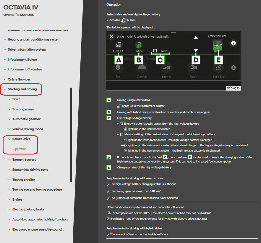

I did find a page for it in the online manual:
https://manual.skoda-auto.com/210/en-gb/Models
Sadly I've not worked out how to link directly to the manual page (when I try to copy and paste the URL, I get a page in German which looks like it's asking for a user name and password), but I've tried to attach a screenshot. Note the warning that changing the desired battery level can lead to increased fuel consumption.
OctyIV_Manual_202011_ControllingBattery_SelectDrive_Screenshot 2021-05-23 103334_a.png

E root...The battery was flat on Red and mileage was 10 miles which was on the factory invoice..    David,    brilliant very helpful finding that page    also   Jim      I will set it as you suggest    thank you..  I will go for a rest drive tomorrow and test it out thank you so much for the help...Its a lovely car...

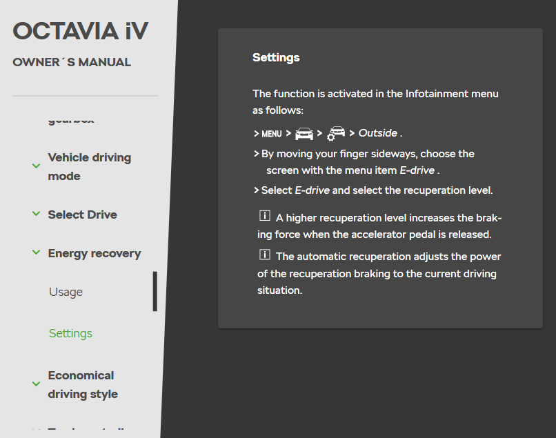

5 hours ago, Jim2015 said:
I have the regeneration set to 2, ie maximum. This recharges the battery when coasting and it will hold the car back on hills and keep to the speed limit. If you watch the amount of regen (LH display) you can adjust the amount of regen on hills so you don't slow too much whilst stll regenerating, with a light touch on the accelerator as needed. On a 3-mile slope in N Yorkshire it added 0.6 kWhr.
I assume this is controlled from the setting described in the manual as per screenshot below?
There's also a mention of an automatic recuperation mode - is that linked to the "Eco Assist" which is mentioned? And is it standard on UK iV models?
(I did see a video of someone testing a vRS which had it, I believe in the UK.)
My current diesel MK3 Octavia has a "Coasting" feature built into the DSG which (as I don't have the beauty of North Yorkshire hills where I am) suits the rather flatter local roads quite well. It will coast for long distances without using the engine (which is the best use of energy), so I probably wouldn't want to have the regen set to maximum all the time, but I would want regen to kick in when a junction is approaching for instance.
OctyIV_Manual_202011_ControllingRecuperation_Screenshot 2021-05-23 182441.png
Hello David Y. The automatic recuperation was set when I collected the car and it provided some resistive braking. However when I set it to maximum, it was far more effective in our hilly part of the UK.  It holds the car back on hills and in fact I use fine touches on the accelerator to keep the speed up whilst still regenerating. At junctions. I hardly need to use the brakes except at the last minute, so it's very effective. In your situation, with flatter roads, auto would be preferable.
