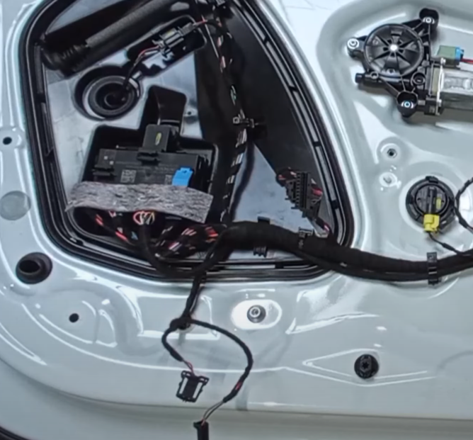

Hello,
Does anyone know what are the pins in the Front Door modules for 12V+ and GND for the ambient lightning?
Thanks in advance!
You have to connect to J387?

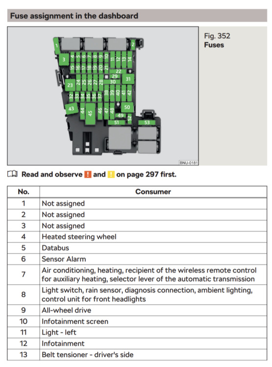

Hi, mayb you can share info where exactly going all wires in door please, or i need take + and - to fuse box? And lin cable going to BCM? Thank you.
