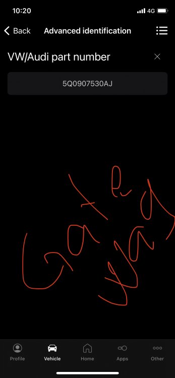

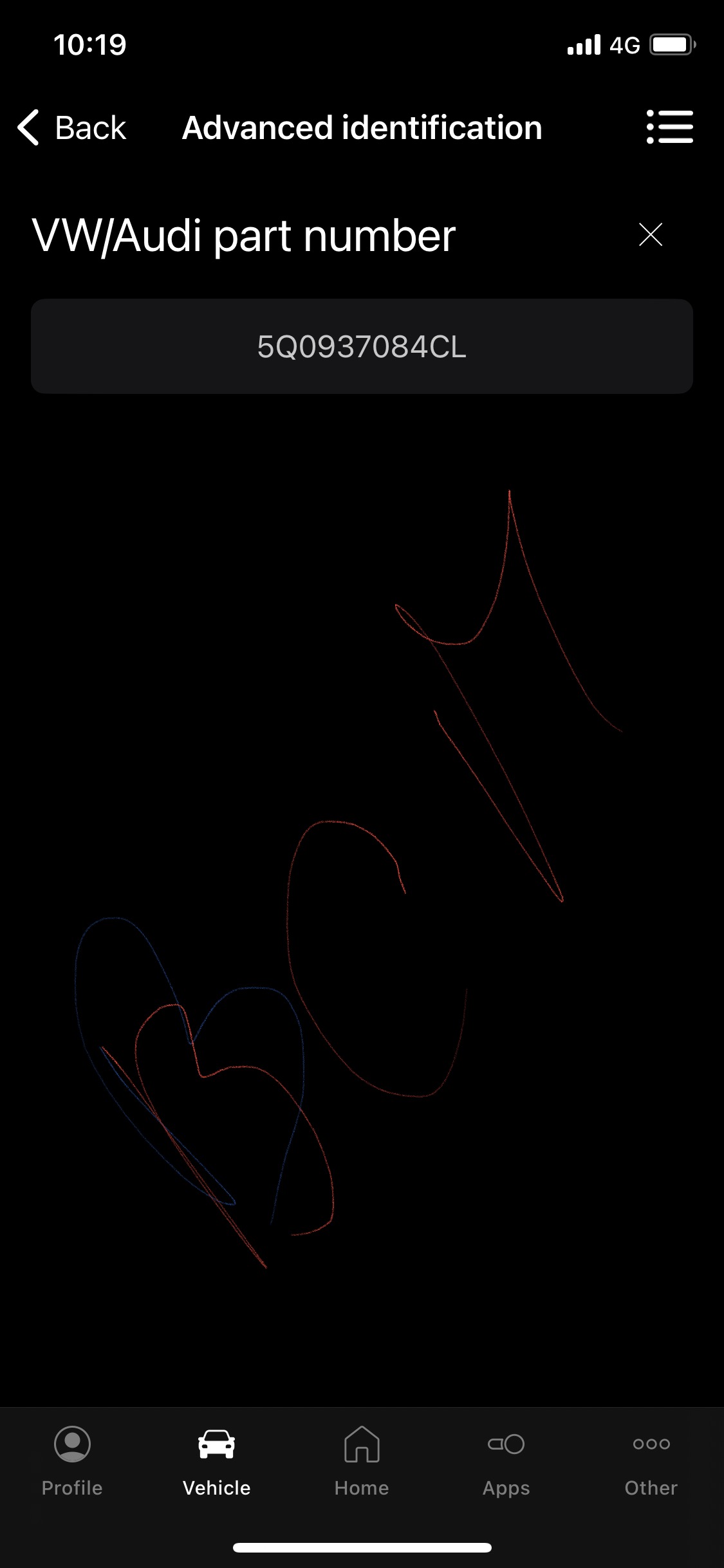

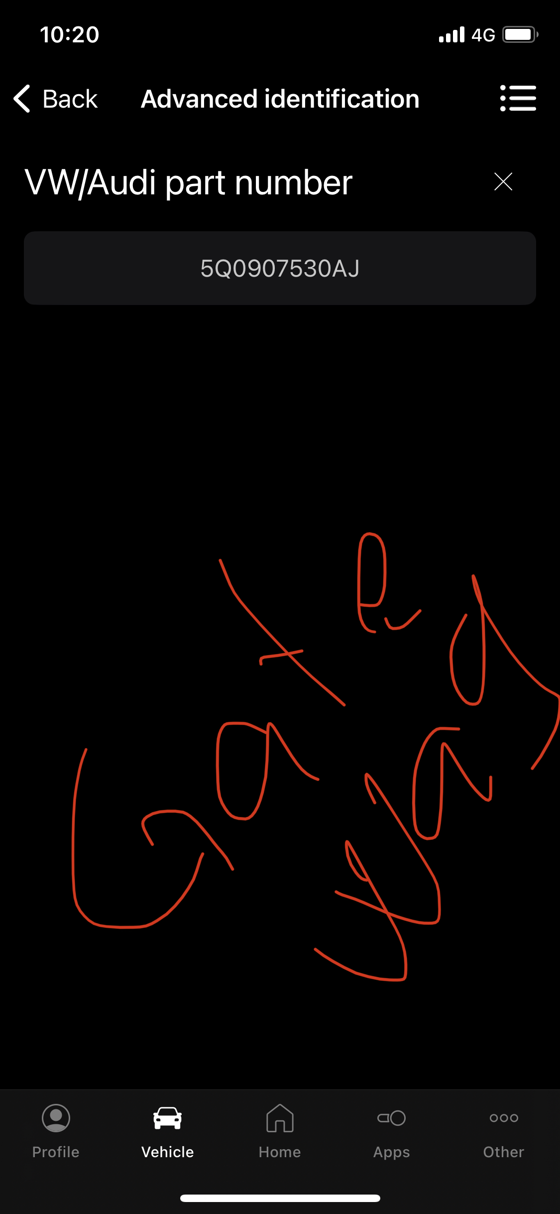

I gotta admit, that looks awesome, any way, acording to OBDeleven scan these are the part no for the BCM and Gateway. I'm a bit confused but I wouldn't mind upgrading both as it was sugested before by our friend in north London.IMG_4366.thumb.JPEG.97bced84b2cc5f270d54241785499d13.JPEGIMG_4367.thumb.JPEG.8cb6863fcaa7da95fbf3131ab02f0a5b.JPEG
I used OEM as well. It’s not too bad to do but if you have a 086 BCM like mine there’s not an independent footwell light dimmer for the colour changing lighting so I had to wire it to the dash strip for dimming.
Not sure about that BCM. If you have MY18 with the lighting on the screens try coding it and if the menu appears and the screens change colour all will be well.

The VC and MIB 2.5 was an upgrade by our friend in London. and he said if I needed the view button on the steering weel I  need to upgrade the gateway as well. Don't really know about the BCM so I presume I might need to upgrade them.

You need to add the power to fuse slot 8, ground, and LIN which is pin 29 connector C in the BCM. Gateway needs changing to 3Q0 for the VC extra views etc. BCM will need flashing to a newer firmware to do the lighting on the screens but it may work in the doors. Have a code and see what’s there.
