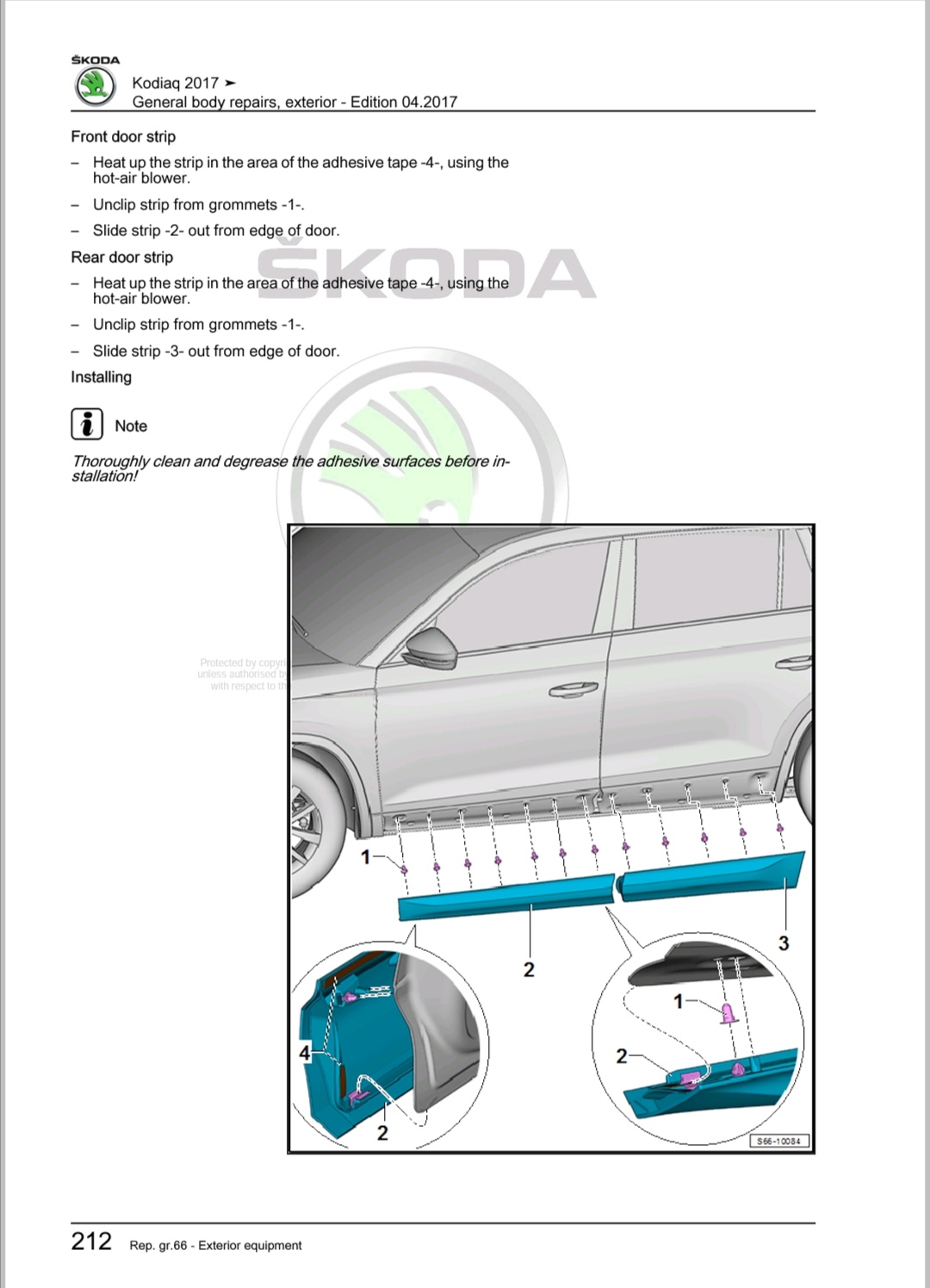

Momentary laps of concentration resulted in V badly scuffed drivers door lower plastic trim guard.  (Could be a whole lot worse)   Have ordered new.
Can anyone point or give guidance on removing the old one.??

The workshop manuals are available on here. You want pages 211 to 213 of the 'General body repairs, exterior' manual. And a good hairdryer, by the look of it!
Teir ... Thank you so much, i looked but clearly not enough to locate, I found the interior trim guide.... shakes head. This is perfect.

sorry dude i am yet to do this task as i have been unwell and recovering from knee surgery, seems fairly straight forward.... famous last words, however next door had a mobile mechanic visit  to quote a job and he said it was simply unclip clean and attach new, warned some of the poppers may brake so a trip to auto part store could be needed, warned to be sure to put on with side clip first as per the diag, pics will follow.... says with right trim popper being cautious with paint etc its a ten min job.... 2hs  the dealer quoted......
