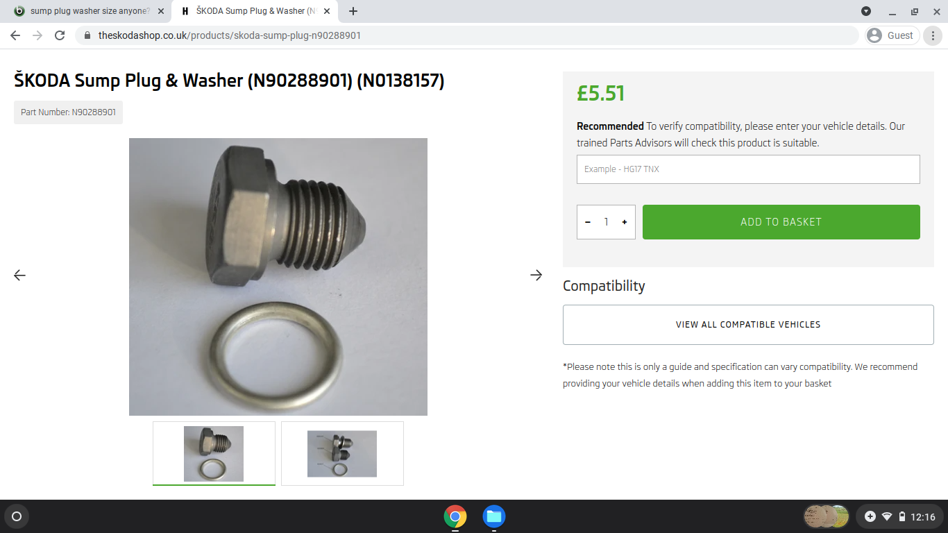

Can anyone please advise the dimensions of the sump plug washer for my 2017 Citigo? I have found the part number, which I thinks N0138157 but hits on google come back with different sizes for the washer. I need the internal diameter and material if possible. I've always used copper washer in the past (crushable, which seem good. I don't want to use the main dealer because it's a bit of a trek, but also don't want to pay £3.50 for something that should cost pennies.
On the other hand is it worth changing the sump plug as well ( not something I've ever done before with any car). The tightwads don't even include a sump washer with a new plug I notice.
IMO it is well worth getting the New Sump Plug & washer @ £3.50 or less.  That is not what a washer costs.
Thanks for the suggestion, I appreciate it. I don't really understand why a sump plug, which has been undone twice so far at the most, should be replaced. Are they made of chocolate? Never known it before and I've done oil changes on many of my cars
If it was you personally that did the draining and refitting of the sump plug the 2 times then maybe you know it is perfect, if it was not you then why skimp on £3.50 or less.

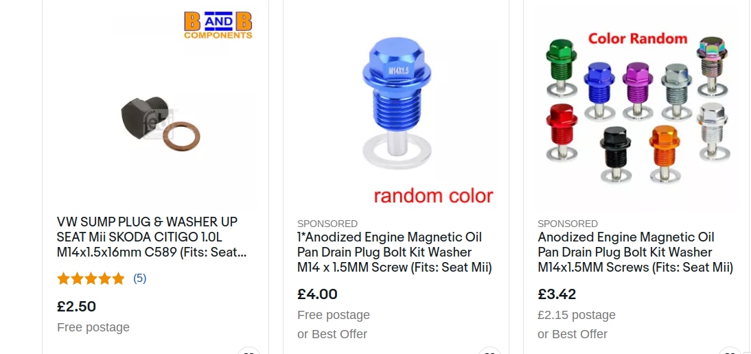

For anyone interested in this, I used a 144 i.d copper crush washer from Eurocarparts - cost 69p instead of the £3.50 aluminium washer from the main dealers. It seems to be working perfectly. Link...https://www.eurocarparts.com/p/sump-plug-washer-single-14-00-x-20-00-x-2-00-333771251 It doesn't seem like much of a saving, but I hate buying anything with a ridiculously inflated price. They probably cost main dealers pennies. Savings across the board for my service, using Mann filters, NGK spark plugs and Millers fully synthetic long life oil consisted of a total servicing cost of £65, against the £300 - £319 the main dealers wanted.
A Washer from a Main Dealership should never be £3.50.
The Invoice for a replacement Sump Plug with a washer shows it as under £3.00 then there is 20% VAT.
