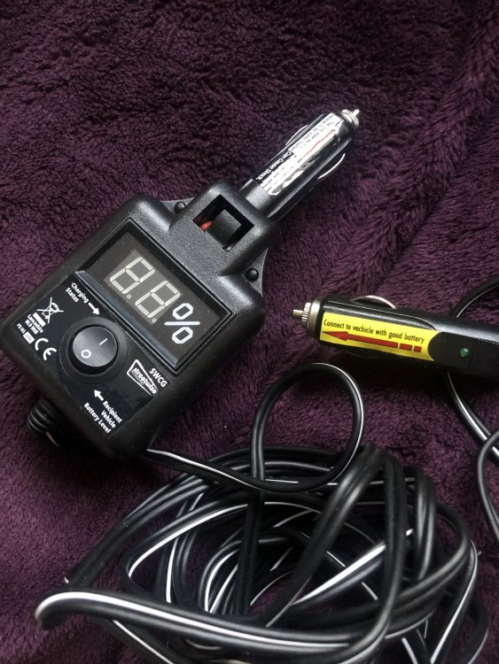

Got this device for changing the battery through cigarette lighter socket on both ends. After 10 minutes I lost my patience and went for booster cables.
Expecting a connection like that to charge a battery in 5 minutes is somewhat optimistic and impatient, I guess you wont be an EV early adopter!
Its good that it has a readout though.
