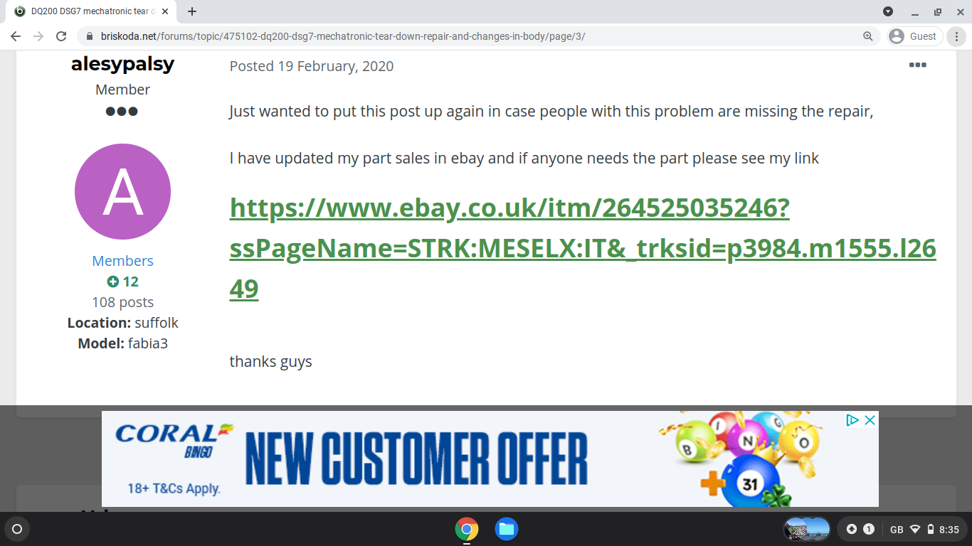

Phiil -E mentions a kit available for accumulator split - any part numbers please?

No idea if the member is still selling the part, but before buying anything find out what the fault is.

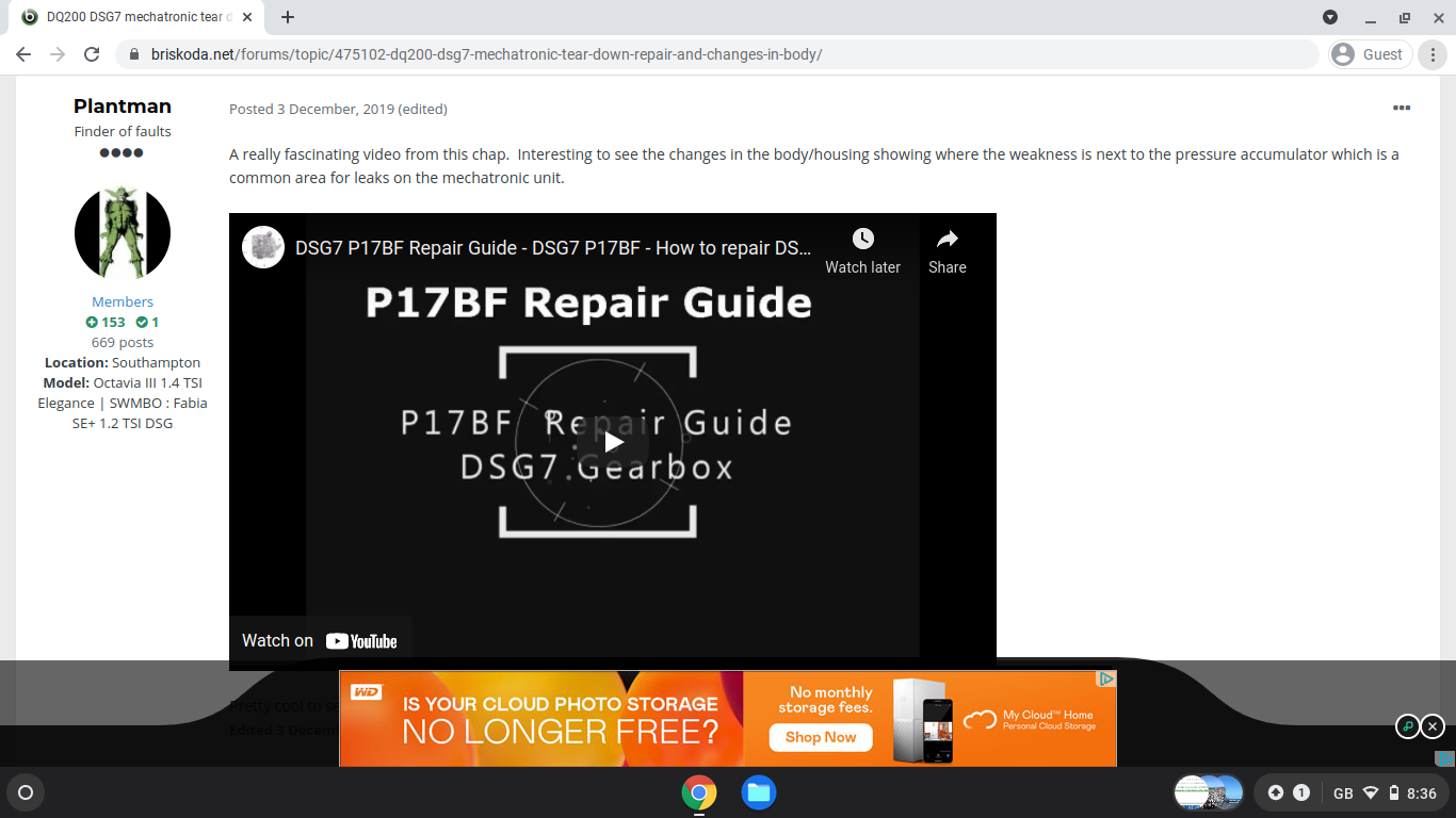

Looked under the car and there is oil leakage. So assume it is the Mechatronic unit failed. Problem is I can't drive it. Will attempt to get a better look at the unit tomorrow. I assume leak means repairing the Mechatronic.

Try and have a look at the top of the gearbox towards to right hand side. Underneath the starter motor wiring should be a small black breather. Look for signs of a leak coming from there.
Is the fluid green?
The Mechatronic unit has leaked, colour looks green. I have been reading  and watching videos. It is mentioned that the replacement Mechatronic unit needs calibrating using the VCDS system. I do not have access to this
regards
Paul
If it has leaked out of the breather on the top then it's most likely the accumulator that's cracked.
And yes VCDS (or something capable of accessing and controlling the DSG controller) is required.
Not sure if it's needed if the mechatronics is to be repaired though.
