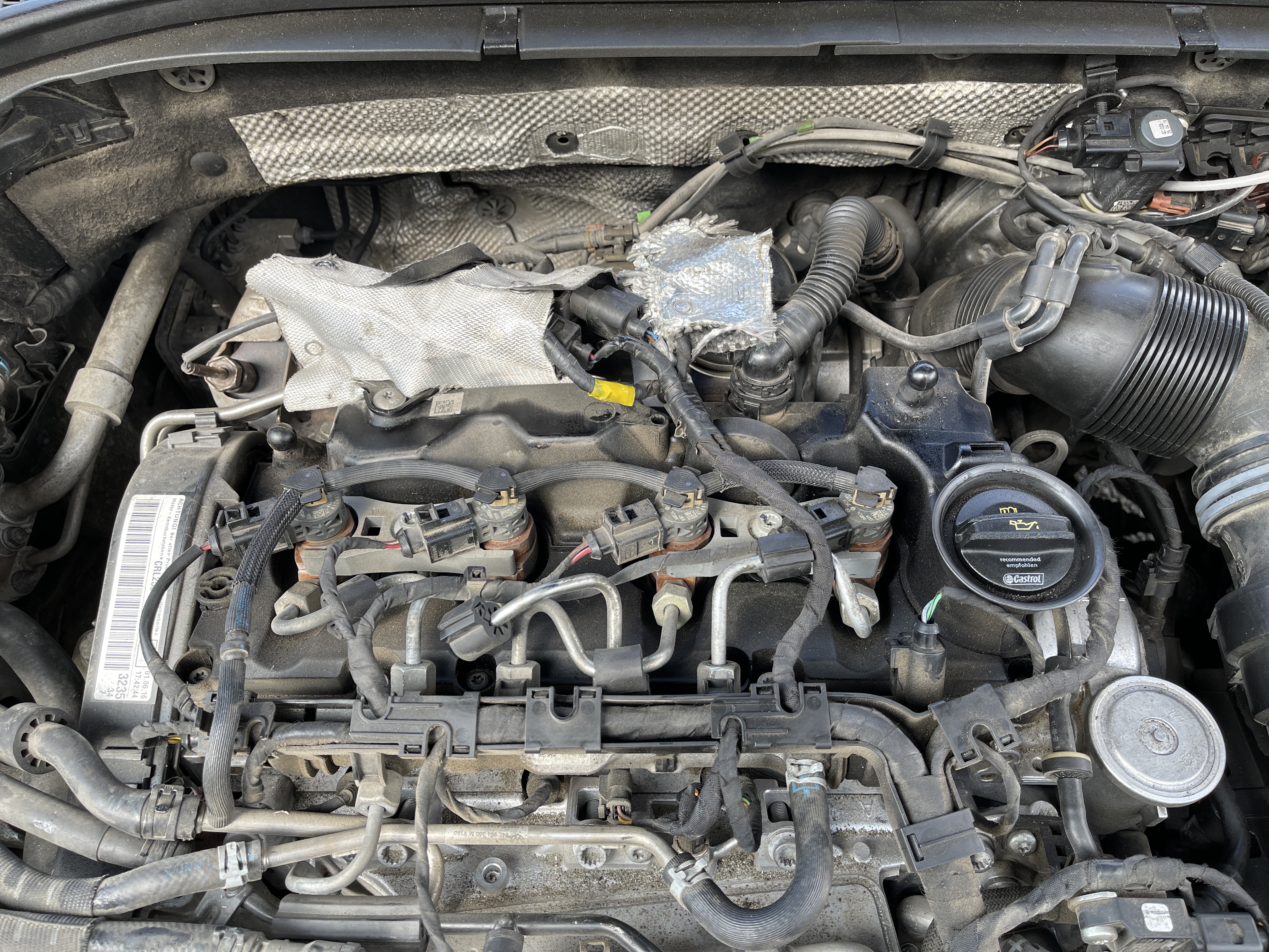

Does Anybody know which one is injector 1.2.3.4
numbered from timing belt to flywheel. 1 is far left in pic, 4 is beside oil filler cap.
What about 2 and 3
It runs in order. 1 then 2 then 3 then 4.
The injector numbering should not be confused with the firing order of those injectors though.
But if you have a scanner saying injector ? faulty, then *1 is first from left, *2 is second from left, *3 is third from left, *4 is fourth from left.

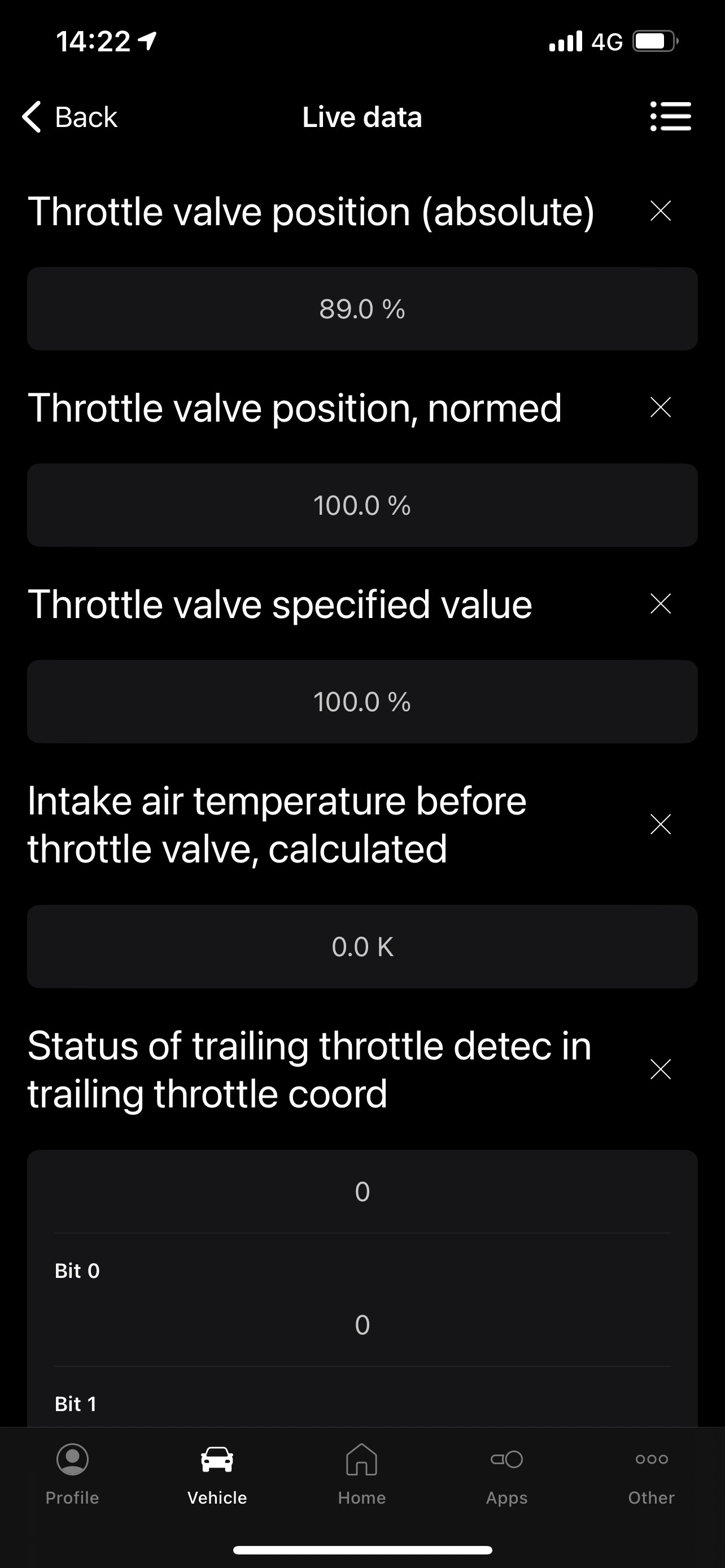

Also it has a high idle starts at 750 then runs at 1000rpm do u know what it might be
Is it idling or does it think there is throttle input. Ie does it recognise the throttle in this 'new' car is 0%.
I recall several values regarding this in obdeleven. No idea if / how you can adjust the offset though.
Should I check the throttle input ignition on or engine idling
Sorry, no idea. If it was an old fashioned dellorto it would be the idle air valve with the throttle closed- but it's not.
Maybe see if the throttle shuts to 0% but im guessing! So many variables.
Premably in a diesel the throttle adjusts fuel flow? Im far happier talking petrol engines.
Good luck.
check and see if the system is holding vacuum pressure.
I have access to vcds should I have ignition on and check the throttle or
This is with ignition on engine not running
