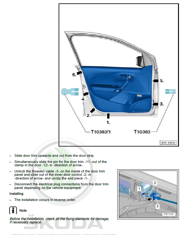

I need to get at the electric door window driver but I cannot see an obvious way of removing the panel shown below. Can anyone help me out please?
(I have obtained a set of trim removal lever tools)
Thanks
John

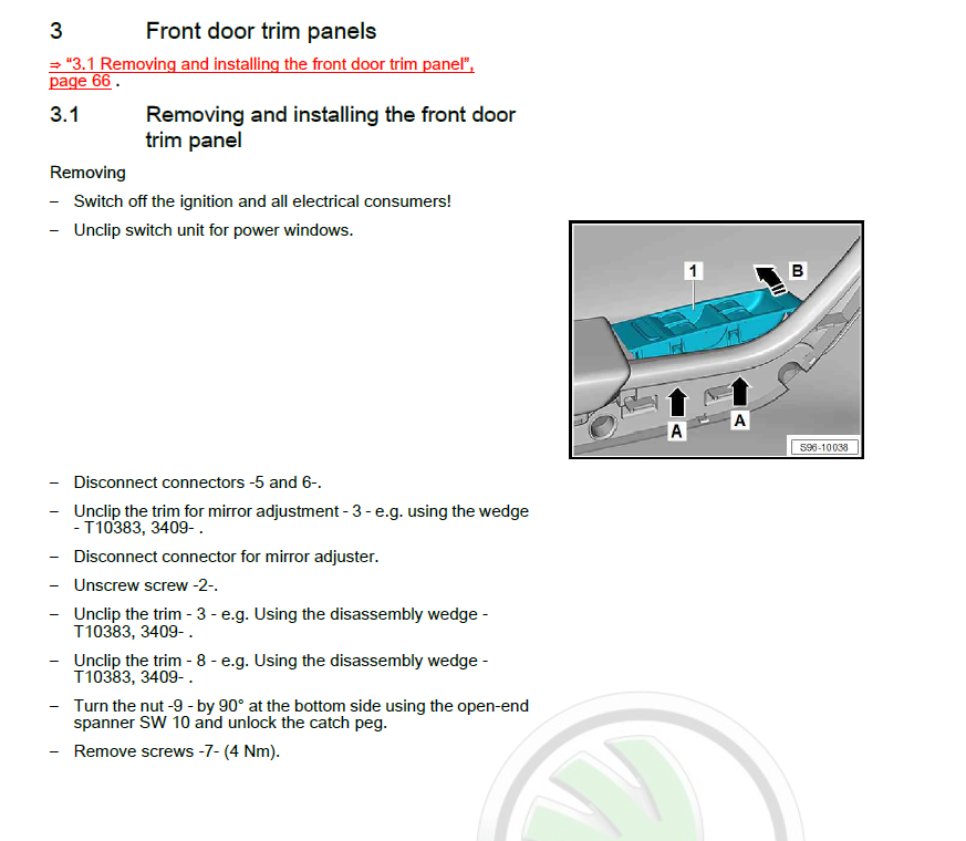

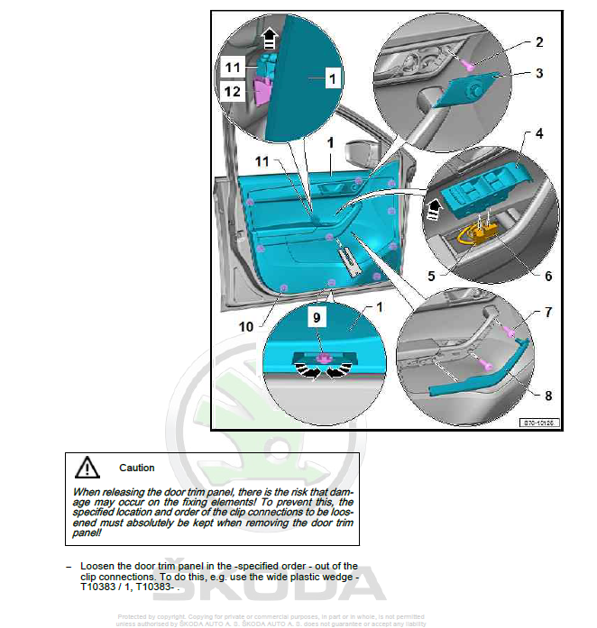

Hi,
THanks for the 'how to'  pictures.

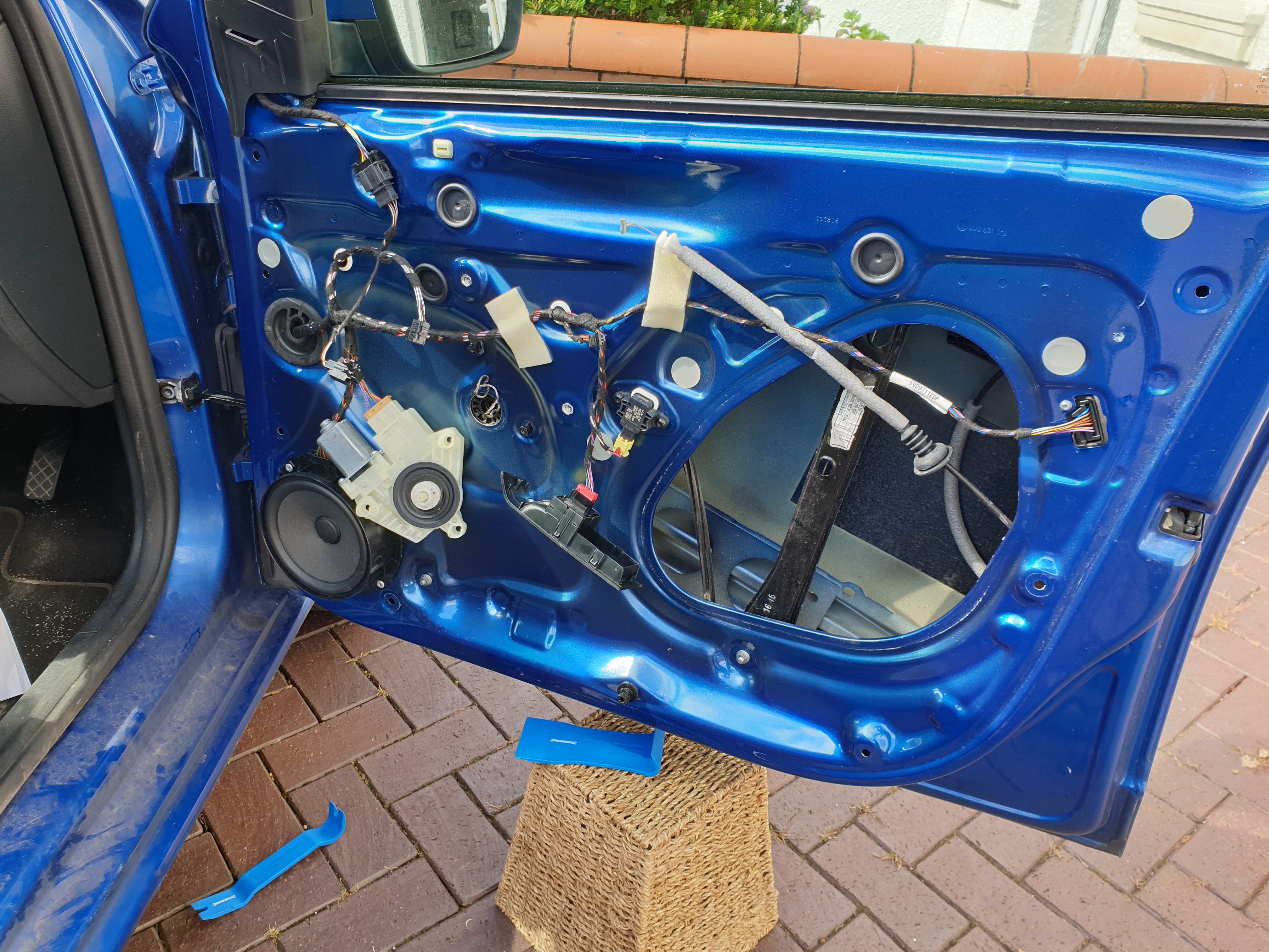

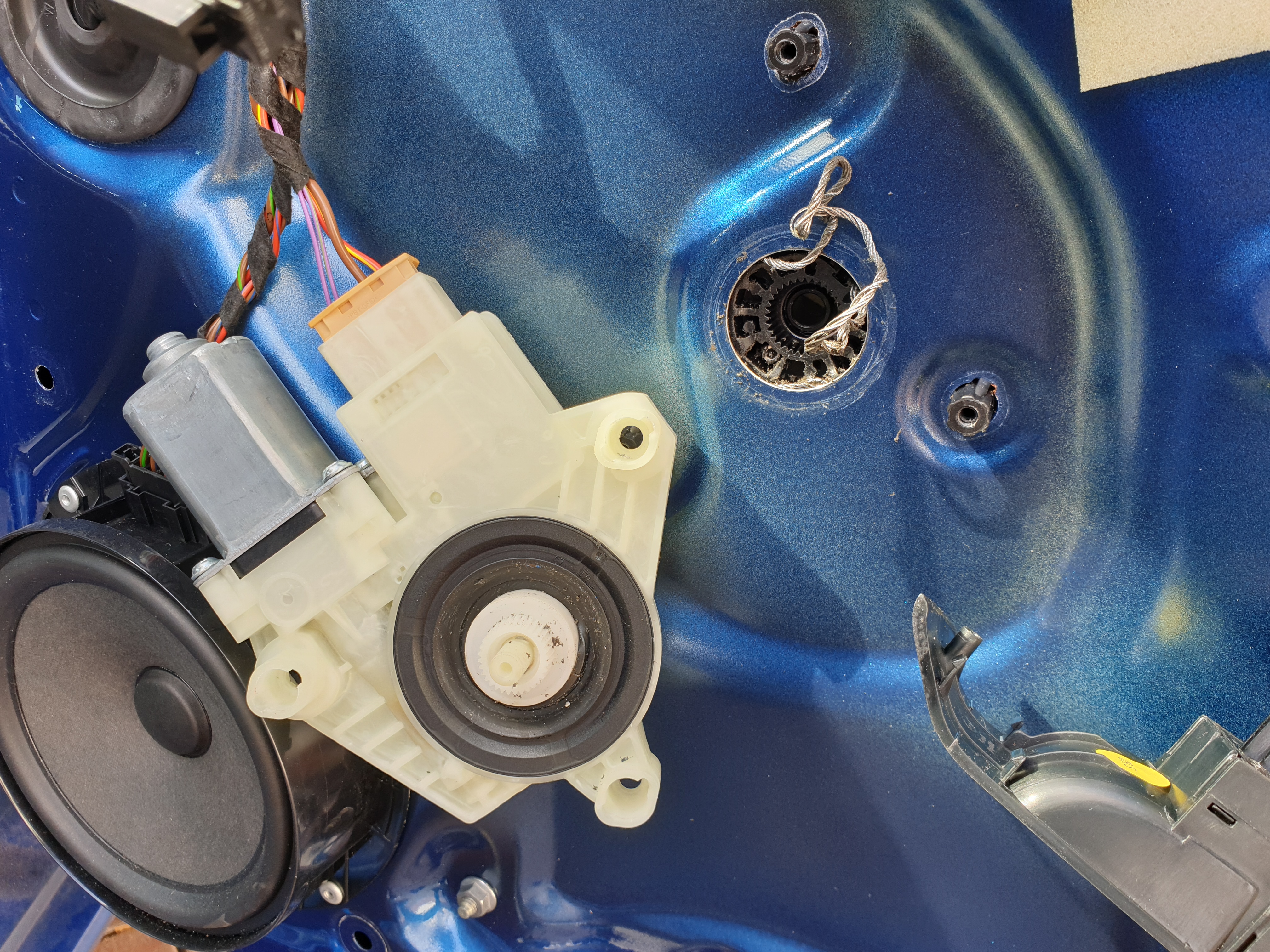

I managed to get the door card off without breaking anything and found this snarled up winding mechanism - see pictures.
The motor seems fine so I need to replace the mechanical bits and I've no real idea of what's involved . :(
