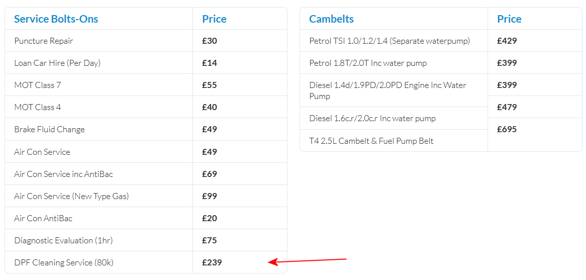

This from the local VAG independent I use
@Urrell thanks.
I wonder exactly what this entails, whether it's an off the car 'proper' clean or one of the two-stage JLM type procedures?
